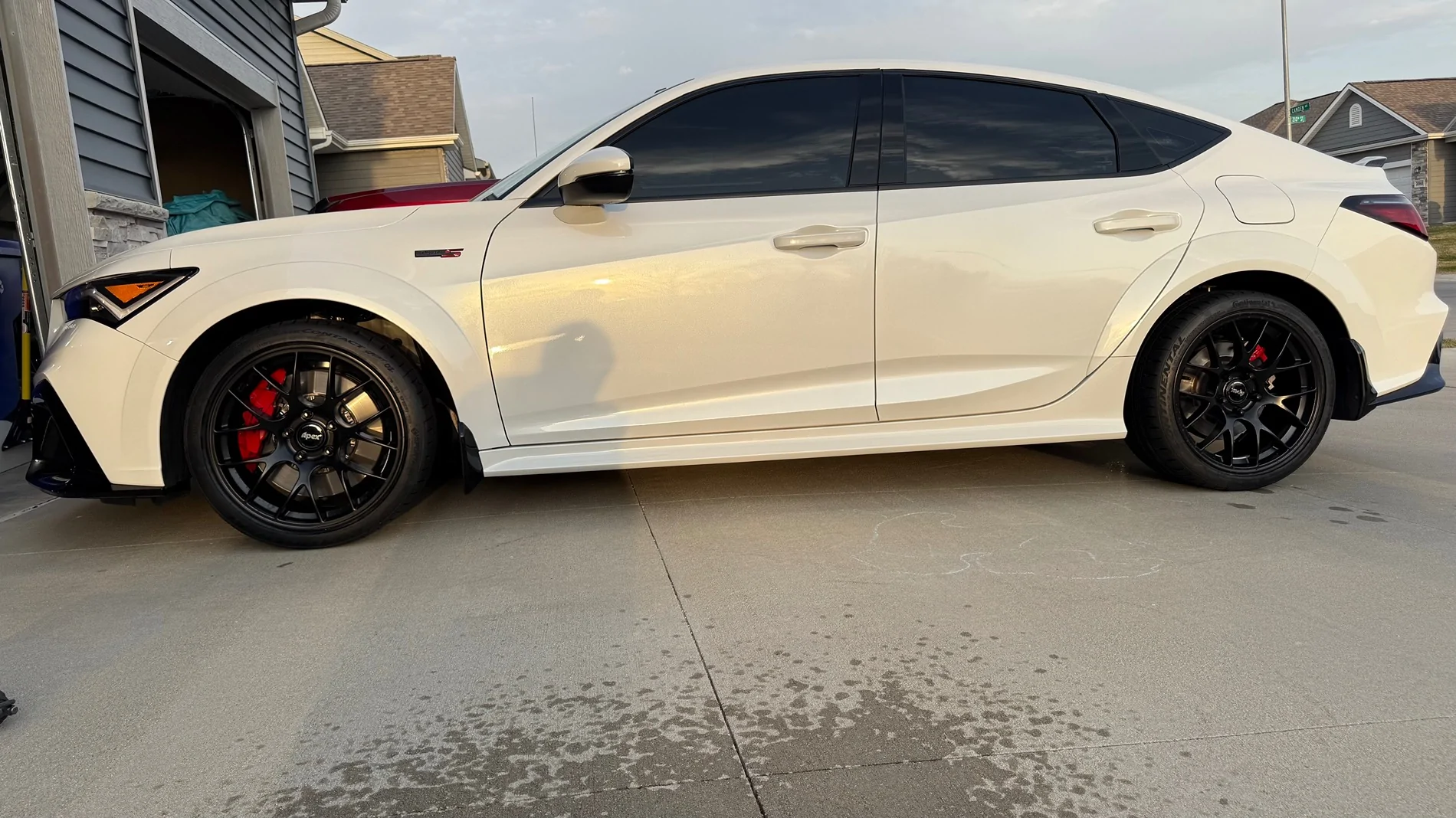

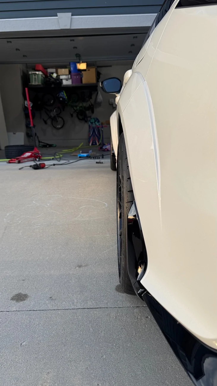

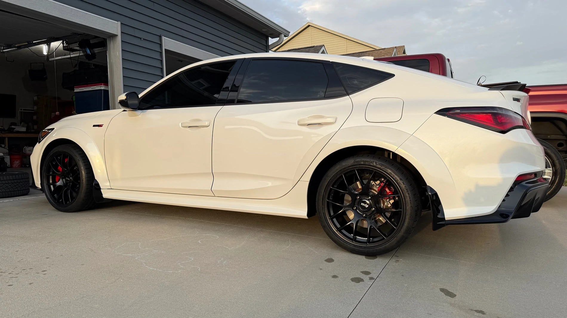

Car is stock except for:
apex 18x9.5+43 wheels
Hawk DTC-60 brake pads in the front
Tires are 285/30/18
Continental extreme contact 02’s
Not the original size I would’ve run. But I got 8 of them brand new for 200 a piece so I tried them. No complaints
Pins pulled and the struts pushed in but never got around to getting an actual alignment. The shop I tried to go to would only set it up to whatever the specs were on the computer so I’ll have to find a real alignment shop before the next event.

Only pictures I have is when I swapped the wheels at home sorry for dropping the ball there.
