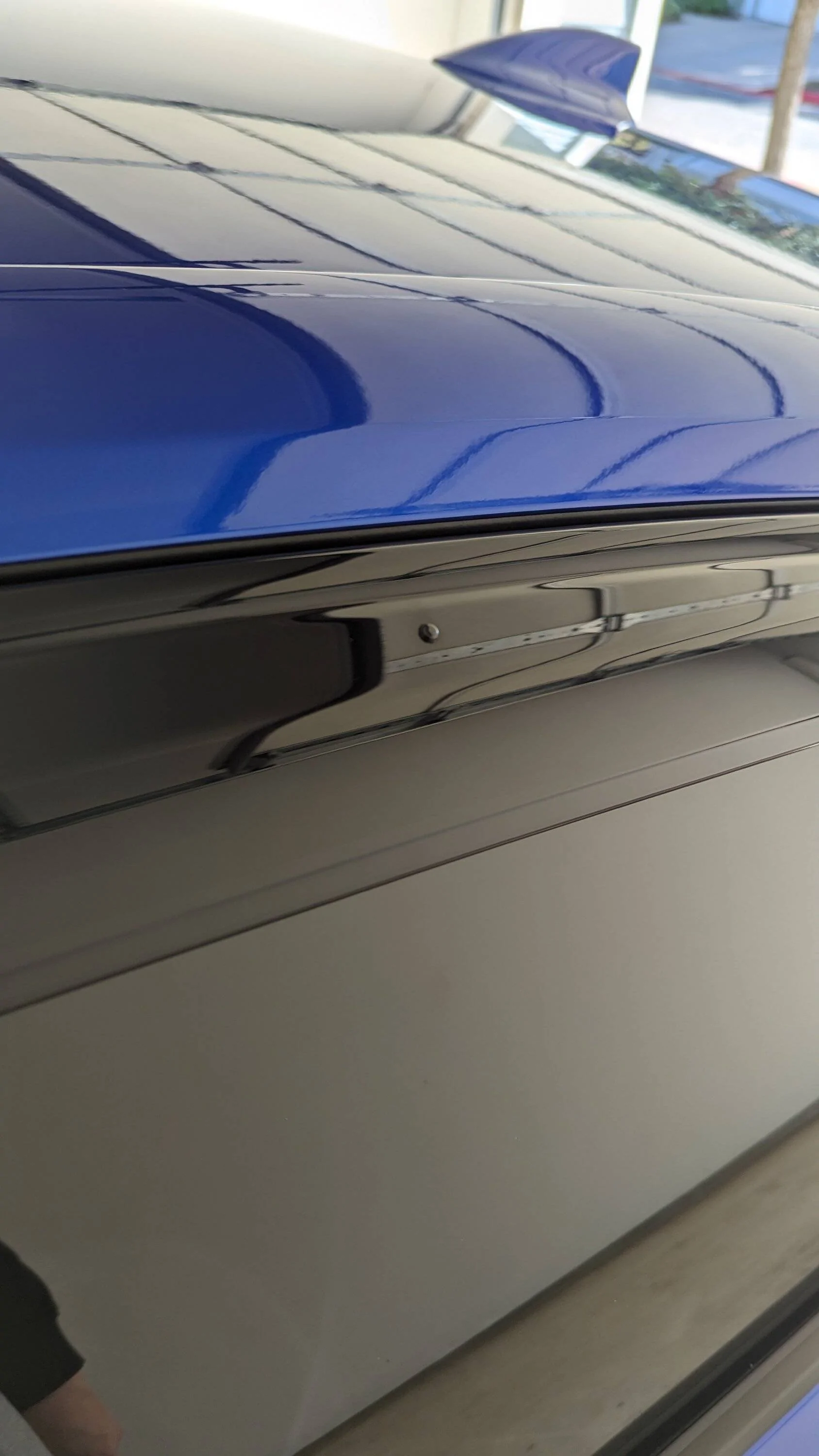

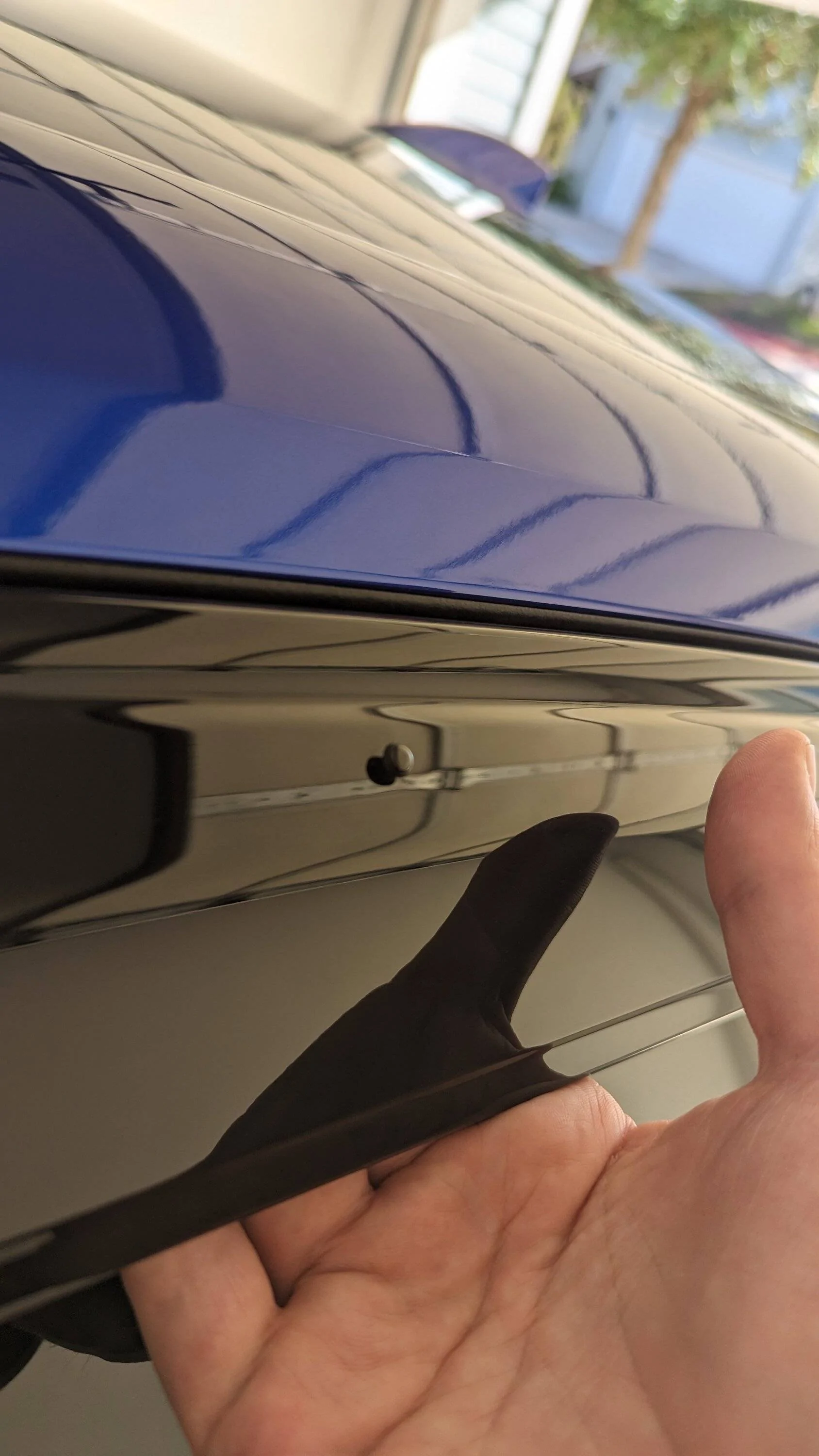

Just picked up my 2024 ITS with some dealer accessories and I'm confused about these door visors. They have a few bumps / screws that aren't secure (if I reach inside the visor I can push them out).
I don't understand the purpose of this if anyone can explain? Posting some pics here as well.

They’re secured to a bracket that’s shoved in between the weather sealing. So it’s 3m tape + those little push pins. So if the tape fails they just don’t go flying off they’re still secured by the bracket. They aren’t screwed in or anything they’re push pins. You just push the pin into the bracket and the lock tabs on the pin secure it. If you push it outwards and the pin pops off completely then you need a new push pin (aka take it to the dealer if they installed it, part of the warranty). Otherwise some play on the pin is fine as long as it doesn’t come off/out completely.

I guess I'm still confused because on the inside of the visor they aren't secured to anything, they are just floating.

Push pins should be pushed into the brackets (like in the picture), they’re thin and like less than an inch wide. If there’s no bracket installed than the dealer never used it, in which case I would take it back and have it done correctly

Now I’m curious, at your dealer during purchase was the accessories an option or was it “optional” (where they force it on you). My only logical explanation I can think of to not include the bracket in case the purchaser declines the accessories and can be removed easily. Those push pins are kind of a pain in the ass to remove, 3m tape although messy. Can be removed without harm

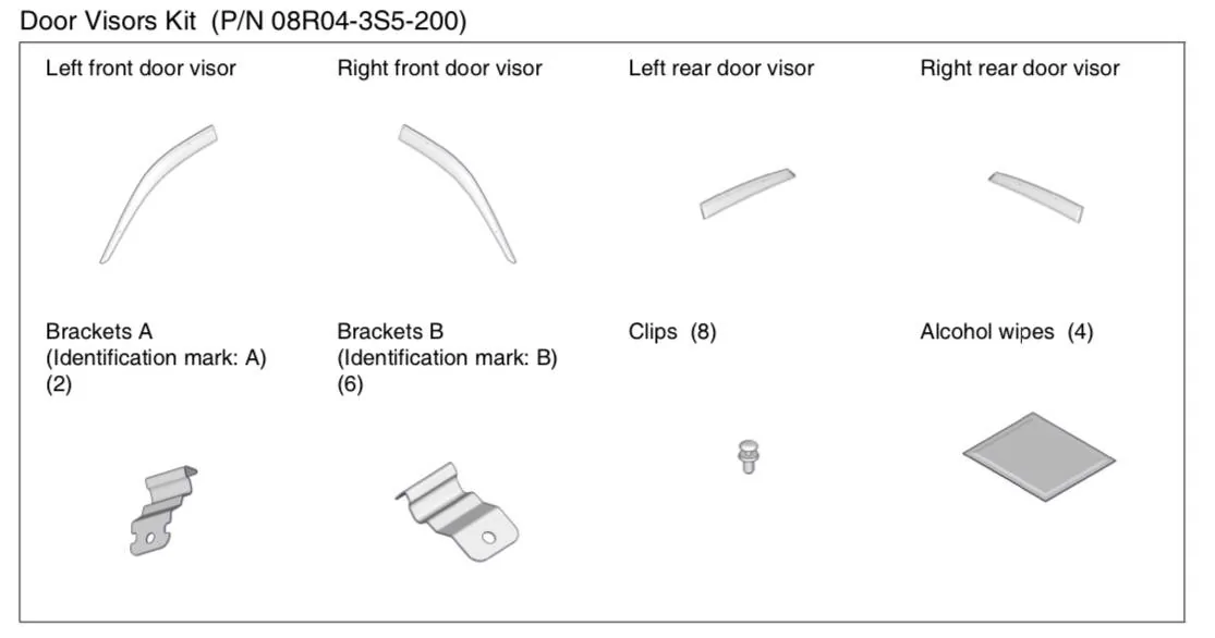

Ah so they are the clips (8). They are just floating.. I requested this accessory it wasn't something they included with the car actually. But how they are kinda loose and floating just doesn't seem right. I'll have to bring it back at some point and see what's up.
1,452
1,219
They should be connected to the brackets, which in turn go behind the rubber window trim. They shouldn't be too "floaty" unless they did not put the brackets in when installing.
