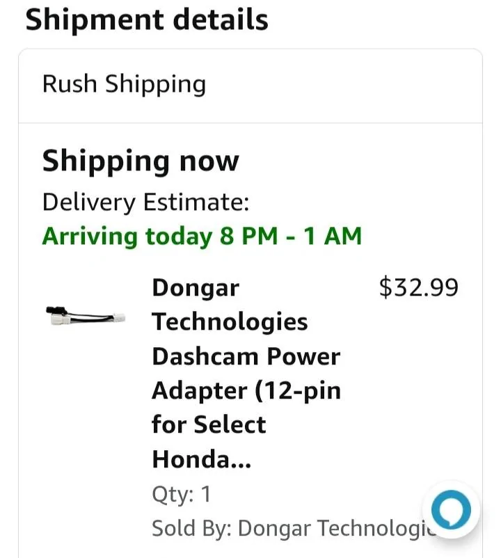

I'm setting a dash cam up soon and going to try and hook up to the autodimming mirror. There's a piece you can buy where you convert the plug from the auto dimming to a usb so you don't have to run a long wire

Hopefully by tomorrow or Monday I'll have a install video. Hopefully it's the right plug size

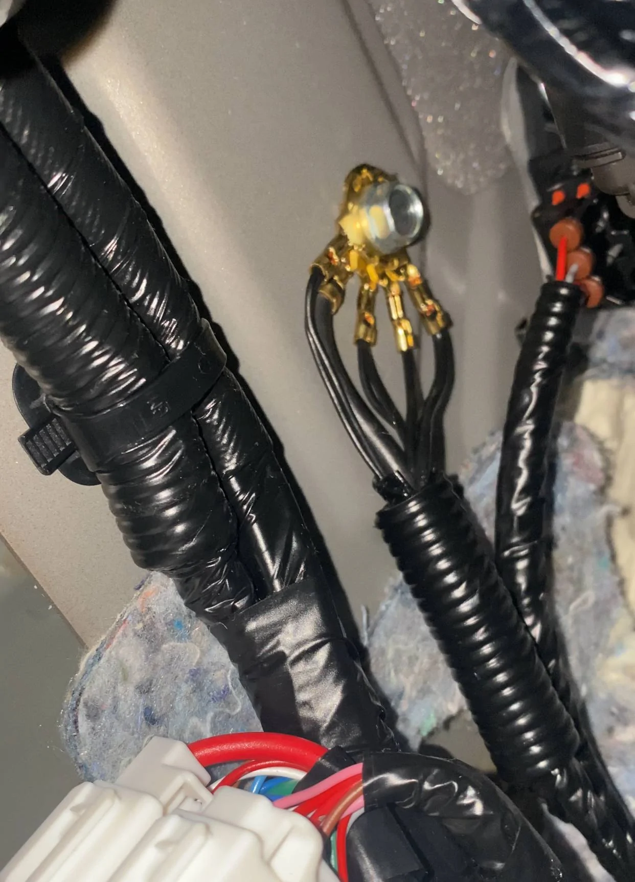

Ground would use whatever ground bolt is close to the panel

I just did this install yesterday, I used the heated seat fuse as a constant power and the ACC fuse as the accessories fuse. I used a low profile mini fuse tap as the integra comes with low profile mini fuses. The ground bolt is located slightly to the left and up behind the fuse box. I loosened it with a wrench and slid in my viofo a129 hardwire kit ground and tightened it back down.
