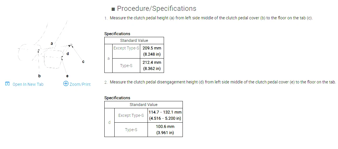

I’m going to try to take a look under the dash at the pedal and see if adjusting it is needed 👍 fluid will be due in 20k miles anyways so we shall see after the one and if not, then the other 🤞
I've adjusted that pedal more times than I care to count now.
My general advice is to do your adjustments (if any) after the car's been driven at operating temperature for a few minutes, as I've found that the heat causes enough expansion to take up a decent amount of the slack in the clutch pedal, so if you remove all (or most) of the slack from a cold pedal, once at operating temperature you'll end up with a clutch that slips even when you're fully off the pedal.
It sounds obvious but I initially underestimated the difference it makes.
That’s good to know! Didn’t think of that myself. 💪
