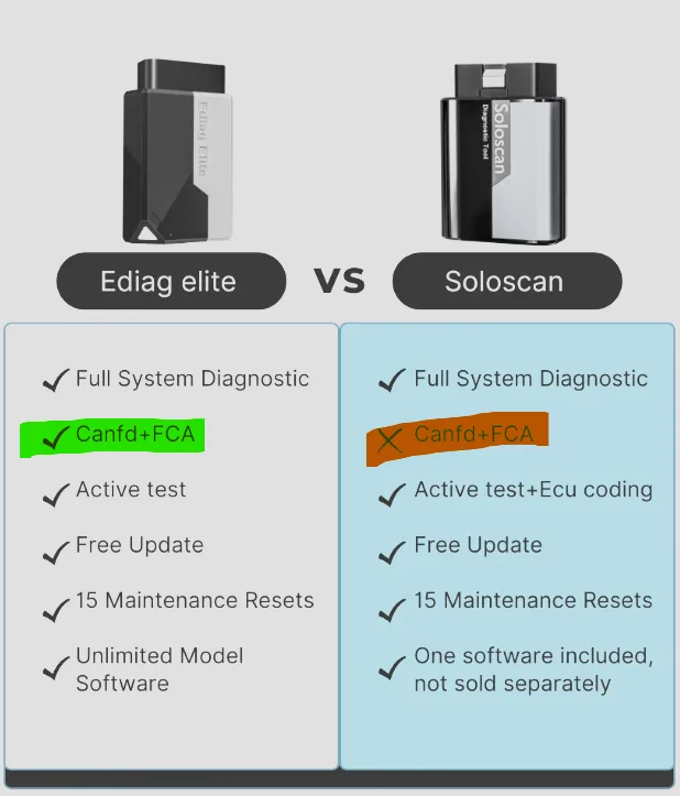

I think this is the issue, the Soloscan lacks CANfd and Forward Collision Avoidance (FCA) support.
Acura Integra Cannot clear parking assist and brake assist warnings! 1789140172192-3d
That said, I have a TOPDON RLink J2534 and it works with iHDS to clear these codes.

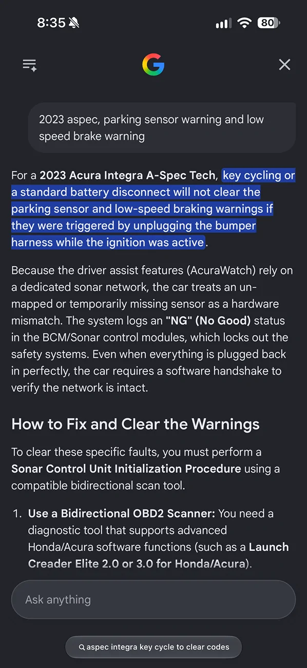

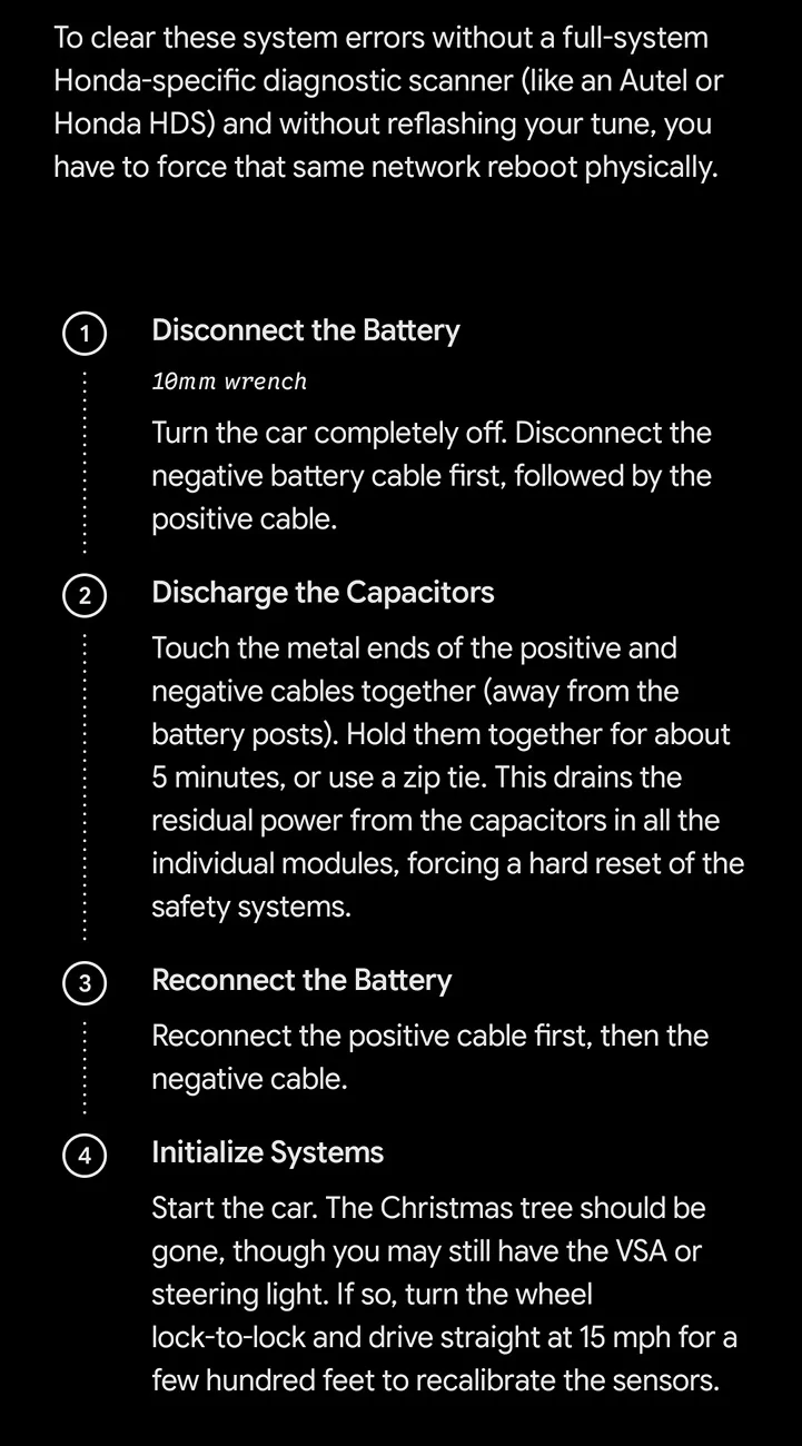

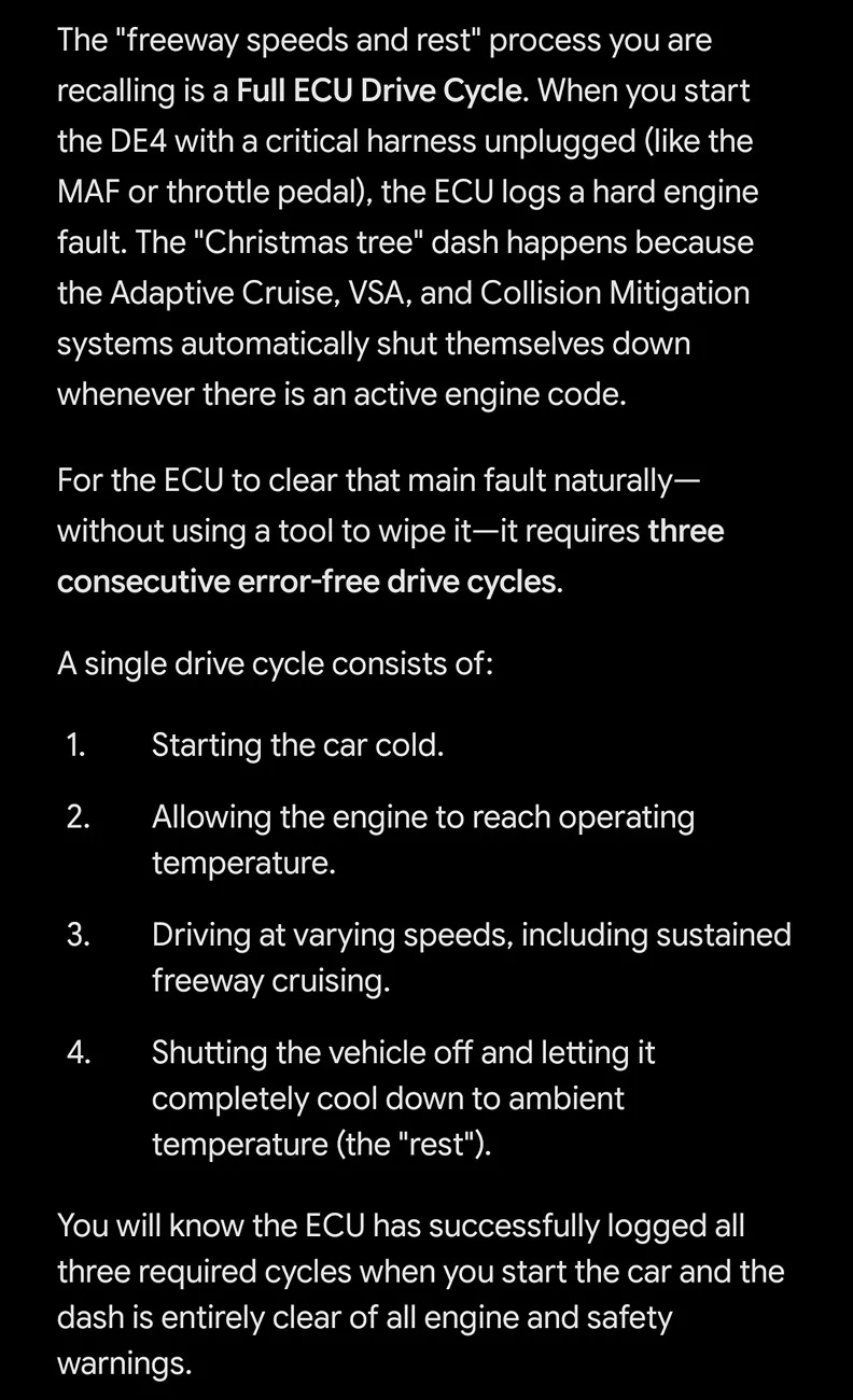

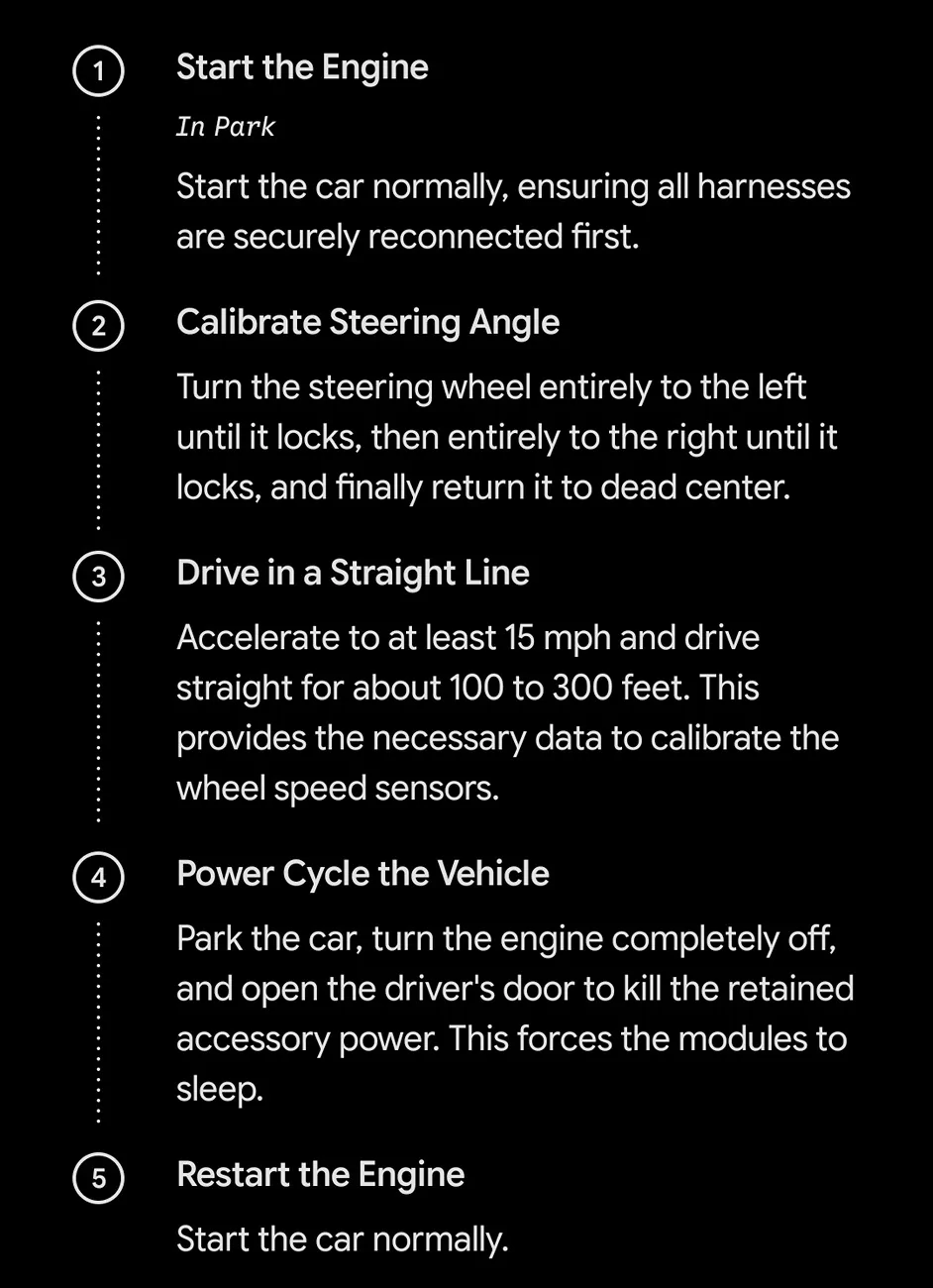

But if its the Christmas tree dash from a harness not being plugged, full ECU drive cycle should clear it. Threw my experiences + your issue in AI:
This is the Full ECU drive cycle
Acura Integra Cannot clear parking assist and brake assist warnings! Screenshot_20260912_084129_Googl
This is the capacitor discharge process
Acura Integra Cannot clear parking assist and brake assist warnings! Screenshot_20260912_084443_Googl
This one has never done anything for me
Acura Integra Cannot clear parking assist and brake assist warnings! Screenshot_20260912_084107_Googl

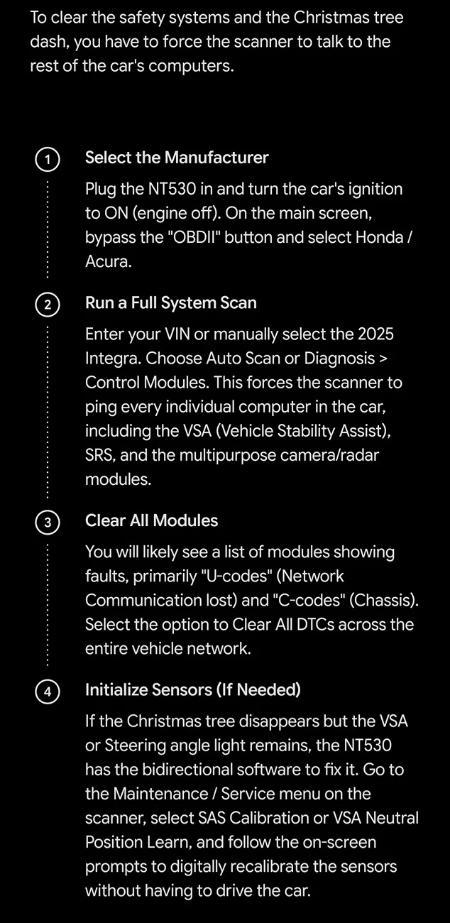

Would love to hear how you did it once you get it to clear! This is the scanner I have for engine codes, but i've never gotten it to clear the dash/systems errors (or I just don't know how to use it for that). https://a.co/d/047yC6eq
Here's how it says it should be used for that:
Acura Integra Cannot clear parking assist and brake assist warnings! Screenshot_20260912_085327_Googl
