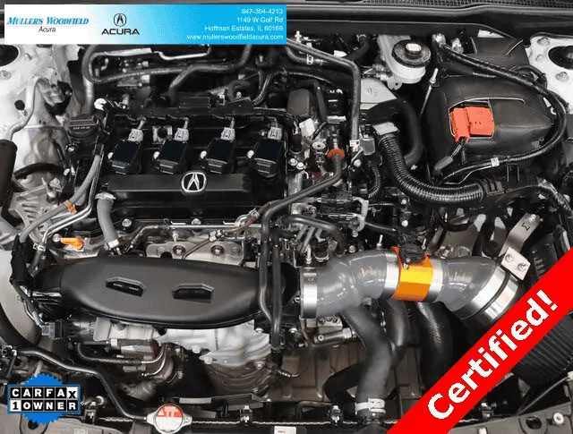

Hello, I am going to look at this Integra next week. I see an intake installed. I was wondering what brand it is and if anyone sees and other boltons or mods done in the engine bay. Thank you!

By the maf housing, it looks like a 27Won unit. Not seeing much of anything else that isn’t oem

Downpipe looks stock, everything but the intake / MAF looks stock as far as I can tell.
I'd start by asking for a discount for non-stock intake system and the additional risk involved with "a clear indication of use of aftermarket parts" . Then I'd ask the dealership to run ECU diagnostics to see if it was tuned at some point. If it was and you're ok with that, then maybe you can negotiate an additional discount. If not, walk away.
