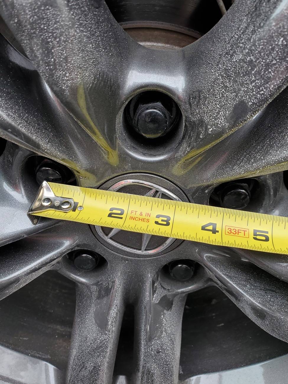

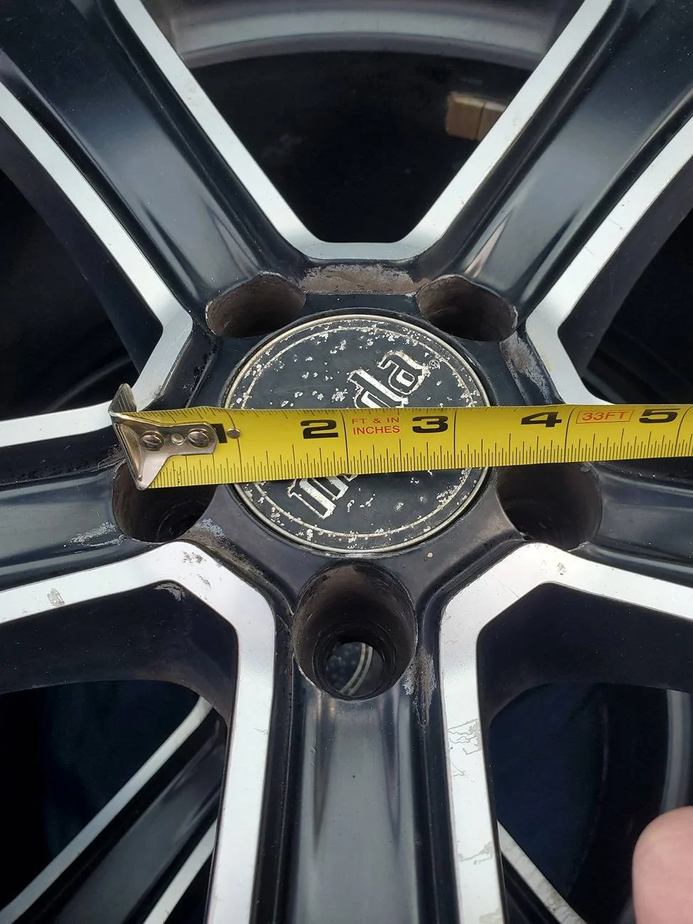

Then how would one explain this:
The top pic came off a wrx with a 114.3 pattern(doesn't fit the Acura)
The bottom pic came off a Honda with a 114.3 pattern(fits the Acura)
I have confirmed this with the tire shop who was just as perplexed.
Look at the pics and convert to mm.
Acura Integra Bolt pattern for A-spec is 120mm not 114mm? 20250211_113615
Acura Integra Bolt pattern for A-spec is 120mm not 114mm? 20250211_113643

The answer, it's NOT 114.3, it's 100, the only other OE Subaru size. Your own measurement is verification.

center to center is 4 inches in the subaru wheel, 4.25 inches on the acura wheel. That's what I see anyway...
Five-bolt patterns aren't measured exactly CTC, but that's different oddity. The 100mm spacing converts to 3.94", so your 4 inch estimate is right on.

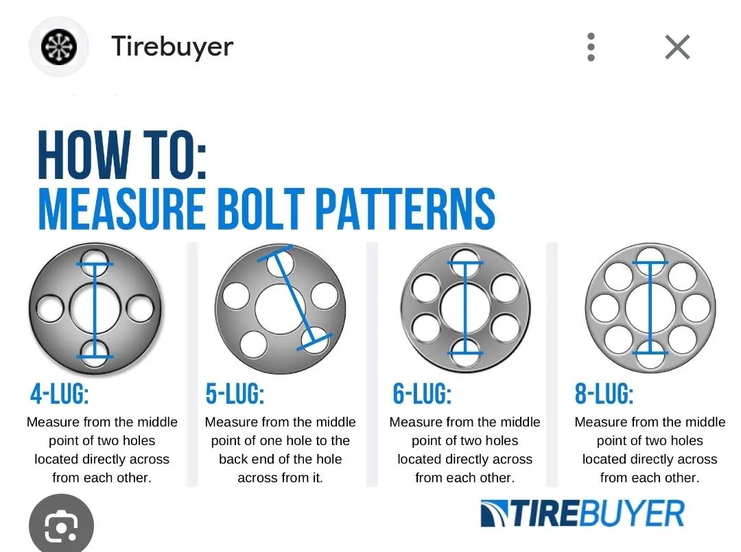

100mm is If you measure center to center, which is the incorrect way to measure 5 bolt pattern wheels(center to outside edge of opposite hole is proper way. See pic)
This dark wheel off the Subaru measures 114mm when measured correctly (see pic)
This silver wheel(fits integra) measures 120mm when measured properly (center to outside). It seems like Subaru uses the center to outside edge method where Acura uses the center to center method.

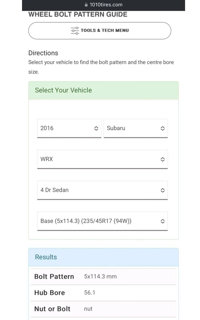

Check this out.
Look at the bolt pattern for the 2016 wrx it came off of from. See how it says 114.3?
That's center to outside.
Now look @ the center to outside measurement of the integra measured centered to outside..... 4 3/4" = 120mm

The easy way to define it:
4x100 bolt pattern = 4 bolts with a 100mm DIAMETER bolt CIRCLE.
5x114.3 bolt pattern = 5 bolts with a 114.3mm DIAMETER bolt CIRCLE.
5x120 bolt pattern = 5 bolts with a 120mm DIAMETER bolt CIRCLE.
Take a piece of paper, draw a circle with a 114.3mm diameter circle on it. Cut it out, and place it over the back mounting face of your wheel. The circumference of the circle should match up with the centers of each bolt hole if it is a 114.3mm bolt circle. If it doesn’t, it’s not a 114.3mm bolt circle.
