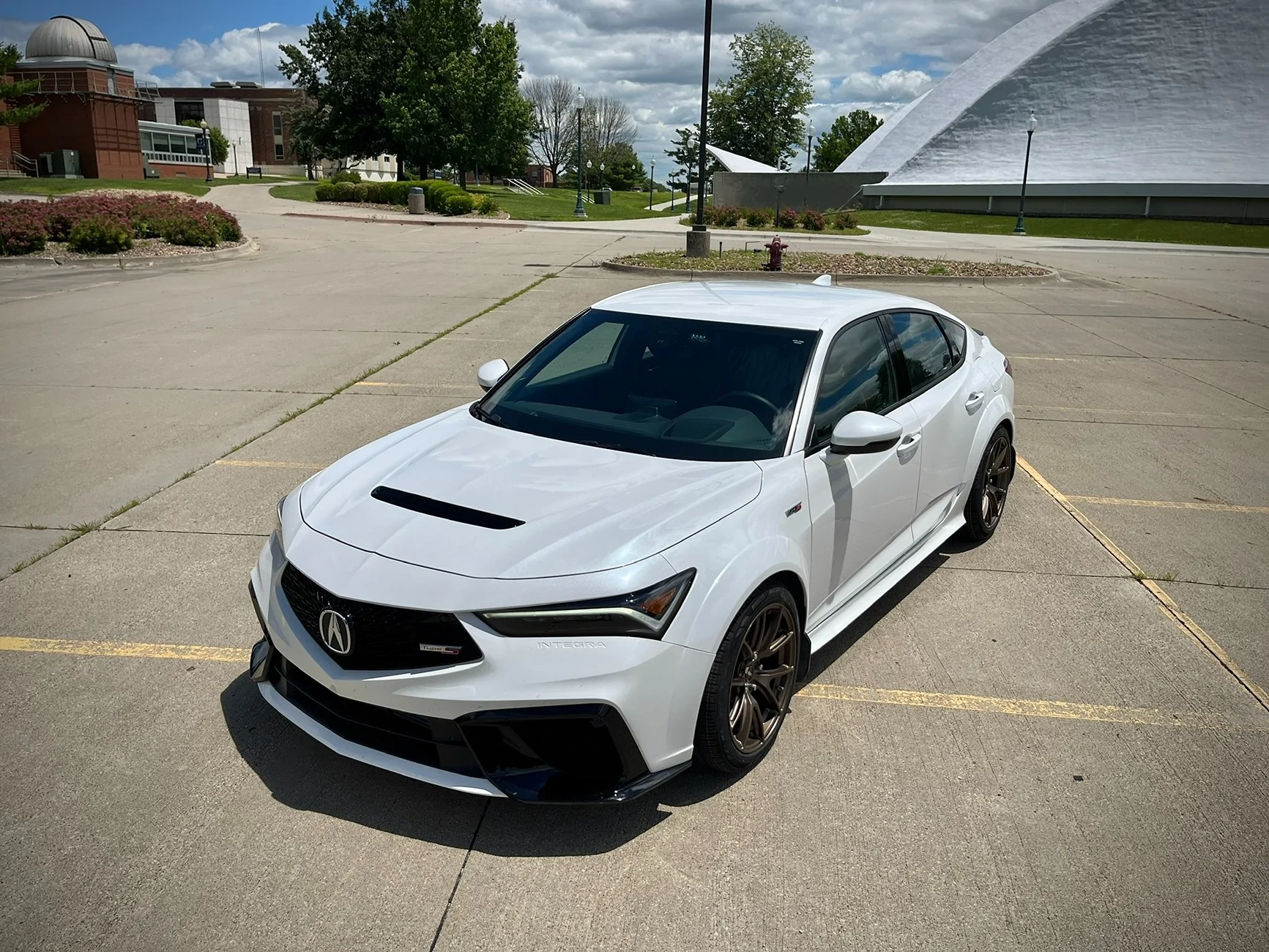

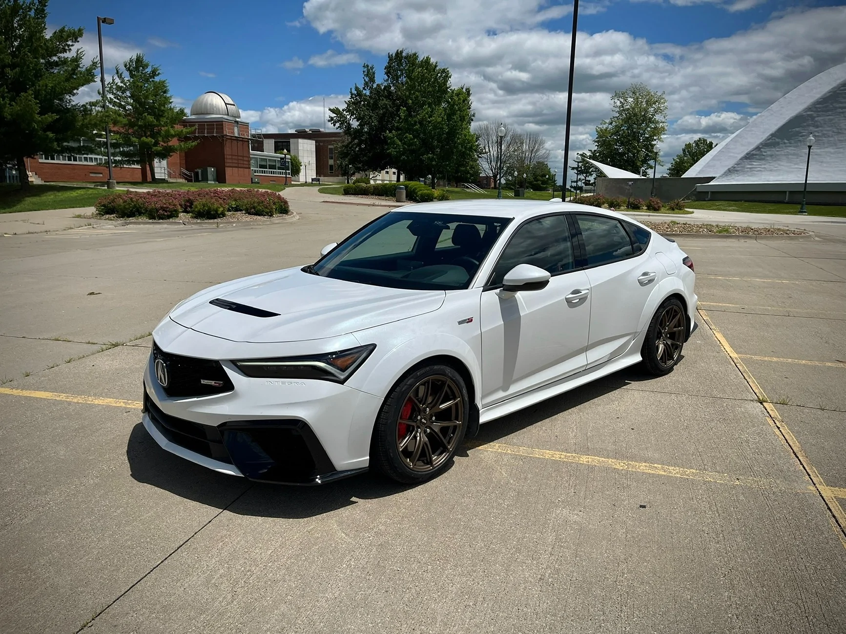

Answers to inevitable questions:
  • Apex offers the 18x9.5 in +58 and +38, why +45?

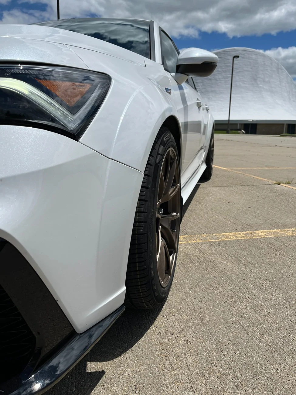

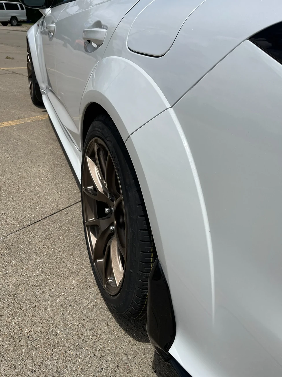

    • I originally wanted to do +58 to maintain the OEM offset. However, after running a +44 setup all winter long and not really getting any torque steer, I decided +45 was the sweet spot. I am too old to think +38 looks cool on these cars. +45 on a 9.5" looks like just about the most aggressive setup an OEM not named Ford might do, and I'm all about OEM+.
  • Why 255/40R18 instead of 265/35R18? Doesn't 265/35R18 match the OEM setup for a 9.5" wide wheel?
    • 255/40R18 has a lot of good tires to choose from, it's cheaper, and gives you a smidge more sidewall if you care about that sort of thing.
    • I also happen to think a mild stretch looks good on this type of car. Pictures I saw of 265 always looked a bit more square shouldered, and 275 on a 9.5" wheel just looks too offroader-ish to me. 255 kind of helps hide the gap and looks more natural to my eye.
    • I'm not as hung up on bigger number = better as I used to be. There are tradeoffs in everything.
  • Isn't your speedometer way off?
    • Actually, no! With the front tire pressure set to 33psi cold, and setting the cruise at 75, GPS will read 76 about 80% of the time and 75 the other 20%. I think the speedometer in these cars reads a little bit fast, so the taller tire size takes some of that error out (and adds some the other direction.)
  • Are those.... all seasons? 🤢
    • Yeah. I actually have a dedicated set of winter tires, too. These Pirelli P Zero AS Plus 3's are much more of a three-season tire however, and would be awful in snow. They're pretty grippy all things considered, but they won't be dangerous to drive on in temperatures under 45 degrees, which will give me more time to decide when to swap my winter set off and back on in spring and fall. They'll also be significantly safer in the rain than a summer tire would be. My initial impression of them is quite favorable.
  • Are you lowered?
    • Nope, don't plan to.
  • What lug nuts are those?
    • McGard spline drive with the integrated washer.
