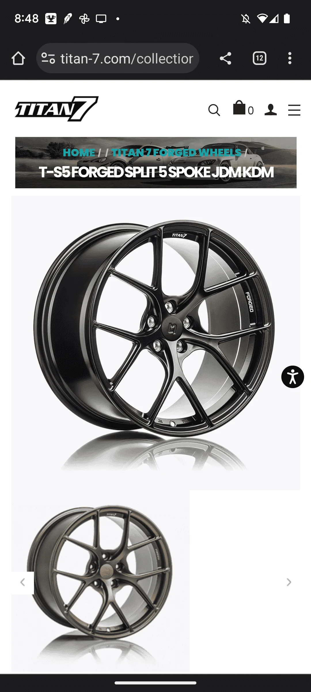

So I haven't seen anyone except one type s on IG that has after market wheels . Anyone have pics /set up ? When my tires go bald is when I'm going to buy new rims . I want to fill the wide body and thinking 19.5 with .5 drop so it can be barely on top and a concave style or similar to our factory wheel I seen these and have good history with stance as they are light weight wheels thoughts ? I also seen these on IG . My car is LSM for reference

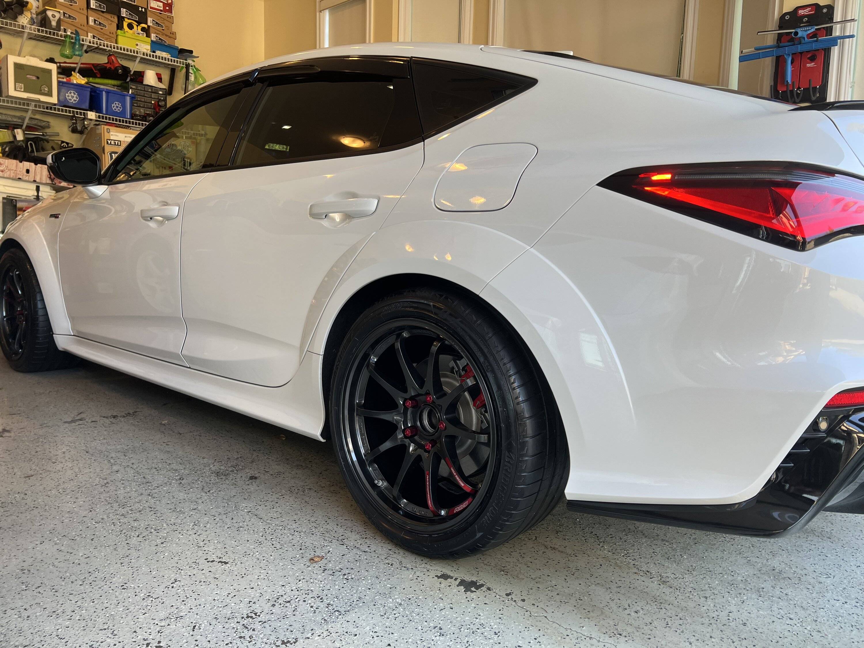

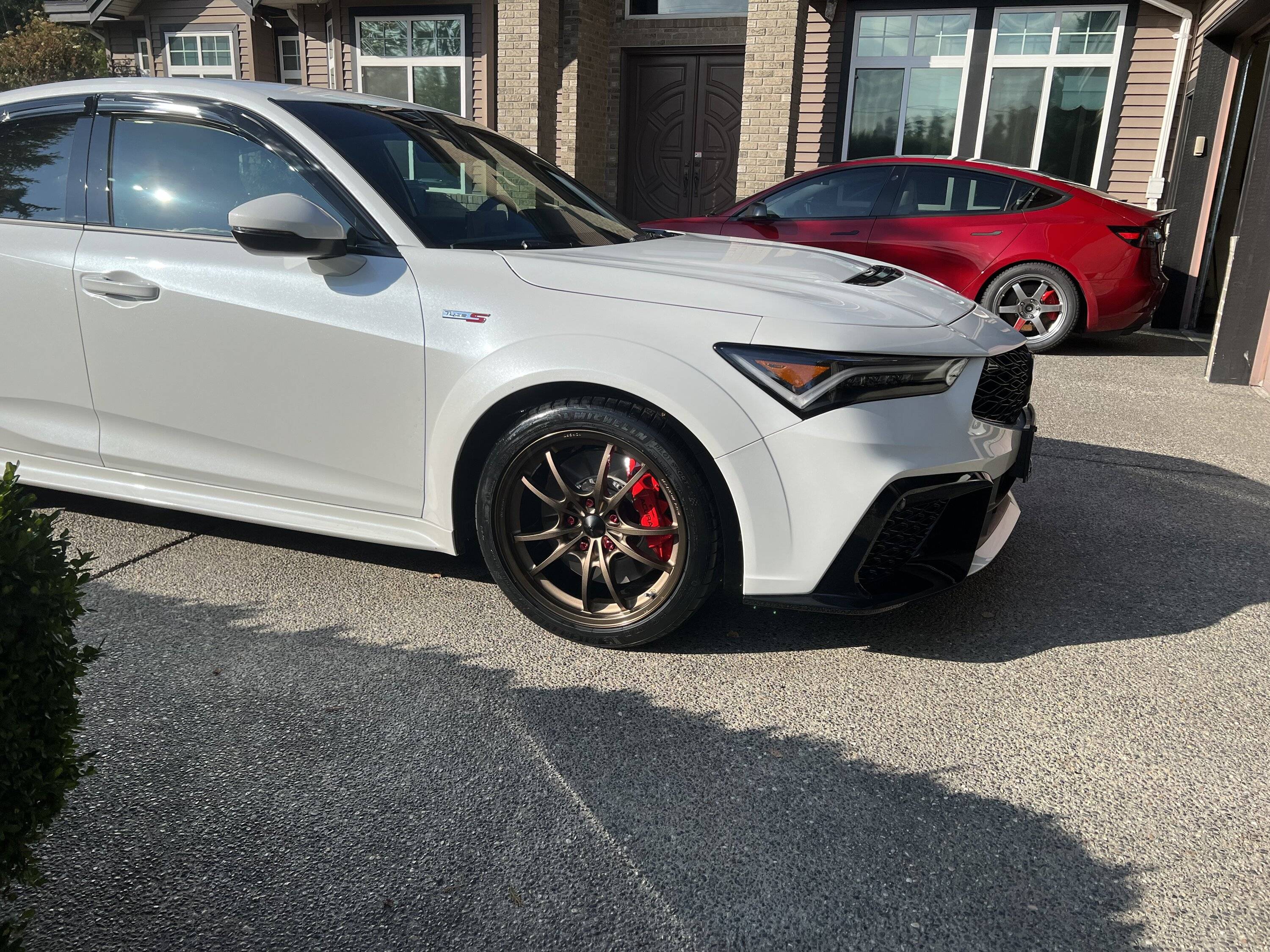

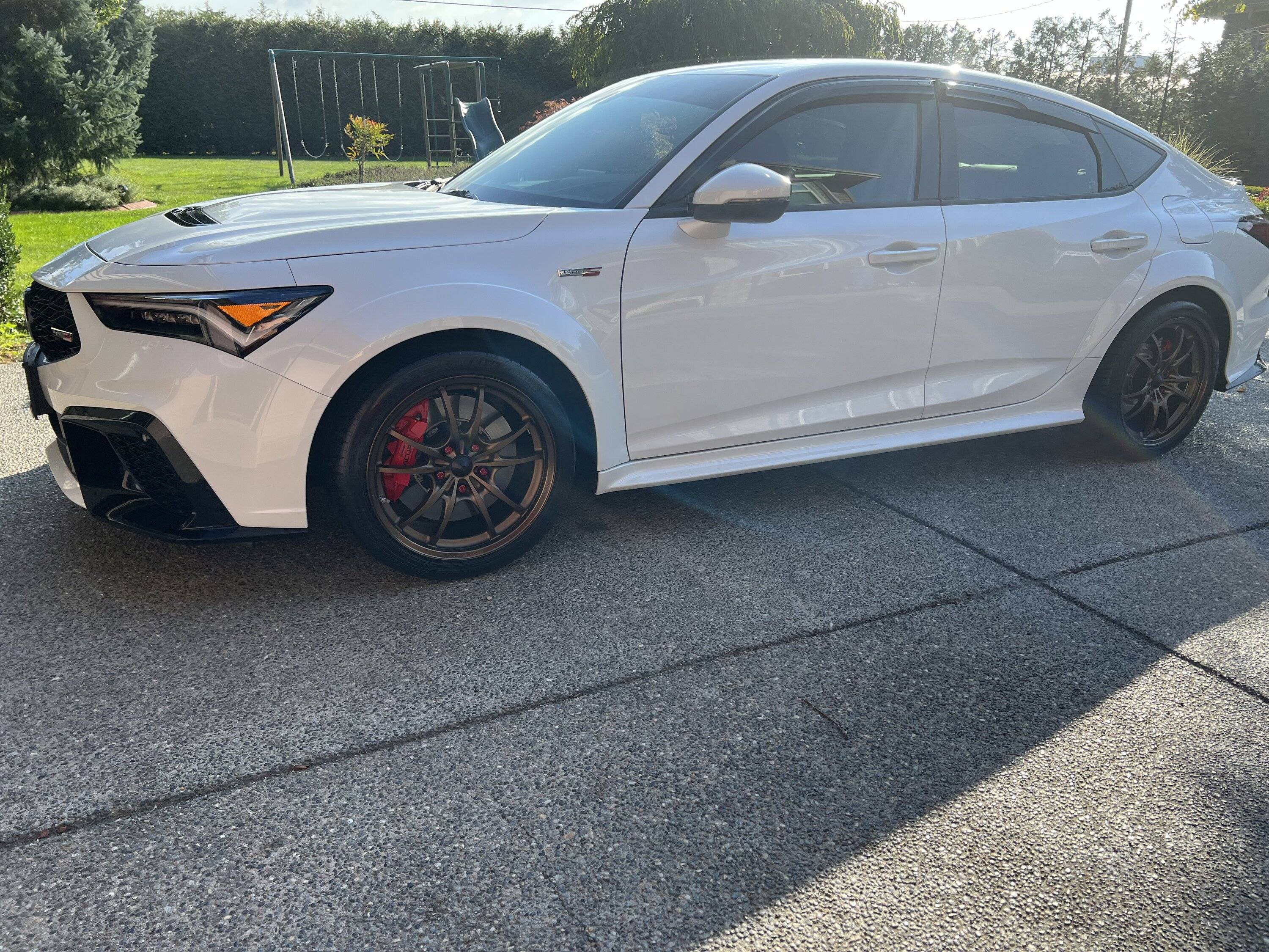

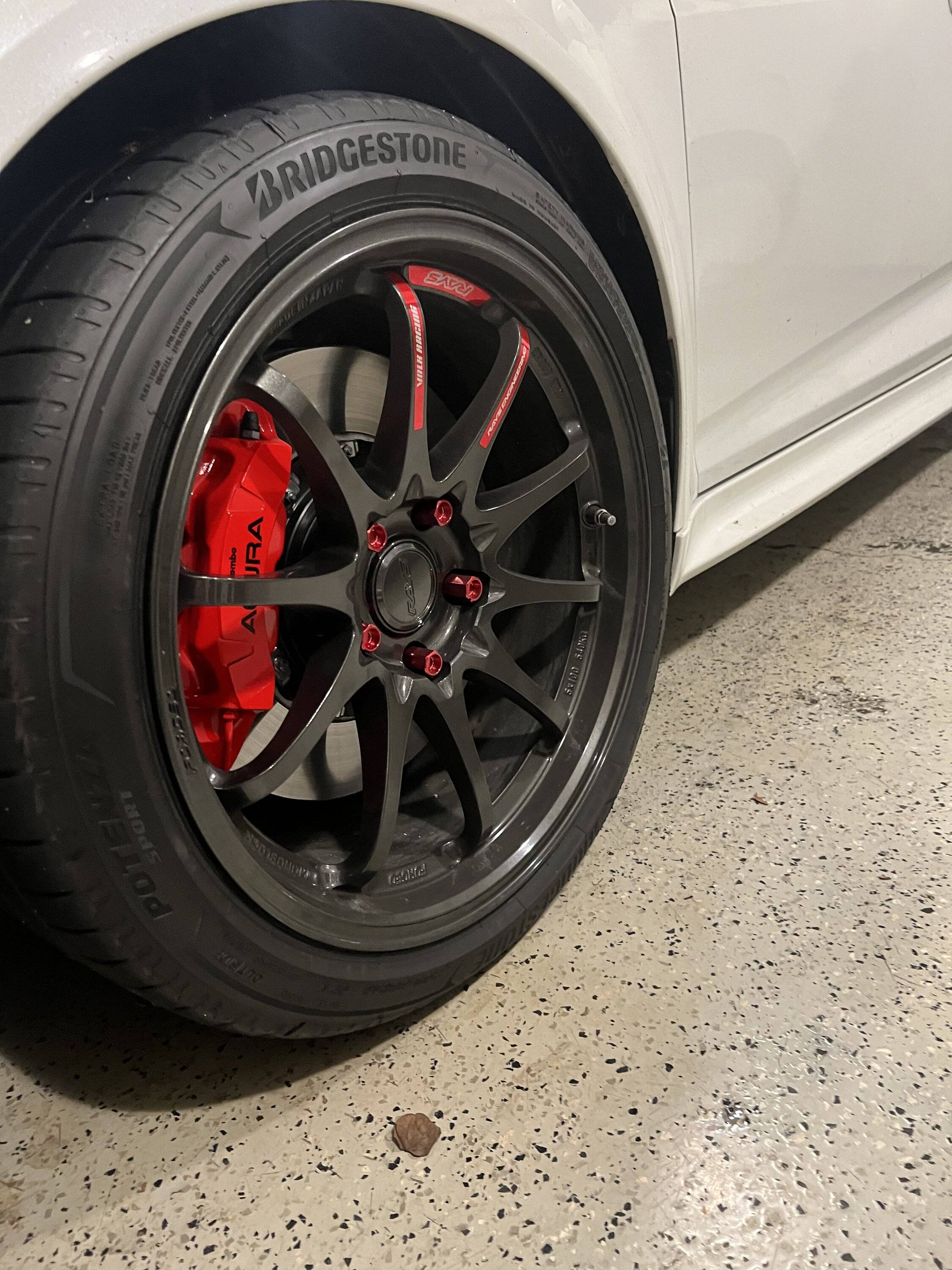

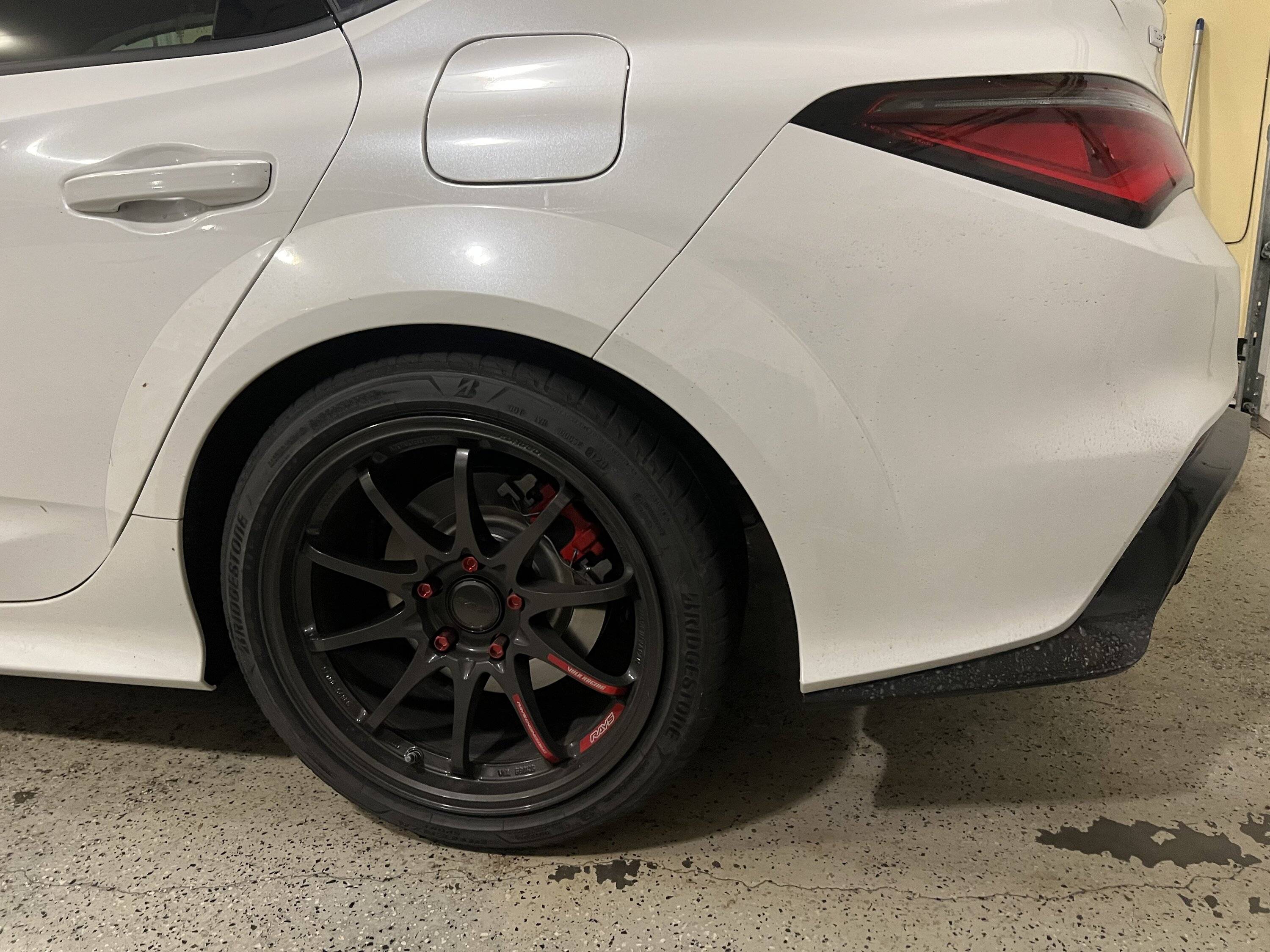

I’ve run a few different setups on my car sharing some wheels I have from my FK8.
Here are some pics of 18x9.5 et+45 Mugen MF10’s and 18x10 +40 CE28 CR2 Black Editions. I like the CE28’s much better with deeper lip. I’ll need to swap over to my wet weather/winter setup of 57DR Gramlights next week with Michelin Cross Climate 2’s. Temps are getting low over night and not a good idea to be running Bridgestone Potenza Sports I’m currently on.
If you like the stock look of the DE5 wheels or Y spoke wheels, look into the NSX or Titan 7’s. They will be forged and lighter than the Stance rims but will cost more.

I'll look into those wheels tyWhich do you like better the 9.5 or 10 ? Which has a nicer flush with the fenders ? And nice setup up btw ?

I just checked the Titan 7 ngl they fire these are in the middle of what I posted and would look good ...keep em coming though guys the more options and pics the better

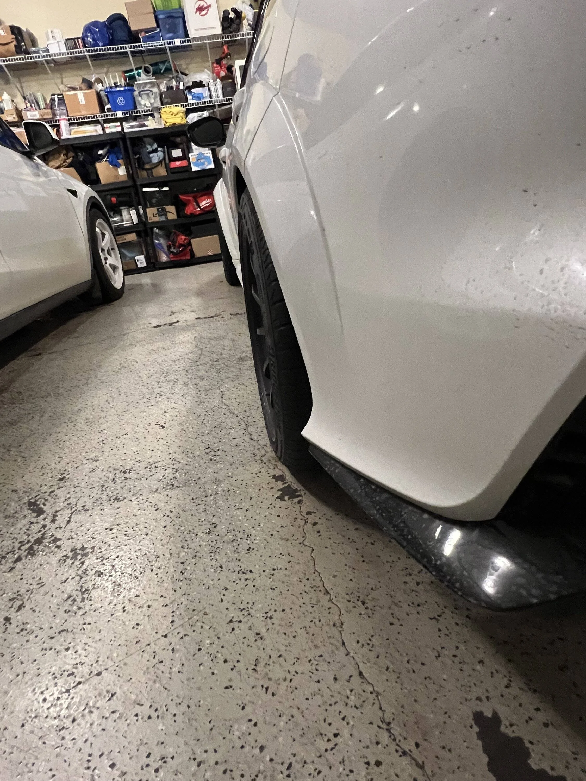

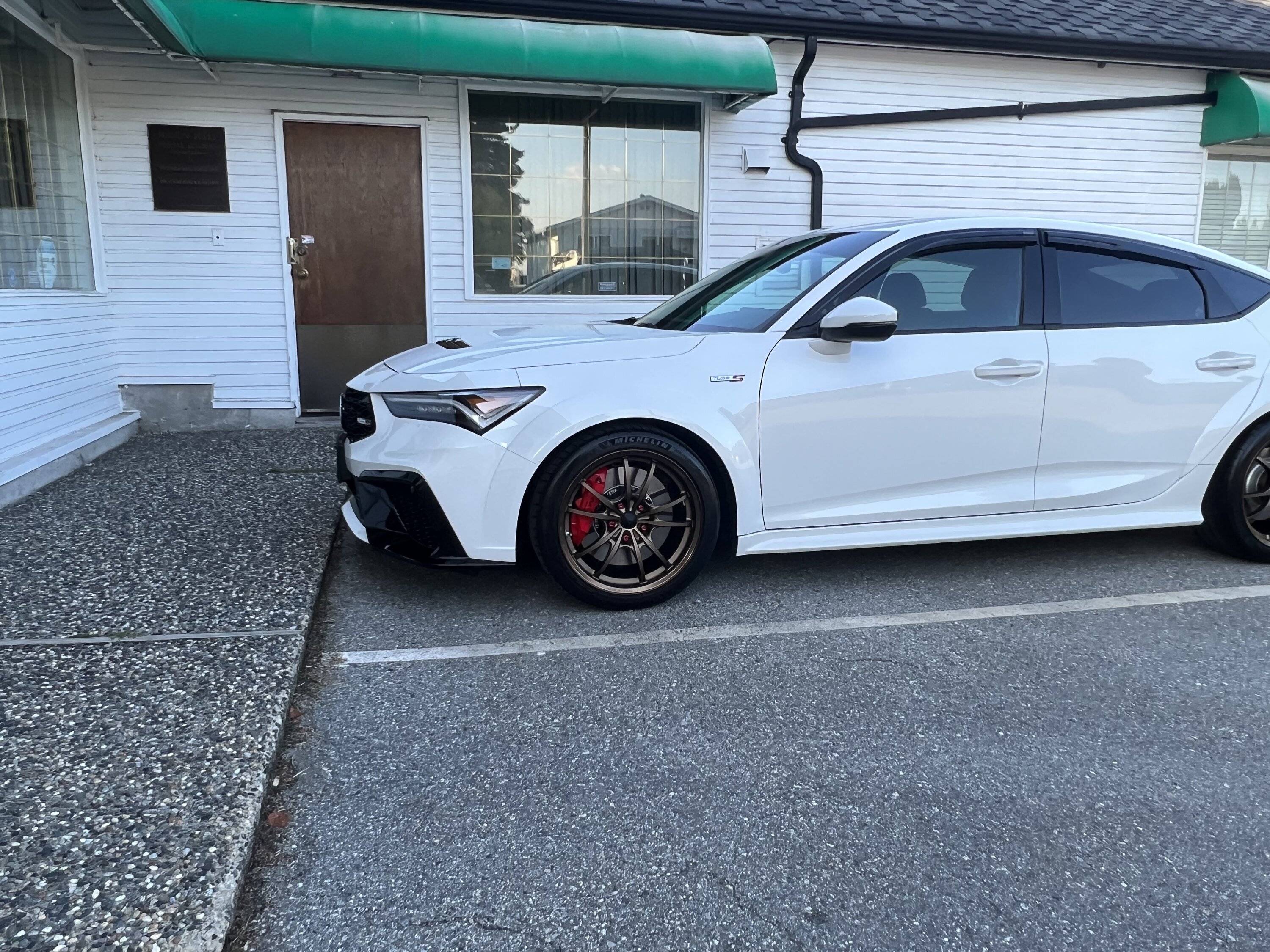

Well then I gotta go 19x10 for the flush look lol thanks

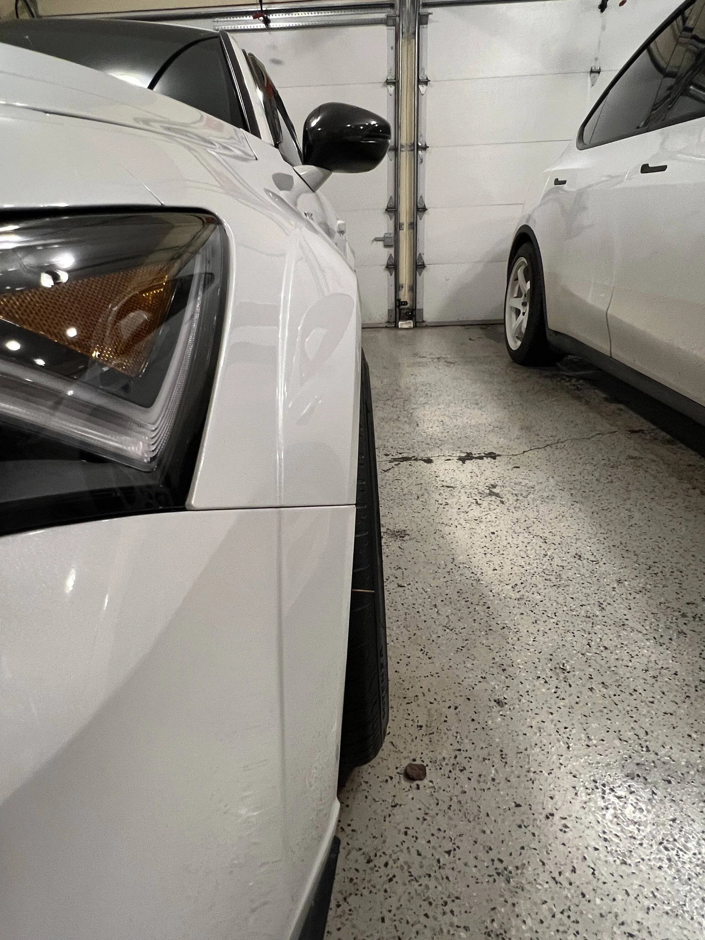

Depends on the offset to get to flush. My 18x10 et+40 have a bit of poke and is pretty aggressive, but I’m running 265 width tires so it is slightly stretched. If I went with 275 or 285 it would definitely poke out further without negative camber adjustments.
18x9.5 et+45 is flush and +38 slightly pokes past fenders.
I’ve posted a link to System Motorsports blog on FL5 fitment before and rule of thumb applies to the DE5 as well.

I appreciate this. .yeah slight poke is ok I wanna be able to look from the back and see juuuuust smitch. Just like in your pics

I’ll take some pics after work tonight to show how the 18x10 et+40 looks like from the front/back.
