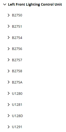

If you're completely SOL going that route then the first thing I would do is try and scan the car and see if it has any codes from any of the various control modules. (These don't always turn on the check engine light but make sure the scanner can can actually scan the whole car. Some of the cheaper scanners can only see engine related codes that usually start with P) If it does it might help narrow down what's causing the issue, cause believe it or not there's a control module in each headlight. Below are some of the codes you might be looking for.

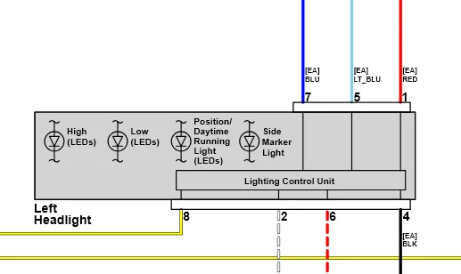

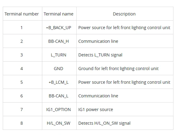

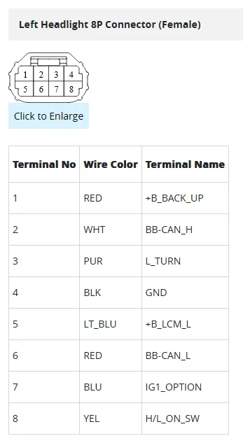

Here is some of the wiring info. Turn signal wiring is on a separate drawing for some reason but it's a single wire from the BCM.

As far as likelihood of a failure it's impossible to say for sure. I'm assuming it was front end damage of some sort so it opens up a whole new can of worms.
It's possible that some of the wiring got damaged from whatever caused them to rebuild it. It's also possible when they rebuilt it some of the wiring got pinched or was routed incorrectly causing it to rub on a sharp corner for example. It may have been fine initially but after a few miles of driving and vibration a wire broke. I'm not sure what lights would turn on or not if for example one of the communications lines is broken and it can't talk to the rest of the car.
You also got to take into account that the replacement they sourced likely came off a car that was totaled for one reason or another. It may be fine cosmetically but was there internal damage to the control module from a crash or water, did it get dropped during transport etc...
If you end up having a code and can't find any info on it dm me and I can try and give you more specifics on it.
Best of luck

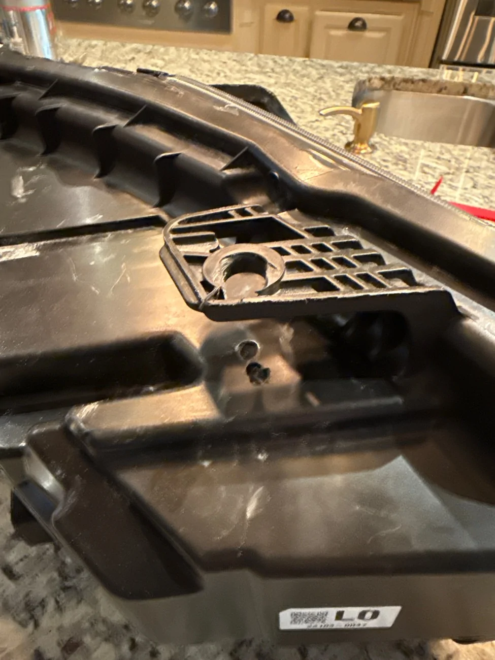

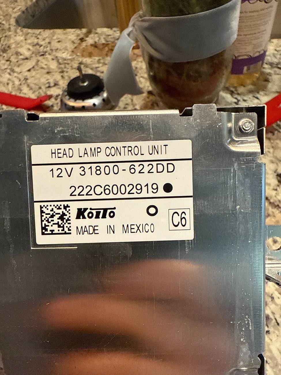

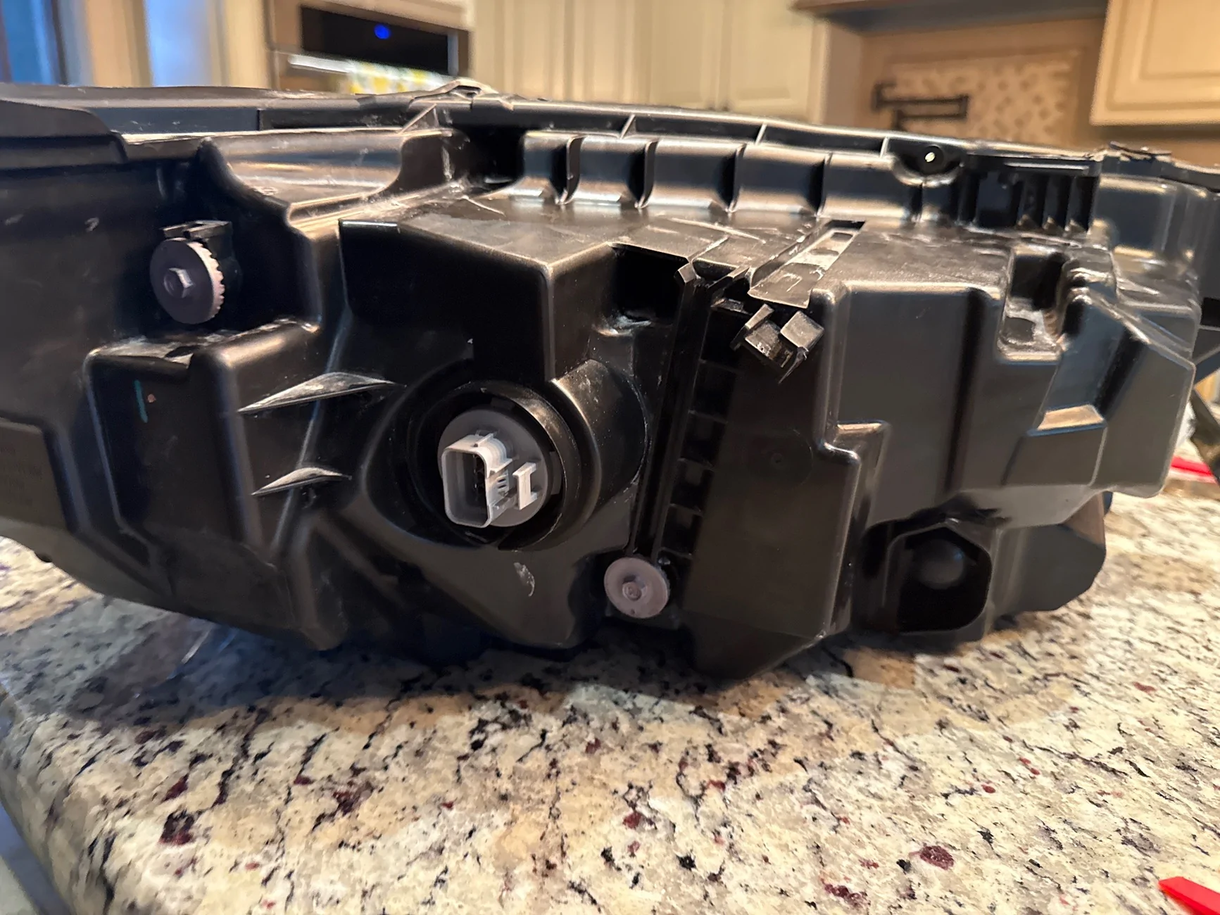

I wanted to circle back with you and let you know I found the source of the issue. The sellers installer drilled a hole in the alignment tab and went too deep drilling into the housing. This allowed water in shorting the LED driver.
Acura Integra Acura Integra 2024 Base Model Drivers Side Head Lamp IMG_944DAB50-715E-4E82-982A-366D12CE86A2
Acura Integra Acura Integra 2024 Base Model Drivers Side Head Lamp IMG_35F4E30E-1439-450F-AE70-85B01AB10FDD
Acura Integra Acura Integra 2024 Base Model Drivers Side Head Lamp IMG_C436D547-87B6-4CC5-99F4-4FEE814DEBAC

That's just pure and utter carelessness and ultimately a bit of laziness on the part of the installer. Could have put a thin piece of metal under there to protect it from the bit when drilling or after causing that damage used a some sort of waterproof sealant to prevent water from making its way into the headlight.
Were you able to get any resolve going back to the installer?
