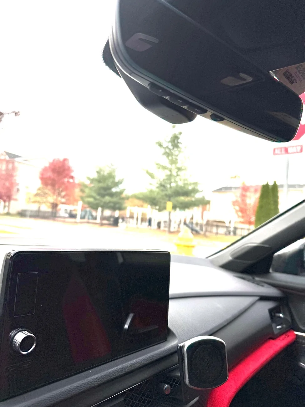

it's been working quite well for me, but i also ended up doing the accord franken-mirror today and will likely cancel the subscription if the mirror works well for the next few weeks without problems.
Acura Integra Accord Homelink Mirror IMG_3206
