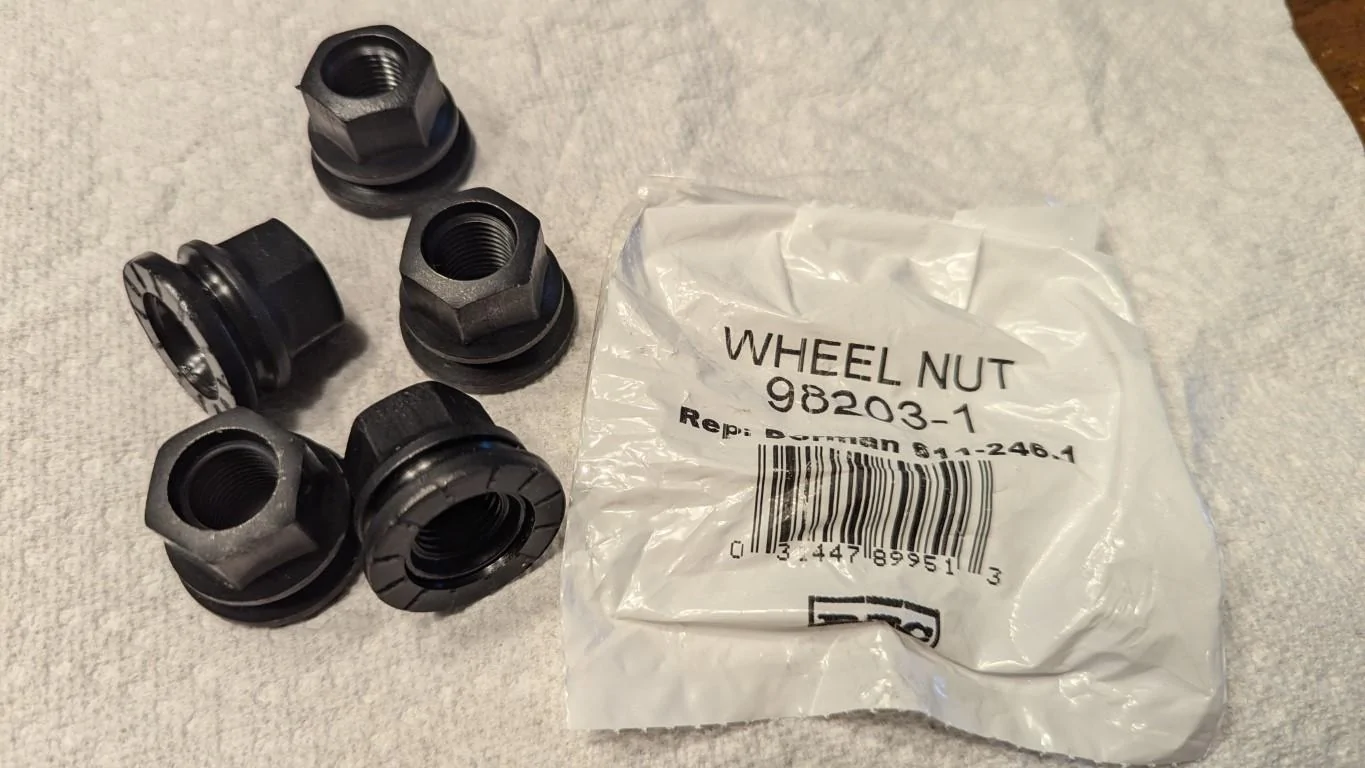

I got the Dorman 611246 lug nuts, they are perfect for this situation.
Each lug nut is 2 piece, the washer has ribbed spots along the face that goes against the wheel which will act as a "lock washer". The nut pivots against the washer.
Parts list
  • Dorman 611246 lug nuts (from a 2006 F-250 Super Duty), quantity: 5
  • Wheel BMW 36116758778 (17x4), has a center bore of 72.6mm.
  • Spare Tire 115/95R17 (Continental sContact 115/95R17 recommended)
  • Hub centering ring 64.1mm to 72.6mm (pick aluminum instead of plastic)

for the lug nuts, i am able to find Doorman 611246.1; by any chance do you know if they are compatible. Thank you.
I am pretty sure it's the same part except the .1 may mean that you are getting a quantity of 1. I got mine from Rockauto, much cheaper than if you go to AutoZone. You want them to support M14 x 1.5 thread.
Also when searching, dorman part numbers are 6 digits with a dash between digit 3 and 4, 611-246. When searching I always try their format, as well as with a space in quotes "611 246" and one all together 611246 (Rockauto style). The worst part numbers are from folks like Power Stop, Raybestos, and Centric - really hard to search for them.

The .1 means one pack, otherwise you have to buy a pack of 10 it appears. If you look at my photo it has the .1 at the end of the part number, it's hard to see sorry.
