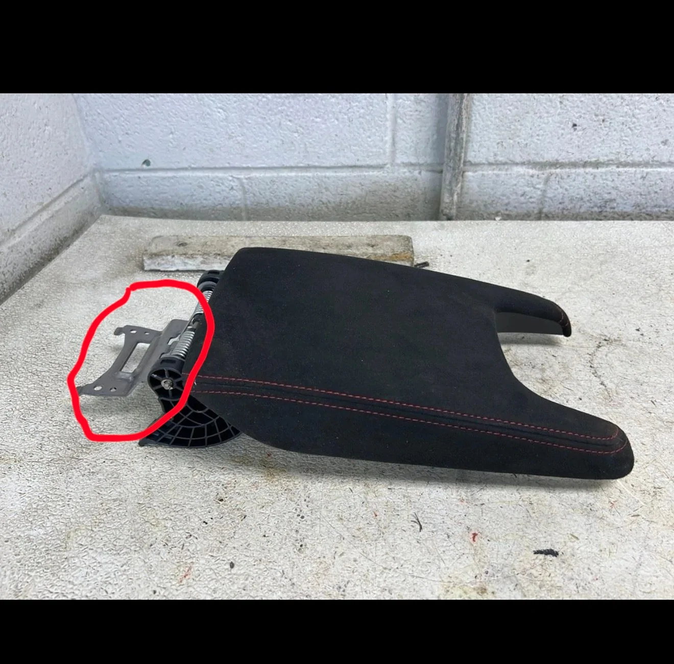

Not the same guy, but I did something similar.
For perfect fitment on the rear vent, I ordered these extra from JDM Yamato:
1x 83453-T24-T01 (duct)
1x 83451-T24-T01ZA (rear housing)
1x 83406-TVA-A01ZA (adjustable vent)
The rear housing from the MikStore kit will not fit right no matter how you trim it, the clips are 5-6 mm further out compared to the original part. The rear vent and duct included in the kit are also not compatible with the housing from JDM Yamato, so you will need those extra parts as well.
Then ordered these from AllDiscountParts:
1x 83433-T43-J31ZA (console box)
1x 83419-T24-T00 (mounting bracket)
2x 90140-TR0-A01 (mounting bolts)
1x 83470-T43-J31 (rubber liner mat)
1x 83405-T60-A21ZA (CTR armrest for the bracket)
But when I did this back in June of last year, shipping from ADP was only $53. I checked again just now and to ship the same parts it would be $211.
Seems like your best option would be to order directly from Honda DreamShop and pick up the parts at your local dealer instead of paying for shipping. You're at the mercy of the dealer for the parts MSRP, but at this rate, whatever savings you get on the parts are completely obliterated by these shipping rates.

Ok, these are the parts that I ordered,
  • These parts I got from JDM Yamato, the specified "Part #" matches to diagram numbers (https://jdmyamato.com/products/nhp001628?variant=43000102617336)
    • Part #8 - 83405-T43-J31ZA - Armrest ASSY., Console *R183L* (R183L Thread Red)
    • Part #26 - 83451-T24-T01ZA - Garnish ASSY., Rear * NH900L * (NH900L Neutral Black)
    • Part #27 - 83453-T24-T01 - Duct assembly., Rear
    • Part #28 - 83460-T43-J00 - Duct, rear vent
    • Part #30 - 83465-T43-J00 - Duct, rear vent middle
  • These I ordered elsewhere, mostly alldiscountparts.com
    • 8A350-TJB-A01 - Charger unit, USB dual (C) (US)
    • 83433-T43-J31ZA - Box ASSY., Console (MT) (VENT) * NH900L * (NH900L Neutral Black) (US)
    • 83406-TVA-A01ZA - Rear outlet Assy (US)
    • 32114-T20-A40 - Sub-wire, Console (US) (Note: This you could go without and probably build a harness to tie into the front USB-C charger and USB panel illumination.)
    • 83470-T43-J31 - Mat, Console Box
    • 83419-T24-T00 - Bracket, Rr. Console
    • 91550-SFJ-W01ZE - Clip, Center Lower * NH900L * (NH900L Neutral Black) x 2 (Note: these are used to secure the rear duct to the console bracket and the front duct to the splitter)
    • 90140-T5H-H00 - Bolt-washer (5X19) x 2 (Note: These secure the console box to the console bracket)
    • 93913-24220 - Screw, Tapping (4X12) x 3 (Note: These secure the outlet assembly to the garnish.
