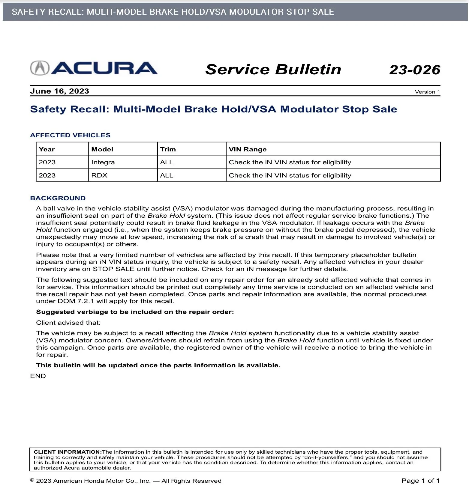

For your information:
Especially if you use brake hold often.
While at work I noticed a new bulletin on the Integra. Should be interesting to see parts availability for effected vehicles since a good majority of Integra parts are on back order.
Acura Integra SAFETY RECALL: MULTI-MODEL BRAKE HOLD/VSA MODULATOR STOP SALE EFAF15DD-17B0-4267-96CE-0C5A49FFEECF

The very week I stop using brake hold (since some of my other vehicles don't have it and I found muscle memory caused me to let go of the brake at stop lights...).
When it says iN VIN status, is there a specific VIN range that is affected?

Thanks for the info. I don’t use it often, but certainly on inclines with traffic behind me.
