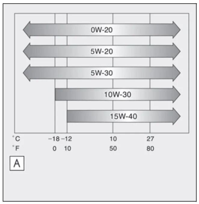

I'll give a modern example: this is the oil viscosity over temperature chart specified for the Toyota 2GR-FKS out of an Australian owner's manual:
Acura Integra 0W-20 vs 5W-30 1758294355648-xr
If the engineers had their way and also didn't feel the need to dumb things down, something similar to this would be in the owner's manual of every combustion-engined car on the road today. And particularly with cars that are marketed as being track-capable, they'd have recommendations about specific fluids for track use as well. Engine oil, trans oil, brake fluid - the whole lot.
