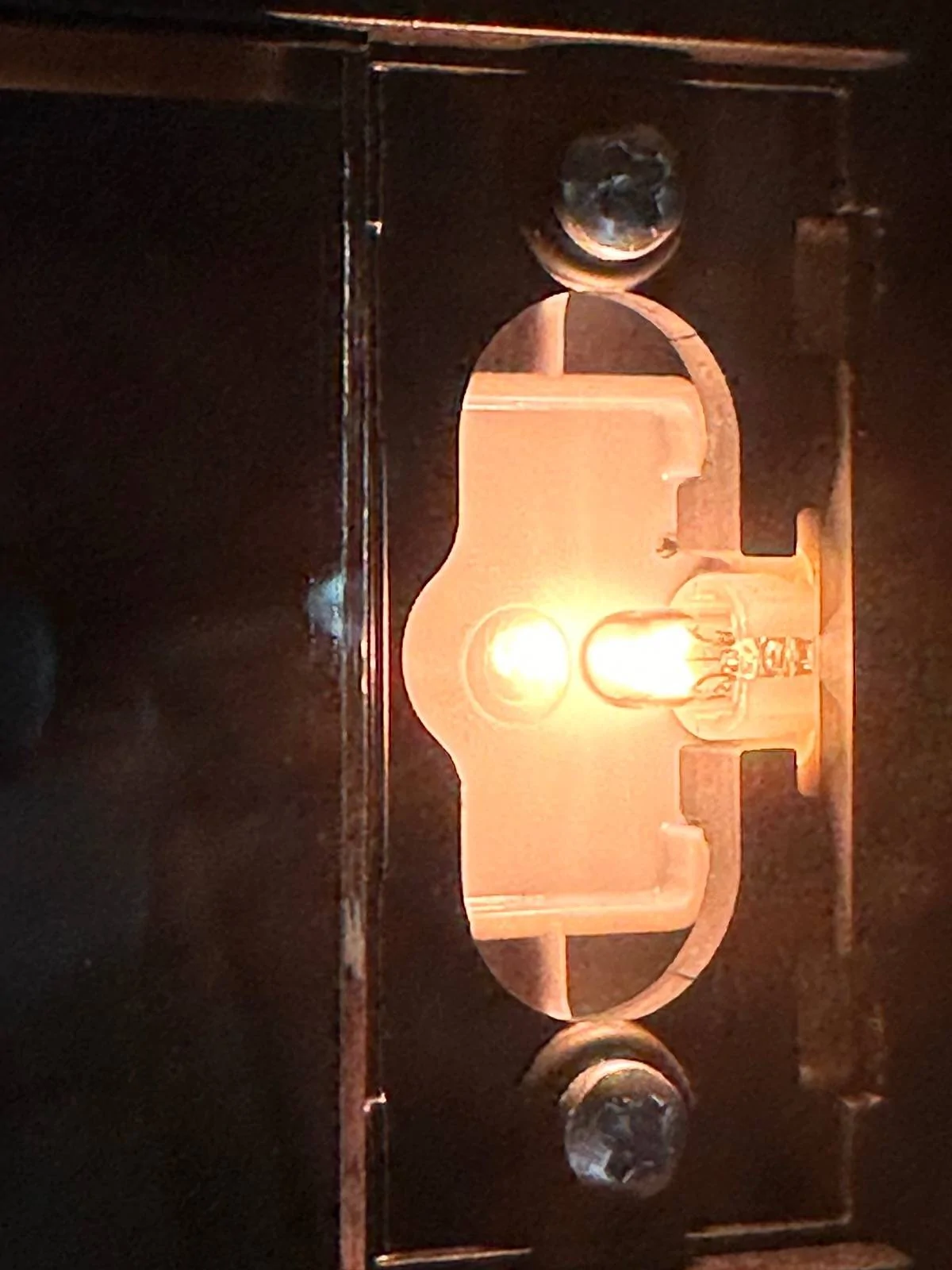

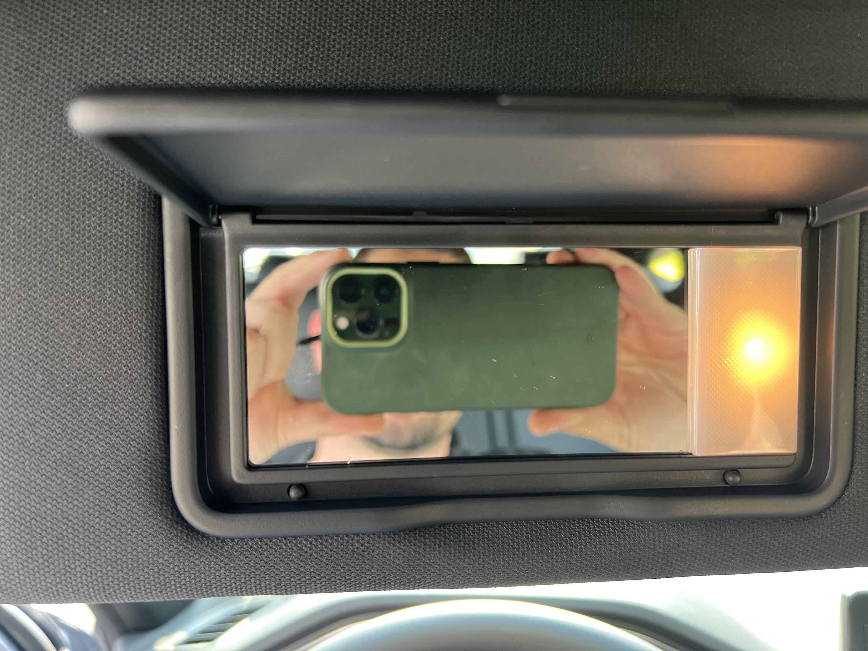

Upon taking delivery of my Integra, I noticed the Vanity lights were not LED unlike the rest of the interior lighting. So I decided to fix that. I purchased size 74 leds from vleds.com 5500k was the color I chose.
Before

After

Lol - it bothered me so much that these were the only non-LED lights on the car. I like how yours came out. Does the color temperature you chose match the rest of the LED interior lights? I'm thinking about doing this too.
Can you share the link the specific product you purchased? Is it this? https://www.vleds.com/shop-application/interior/74-6-c.html

Yea that’s the link to the bulbs I purchased I chose 5500k it matches the interior lighting very well.

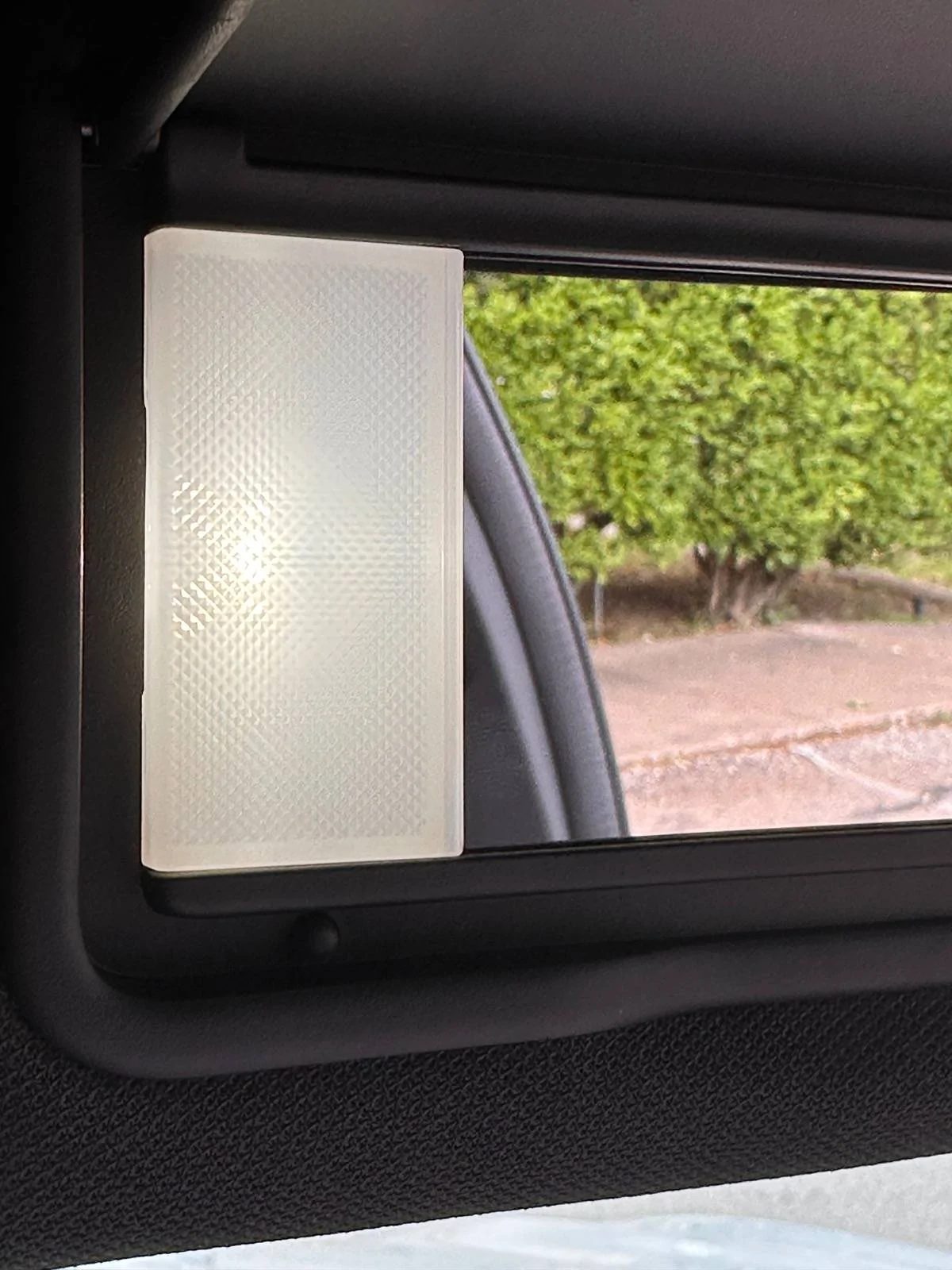

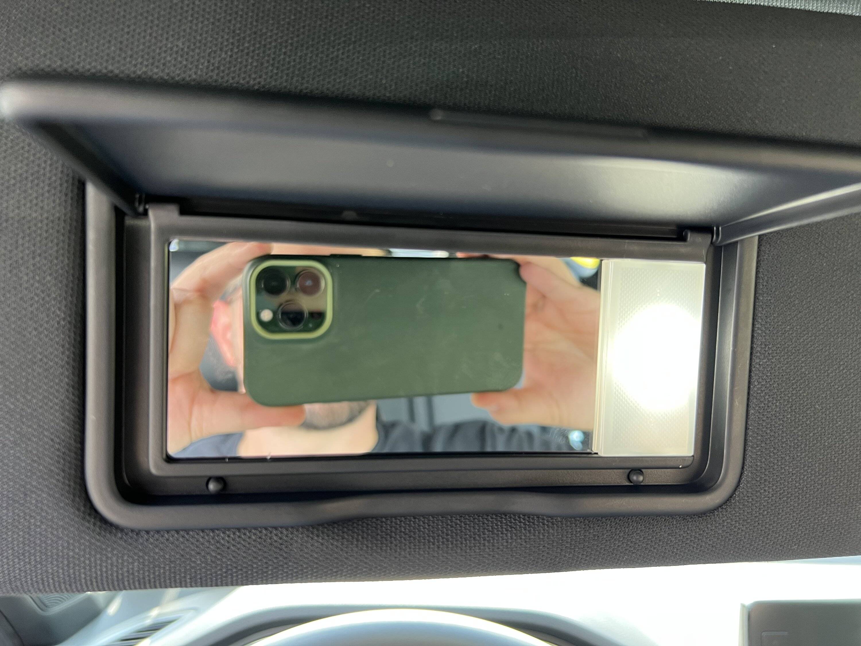

Just got mine installed! It was quite tricky removing and installing the bulbs, the OEM incandescent ones did not want to budge. I had to remove the entire mirror housing so I could have more space to pull the factory bulb out. (Before and After)
Acura Integra Vanity Light LED conversion IMG_6780
Acura Integra Vanity Light LED conversion IMG_6781
