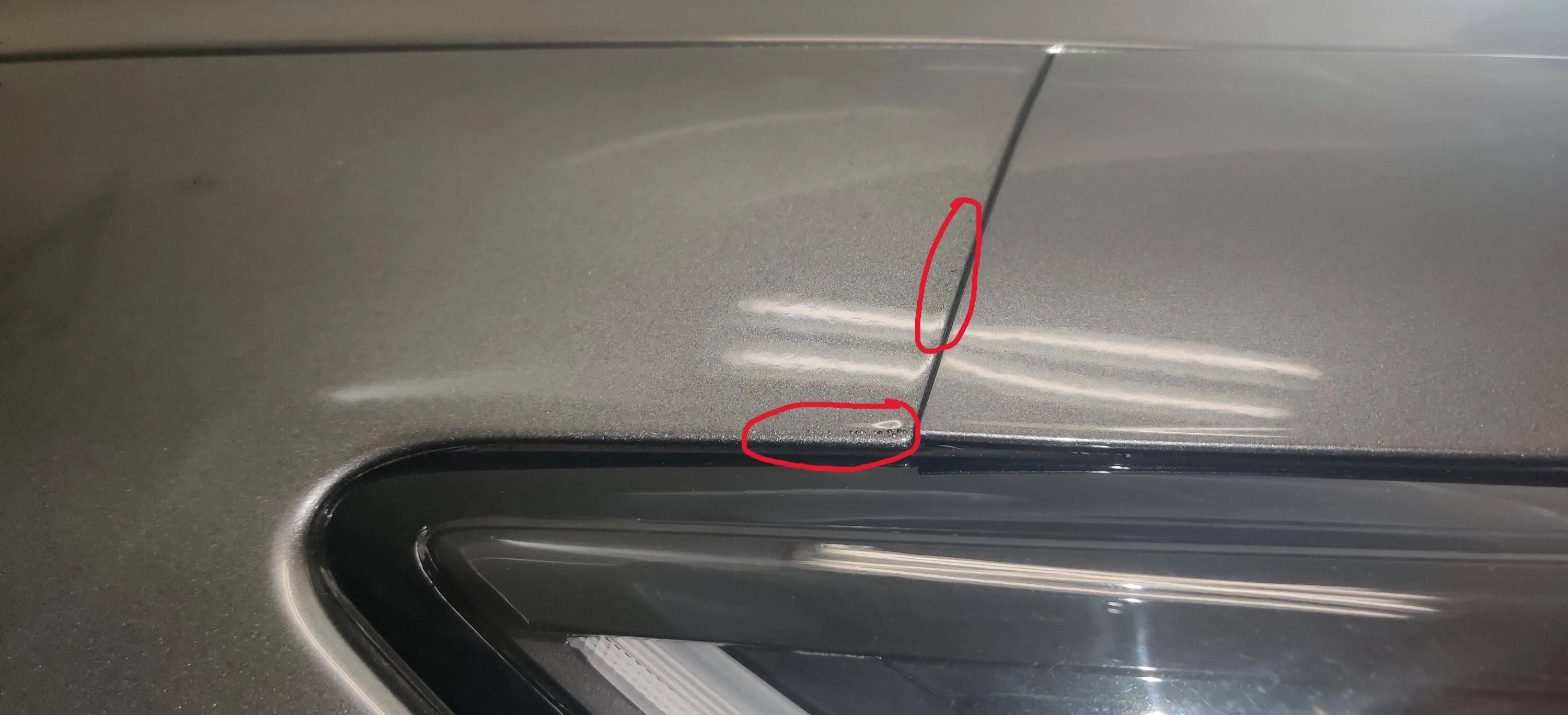

Anyone find any paint bubbles on their car? Just found this after my friend pointed it out. It is on the front, passenger side headlights.
Brought it up to dealership, and they told me it might be covered by warranty but they'll have to send pictures and will get back to me.
Does Acura usually cover paint bubbles like these under warranty or will I have to pay out of pocket?
Also my local car paint shop recommended not getting it fixed because "it is on the bottom" and "it won't be repainted with factory, and the paint used won't be as strong as factory". If I decide to not get it fixed, will it be an issue down the line or is it mainly cosmetic.

Yes that's a problem and it will fail prematurely. Looks like there's some contamination which caused that. You don't know if it's between the base and primer or between the sheet metal and primer.
If I were you I would give the rest of the car a real good once over see if it's happening anywhere else.
Best case,, these were there from day 1, would really suck to have a adhesion issue forming where bubbles strat popping up in the next few months.
The more I look at the picture,,the flop of the metallic looks different from the other panel, iam not liking the panel gap as well. Not to scare you but this could have been (touched up). Dealer/factory will do this for any shipping damage that's caused in freight.
A digital mil gauge would tell you if it was resprayed but you have to know how to read it. You will get various numbers all over the car , I've seen it vary up to 2 mills on a panel most brands keep it around a mil. For reference a hood might hit 3.56 on the right side 3.03 in middle then 4.1 on left that's normal. Now if I were to get a 6.9 or 7 on said hood on a corner and it dont look perfect. It screams respary
The more I look at the picture,,the flop of the metallic looks different from the other panel, iam not liking the panel gap as well. Not to scare you but this could have been (touched up). Dealers will do this for any shipping damage that's caused in freight.

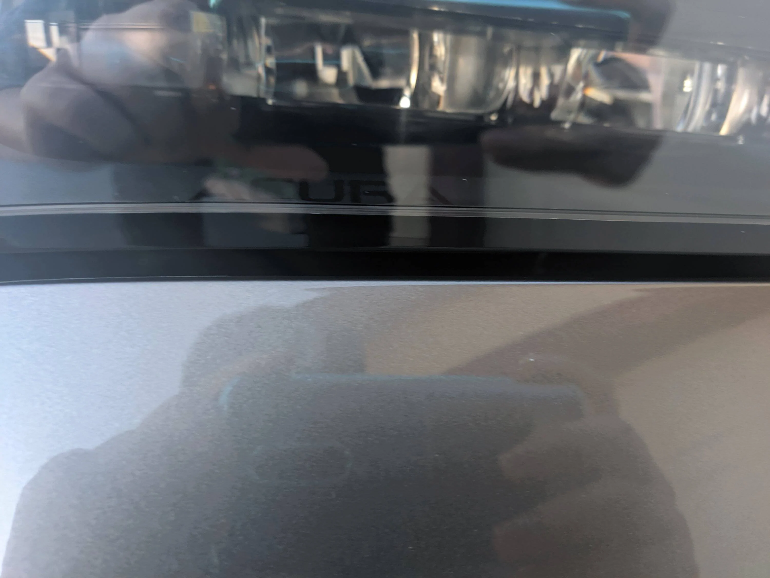

Yeah, I've taken a more thorough look this morning and found a bunch of minor issues.
That gap occurs on the opposite side as well.
No other paint defects. But I noticed a big gap between the fender and headlights on the same side of the paint bubbling.

Paint issues are a PIA to diagnose from pics alone. What iam seeing could just be lighting but I dought it. Take it back to that body shop have them mil it see what they find. Really this comes down to you, if it's a lease why bother,, with it have it documented and move on.
Some people say it's overkill but I always take the shops elcometer when iam car shopping, it saved me on a low mileage eba gtr, drivers door was resprayed was never documented who knows what happened
