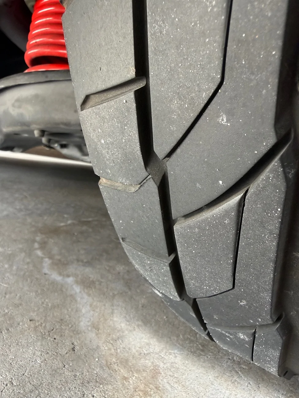

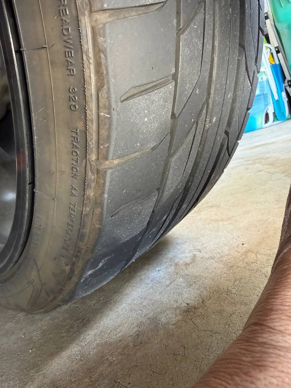

Here are the photos I took….hopefully you guys can see the cupping
Acura Integra Question after lowering car w Eibach IMG_3020
Acura Integra Question after lowering car w Eibach IMG_3019

Yep, that's definitely cupping. It's narrow, not broad so I'd suspect something more geo related. I'd have another shop double check the rv6 arm install and general seating of the spring. Just based off appearance I would suspect bushing of some sort back there.
