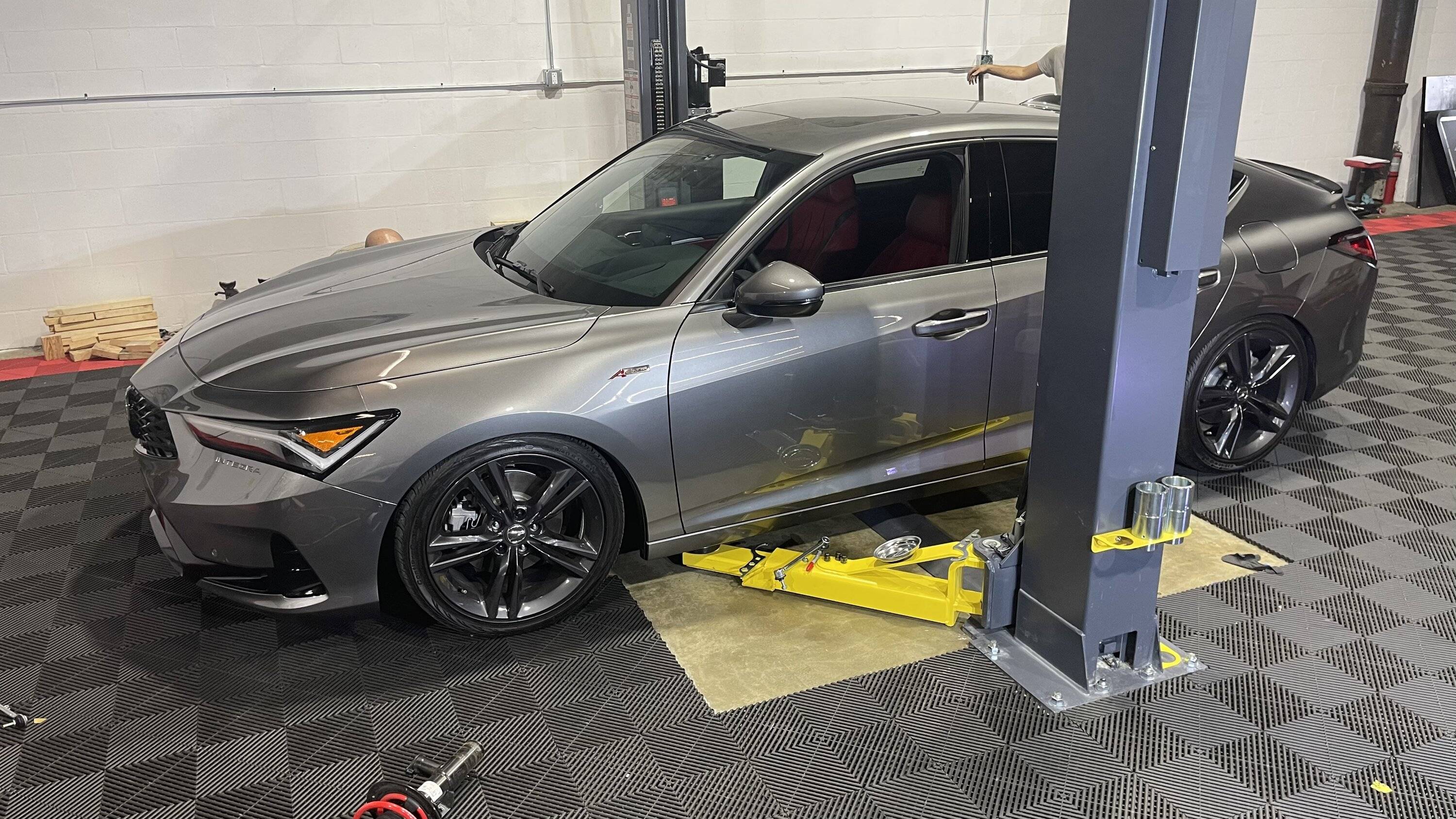

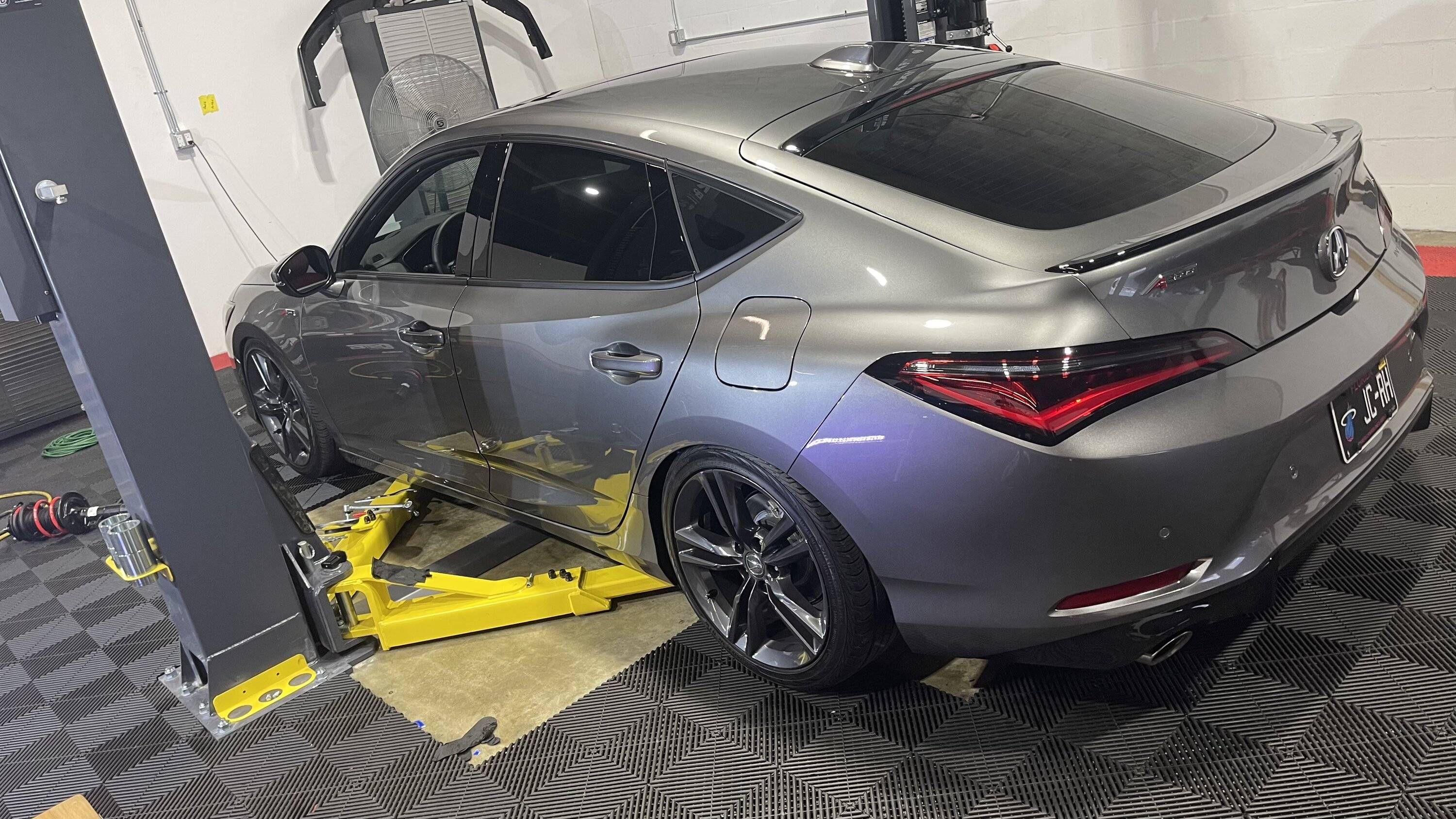

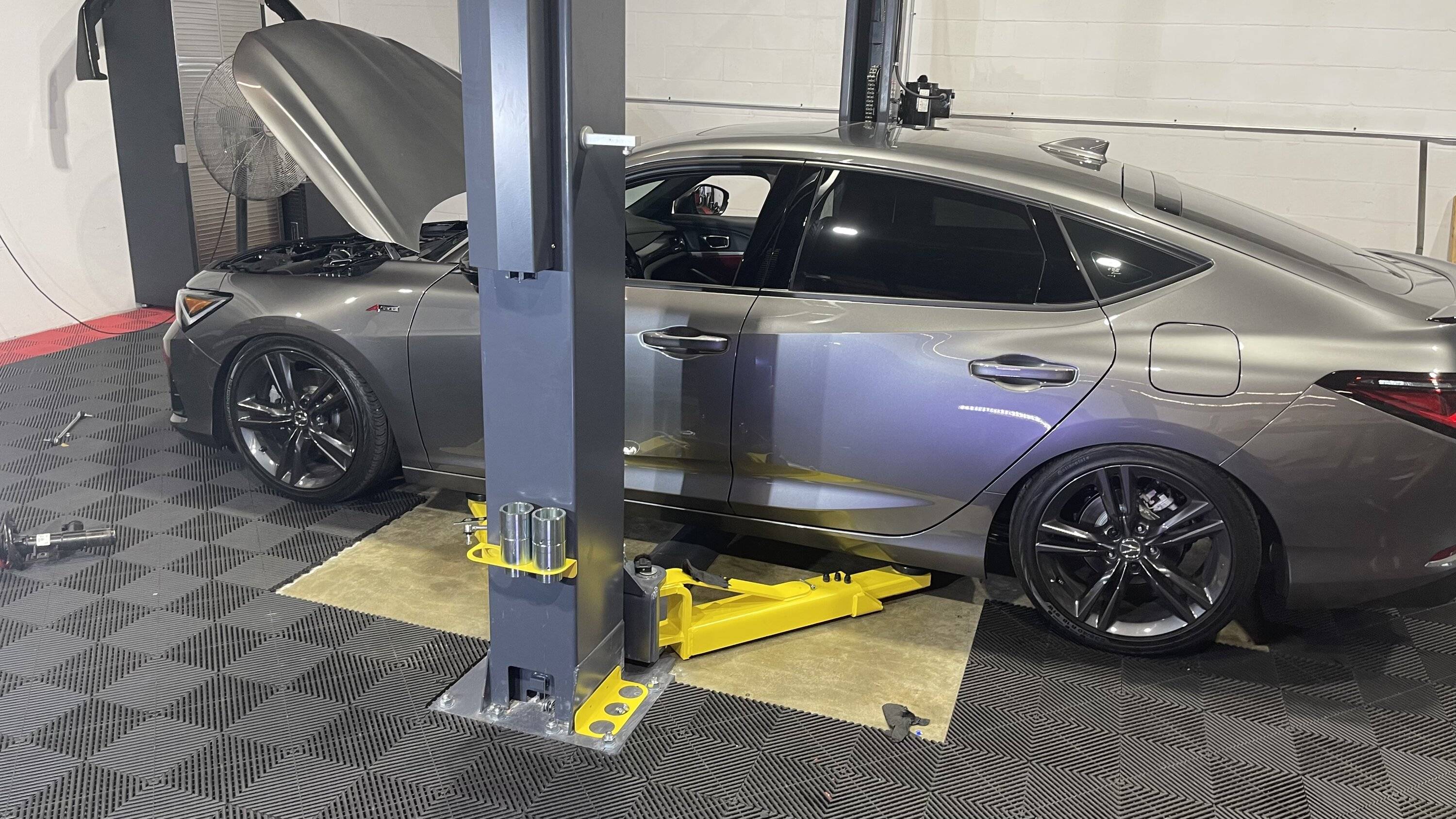

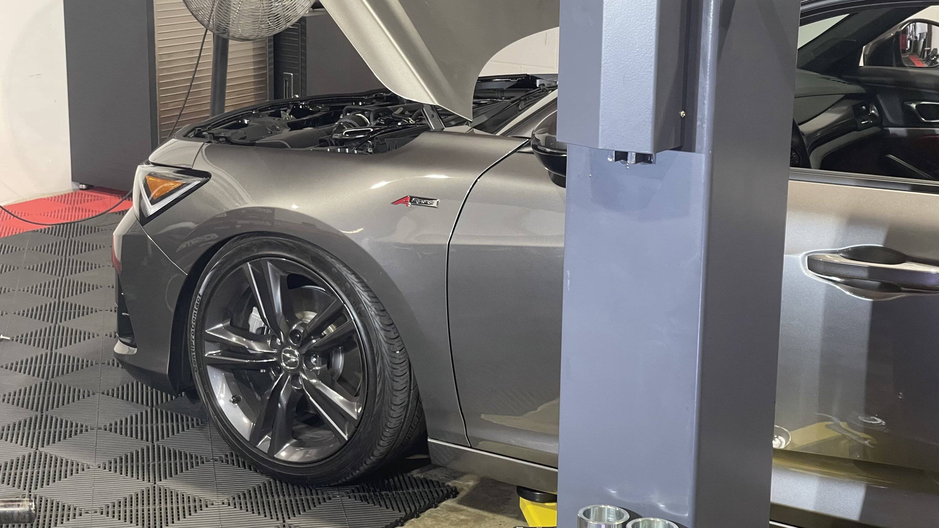

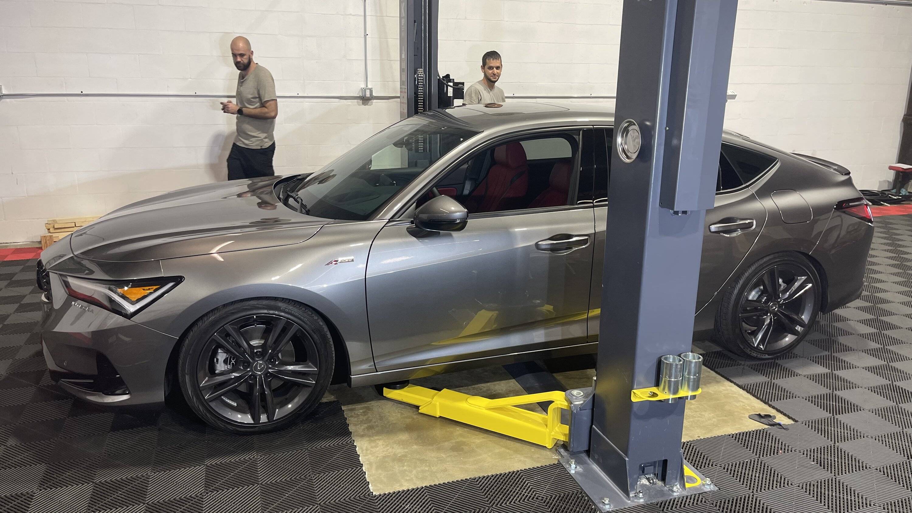

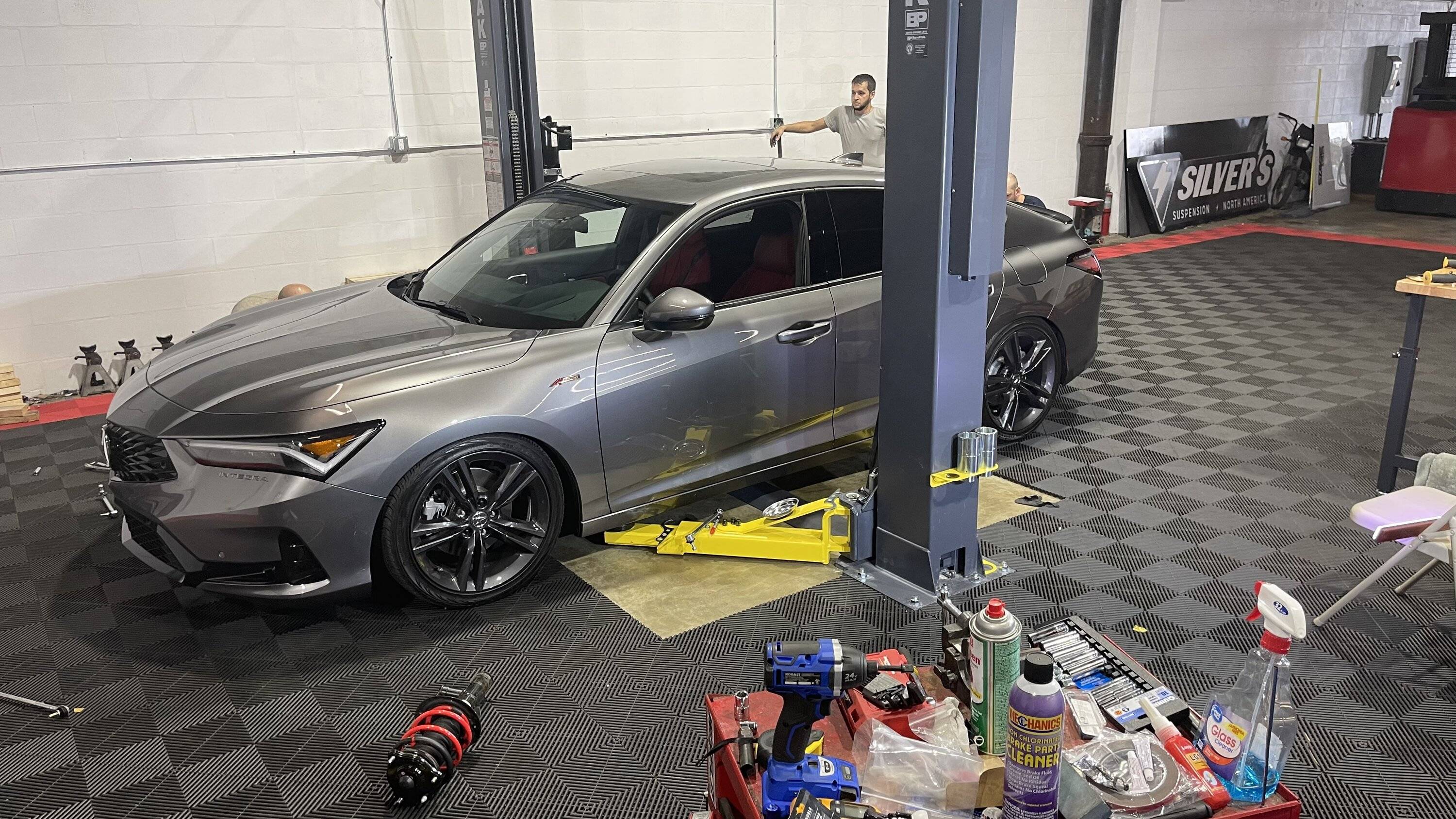

Silver’s used my car to test out a kit they plan to release for our cars. I visited their shop today in Ft Myers, FL today to get everything fitted and installed.
Their staff are very knowledgeable and professional in all that they do. They were able to explain the whole process, and they set me up exactly how I wanted it.
I still need to play with the dampening. Needless to say, the Adaptive Suspension no longer works. However, the other issue is that I cannot switch out of the Normal drive mode. I will try a couple different things and report back on the subject, as well as driving impressions once I put the kit through its paces.

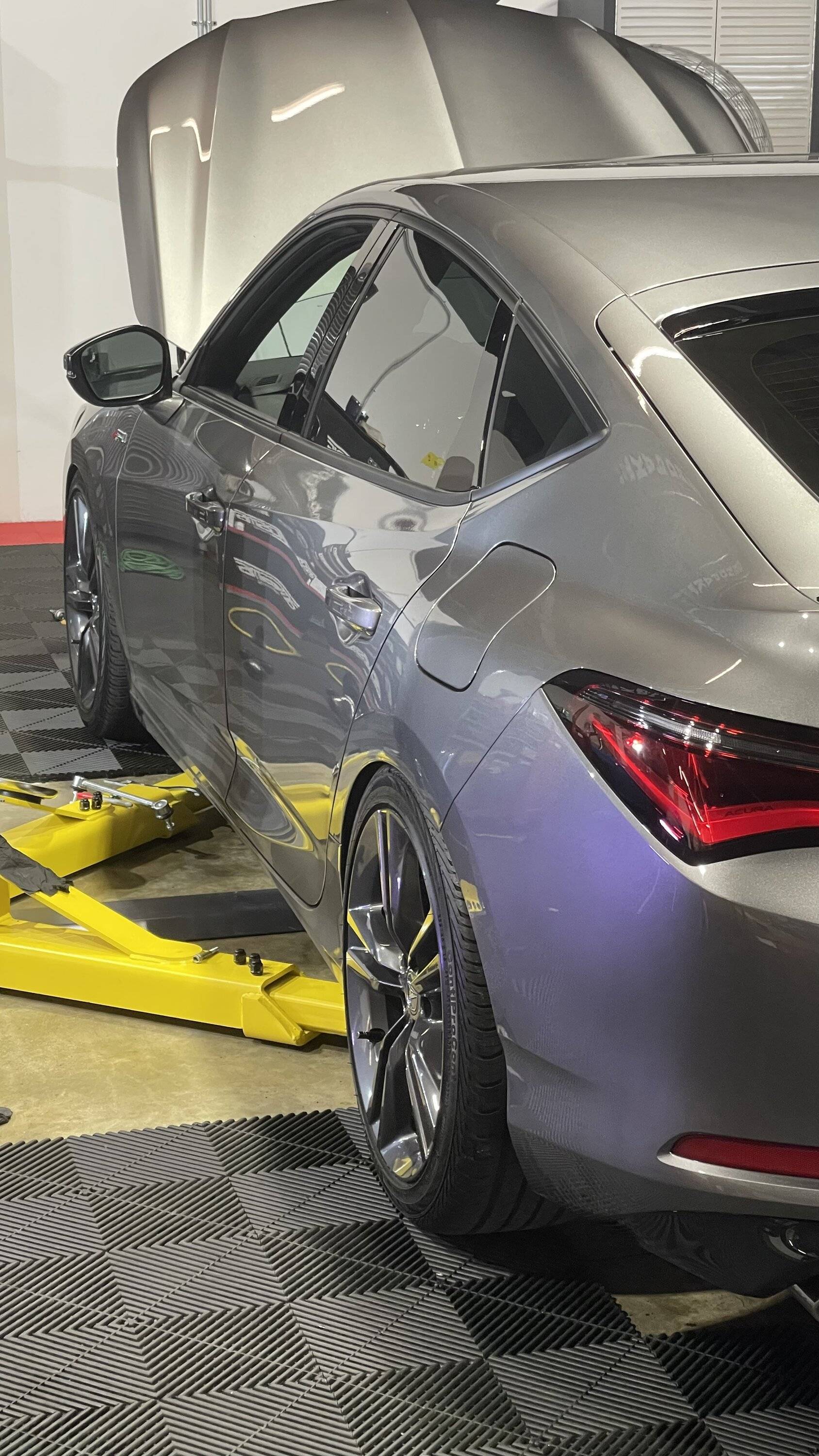

My setup consist of the Swift springs upgrade, running 8k front and back. The kit also comes with adjustable sway bar endlinks. No noise so far and everything works smoothly.

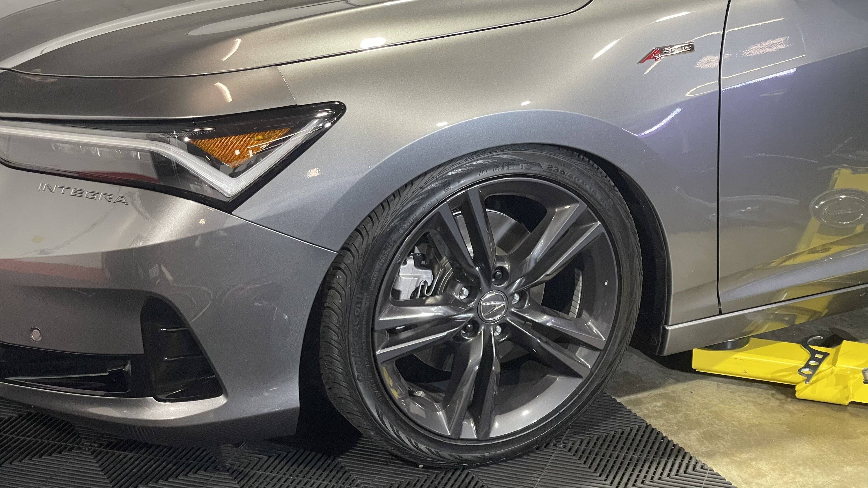

Here are a few pics of it completely maxed out on the low setting. This is before they settled a bit more. The team raised it about 1/2” all around, and now it has a tiny bit of tuck. I am running 20mm front spacers and 25mm spacers. Zero rubbing.
Final setting (before they settled):
