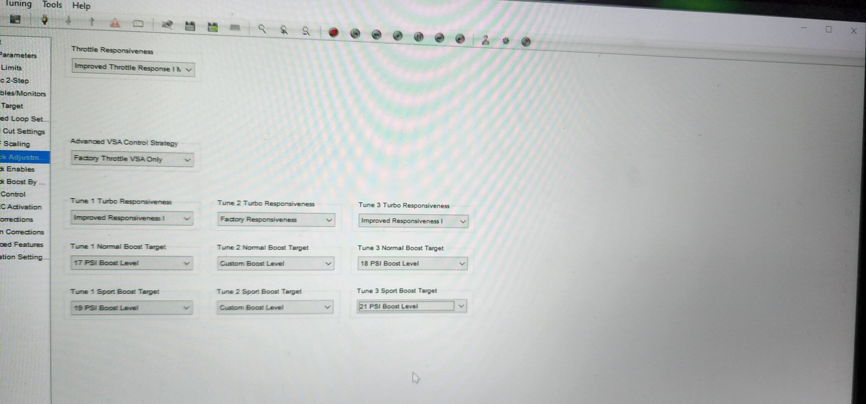

I'm liking throttle level 1, I think it was just me getting use to the car and if i remember correctly it was like a nice 70s day and the car just felt rather strong. Right now I'm running throttle level 1 with rev hang( loving the rev hang enhancement) and turbo level 1. 17psi in normal and 19psi sport. I do have map 2 at 18/21 but haven't tried it yet that's for a cool day. Early spool and turbo response difference I'm unaware of
So if I’m remembering correctly, that’s the starter dual tune stage 0/stage 1 modified to add 1 psi each. Plus you changed the throttle and turbo response to level 1.
Then for map 2 (that’s where you change via cruise control right), you are running starter dual tune stage 1/stage 2 as is. Did you do throttle and turbo response level 1 for that map too? Also what’s on you map 3?
@KTuner could you let us know the difference between early spool and turbo response?
Also if I run straight stage 1 18 psi tune where it’s the same for all 3 drive modes. What is the default map 2 and 3? If I were to change via cruise buttons, are all 3 maps the same for that starter tune? In other words, it wouldn’t matter if I went to map 3 “by accident” (I know that’s not likely) because they’re all the same.
Im planning on running that stage 1 tune with possible the only modification being throttle and turbo response to level 1. Just want to know exactly what I’m doing before I do it.

How I'm setup the moment.
Acura Integra Ktuner for 2023 Integra is live! 20220809_203226
So tune 1 is my extra kick map.
Tune 2 is ktuner 16.5/18 and tune 3 is just for fun but because of temps I will not try.

Ok cool. So the throttle response is global for all 3 maps. And you aren’t formally putting different starter maps as each of the 3 tunes. But you basically did via changing boost targets. You picked the stage 0/1 dual tune to start. Increased boost on tune 1. Left 2 as is. And made 3 essentially the stage 1/2 tune.

exactly! this way i dont need to keep flashing

Okay, so before I save a copy of that picture, I just want to confirm that this was done with the KTuner from Phearable. Thanks!

No this is the base maps from ktuner. I have not gone with an independent tuner yet. Plus I hear some of their parameters are locked so I'm unsure if you can make the same changes. Either way I think should be able to change some of these

Ohhh...I got my references crossed. It's Integra23 who got his from Phearable.
