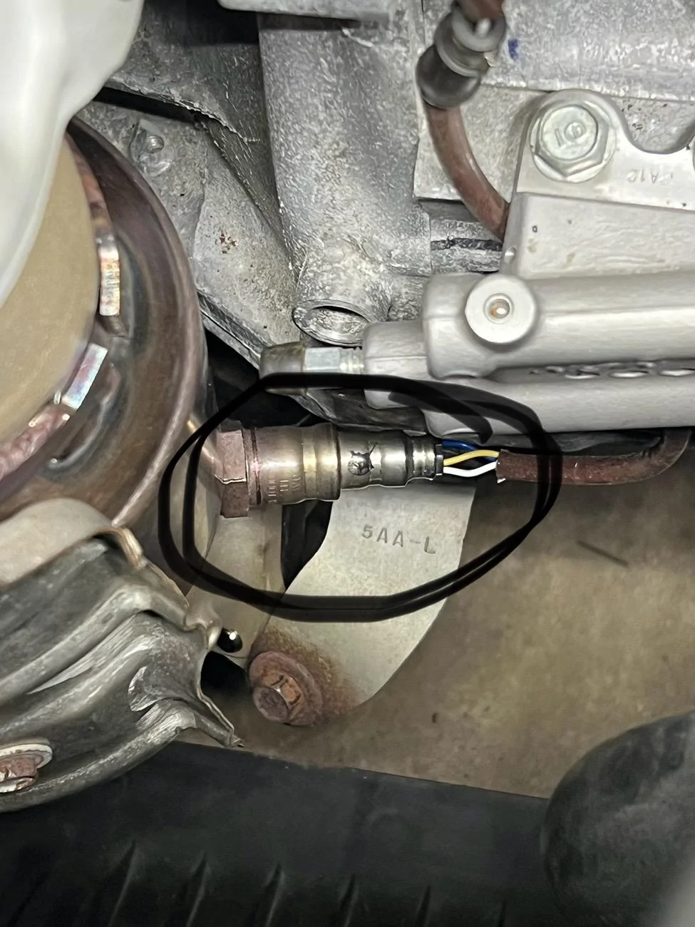

Last November I pre-ordered what I believe was the first batch of Two Step Performance Downpipe and being an early adopter it appears I got a defective one. I have contacted TSP via email on 7/7 and have yet to receive a reply I’m sure due to the holiday weekend. Since it’s obviously a manufacturer defect I assume this is warranty issue. My question to fellow forum members who have this down pipe for their 1.5T does your secondary o2 sensor rest on your transmission.

Confirmed my downpipe is unfortunately “defective” has the secondary o2 bung welded in the wrong location. Awaiting the replacement.

No it should be straight out the side out of the way of the slave cylinder. Were you driving it like this or is this a fresh install? Either way hopefully TSP has some stock held back for support purposes.

Fresh install.
