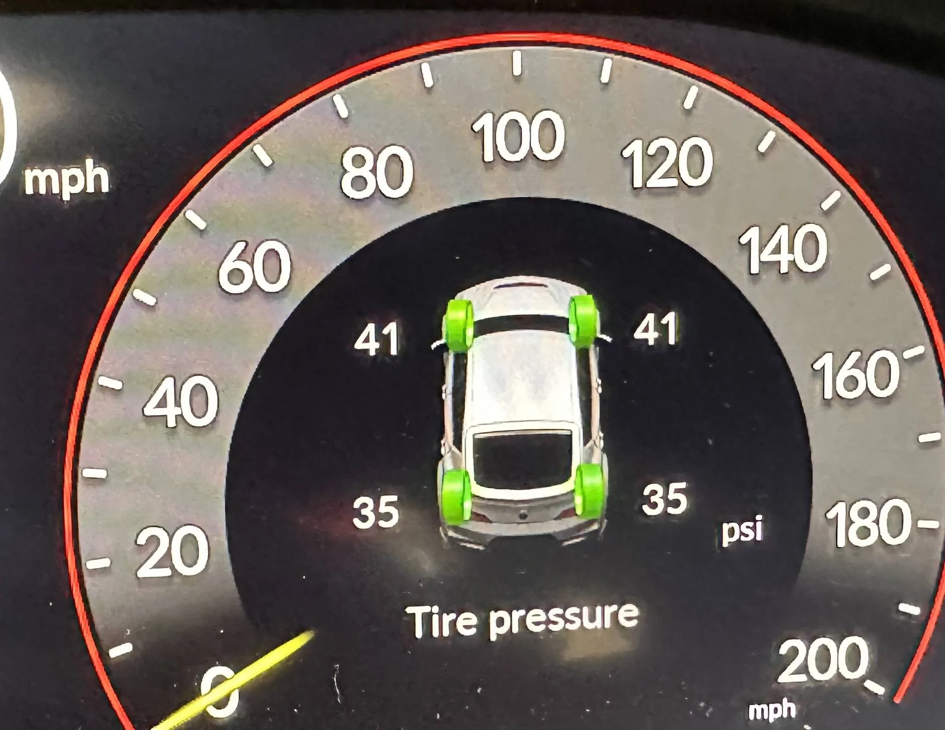

Went to check my tire pressure this morning and all tire pressures were 30-32psi.
opened the user manual and it recommends
Front: 41PSI, (280kPa)
Rear: 33psi (230kPa)
I reinstated to users manual recommendations. Not used to see front tires this much more inflated is this correct? What has everyone else done?
