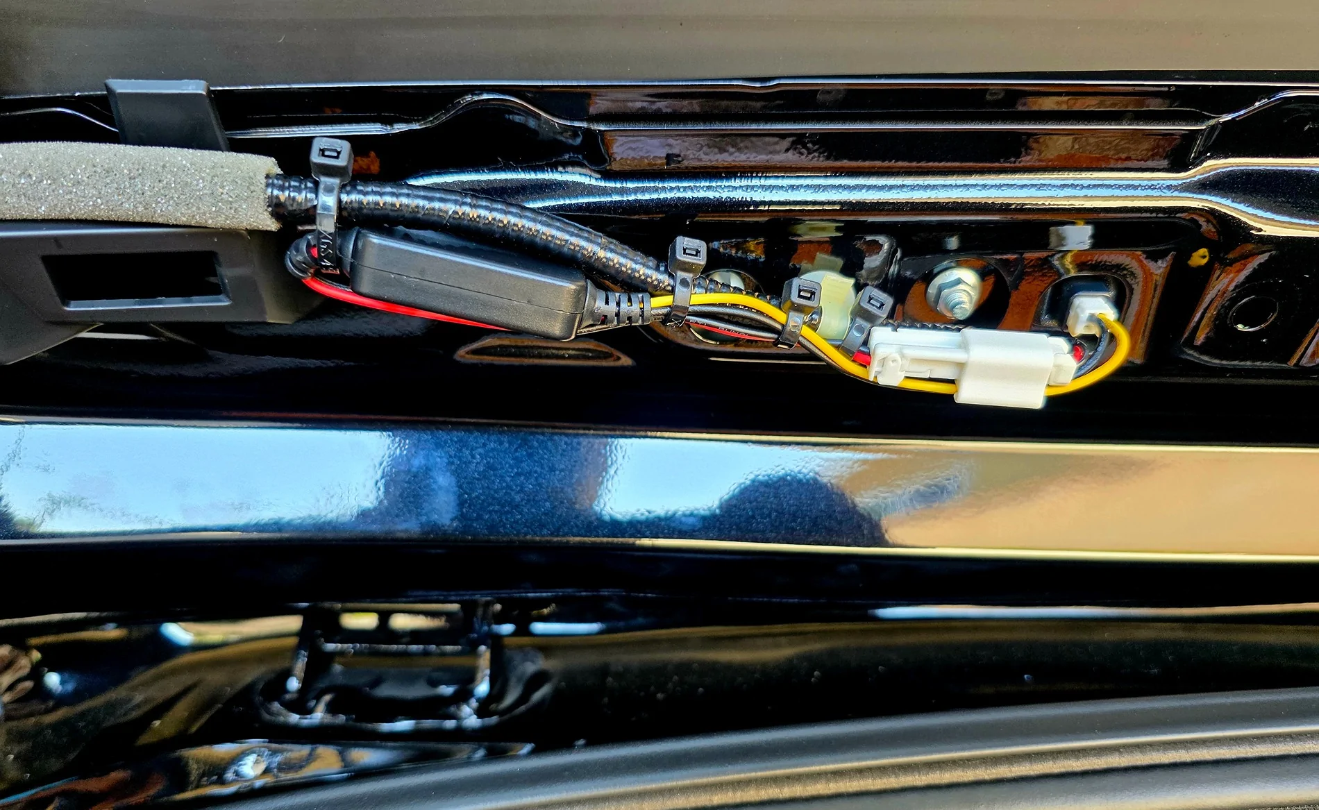

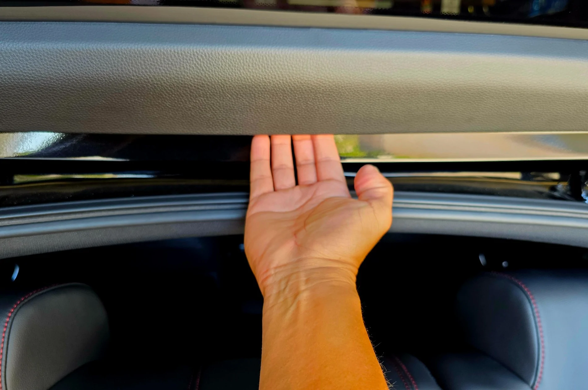

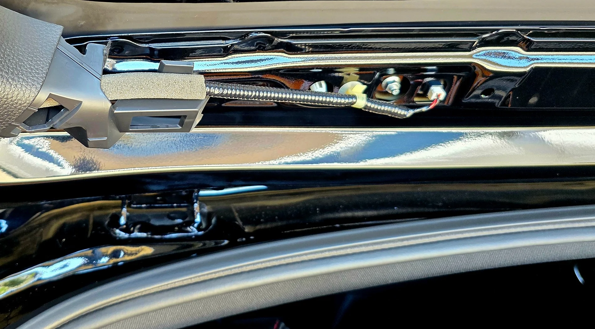

Thanks for this! Was a little intimidated by phothrottle's video the CTR instructions. Glad it's much simpler in ITS.
I'm glad it's easier on the Integra, too! I wish they were all that simple to install.

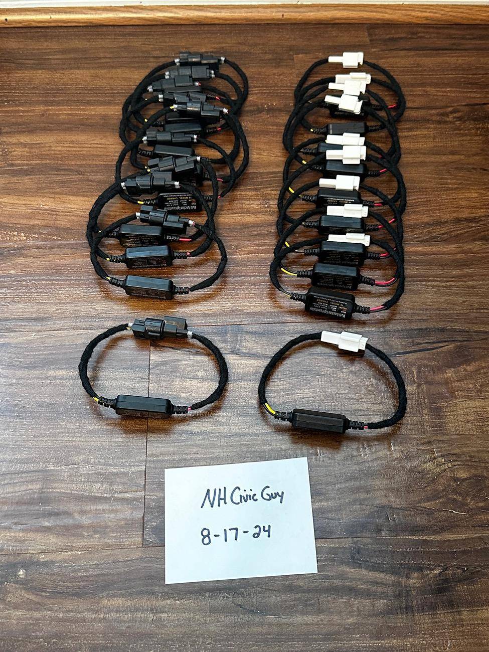

If you still have one for the type s, id take it off your hands. Lmk!
