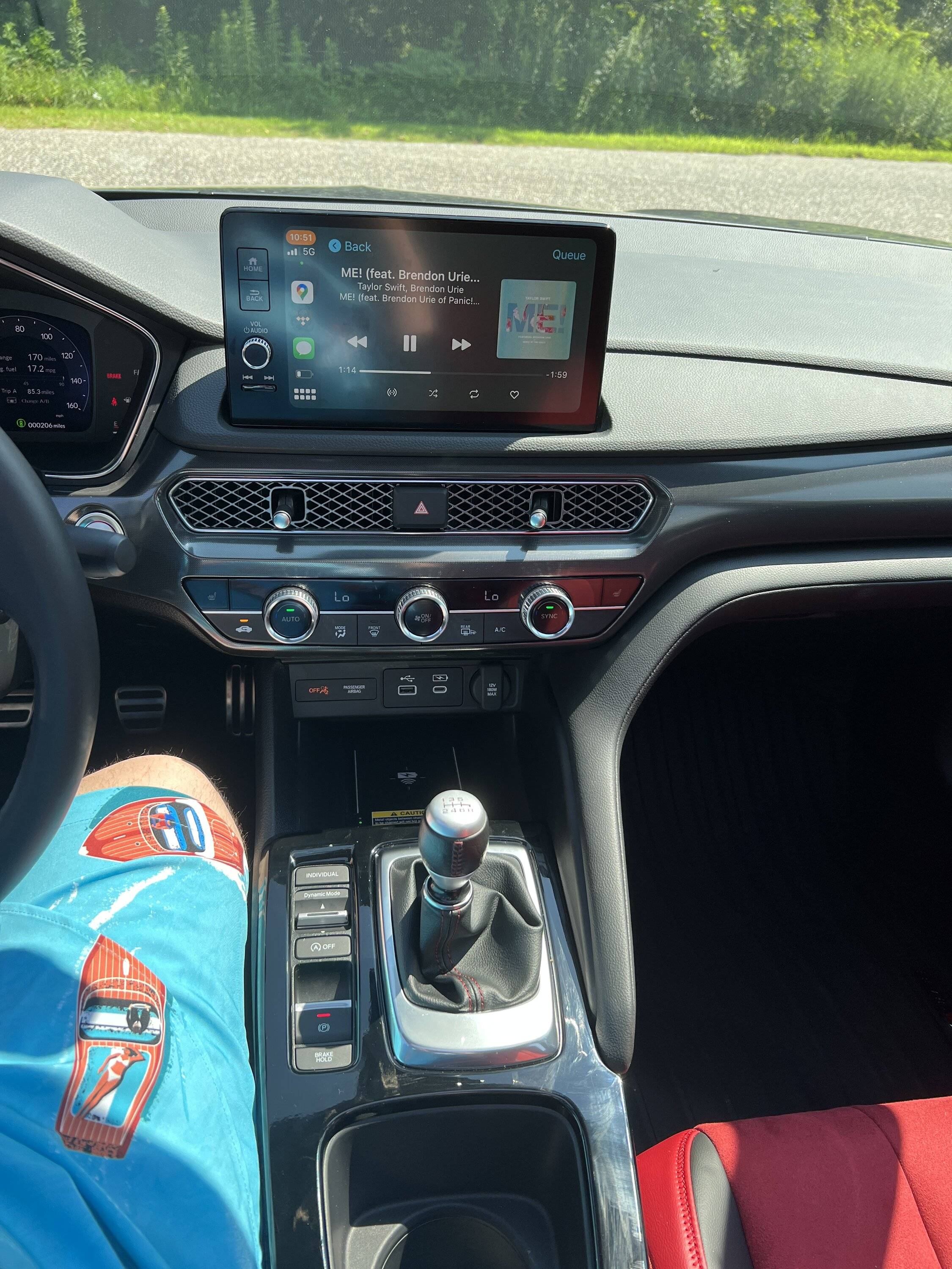

I have not seen a high return on my gas mileage meter yet. I am starting to wonder. I tried resetting the counters, I’m filling up on premium at Wawa, I do idle a lot and I do use AC, but still, I feel 14-20 isn’t quite normal. I do rip the engine a bunch. Perhaps I am just leaning on the clutch too much, can someone explain this? Now I know what 14 miles per gallon feels like, and that’s bad, it’s like half a tank of gas driving from one end of Philly to another, this isn’t that. I feel I am getting better but perhaps it’s more the readings of it all are inaccurate? You can see in the corner there on the pic that I am reading 17 miles per gallon. I never see 30 or something. Now I didn’t do much to break in the car, my mistake, but from what I read online this should not happen no matter how I break in the car.

It sounds like you are doing everything you can to get the worst gas mileage possible. I have no idea what you mean by "leaning on the clutch too much," but that doesn't sound like it's good for gas mileage or your clutch. You can verify the accuracy of your meters very easily by just checking your mileage for a tank the old fashioned way: The next time you fill up either note the mileage on the odometer or reset a trip meter. Run through that tank then divide the miles you drove by the amount of gas needed to refill the tank.

From my experience as the car breaks in the gas mileage actually gets better. Usually takes about 3 to 4 fill ups. But 17mpg is pretty bad. I avg around 35-40mpg mixed driving with my lifetime avg at 31.8 now. You only have 200 miles on the car and idling affects how the computer calculates mpg but doesn't necessarily translate to your actual gas mileage. The best way to really check mpg is like someone said. Fill up your car all the way. Reset your trip Meter. When your ready to fill up again divide the number of miles driven on that tank by the amount needed to top off. I can't remember my last numbers exactly but I believe I got 358 miles and need 10.280 gallons which equated to like 34mpg
