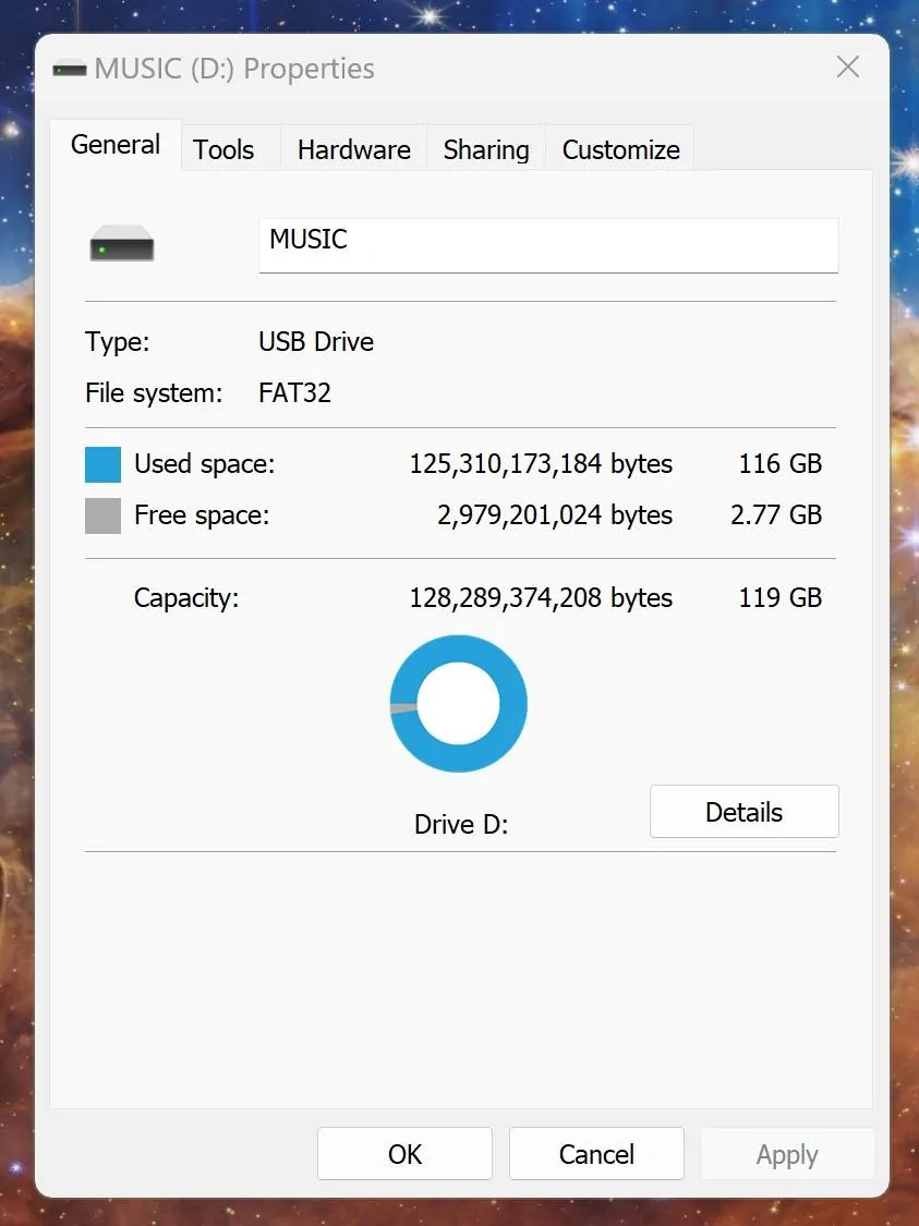

You can use the command line format command for a larger USB drive with FAT32. I am currently using a 128 GB USB drive formatted as FAT32 file system. Working perfect.
