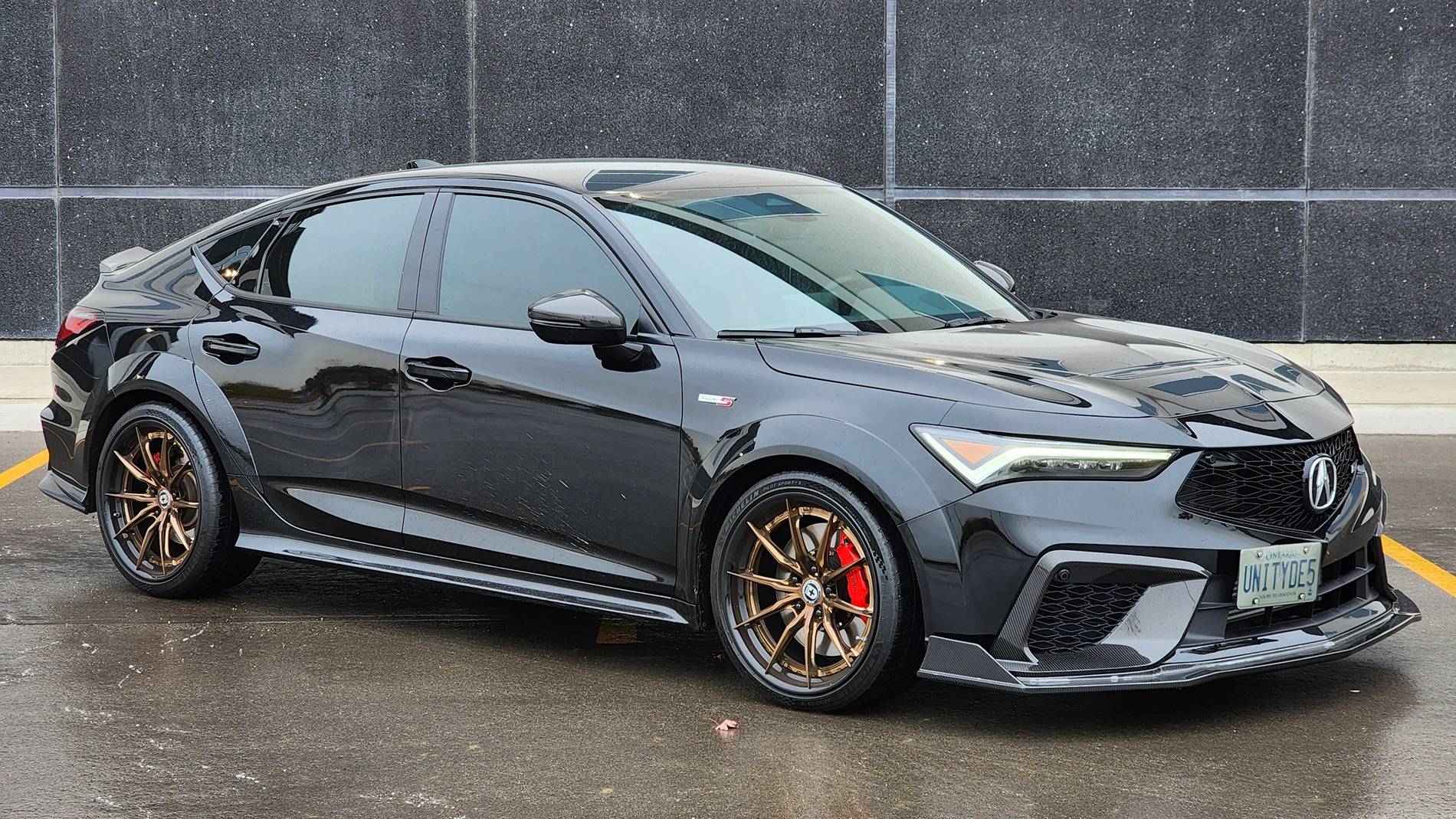

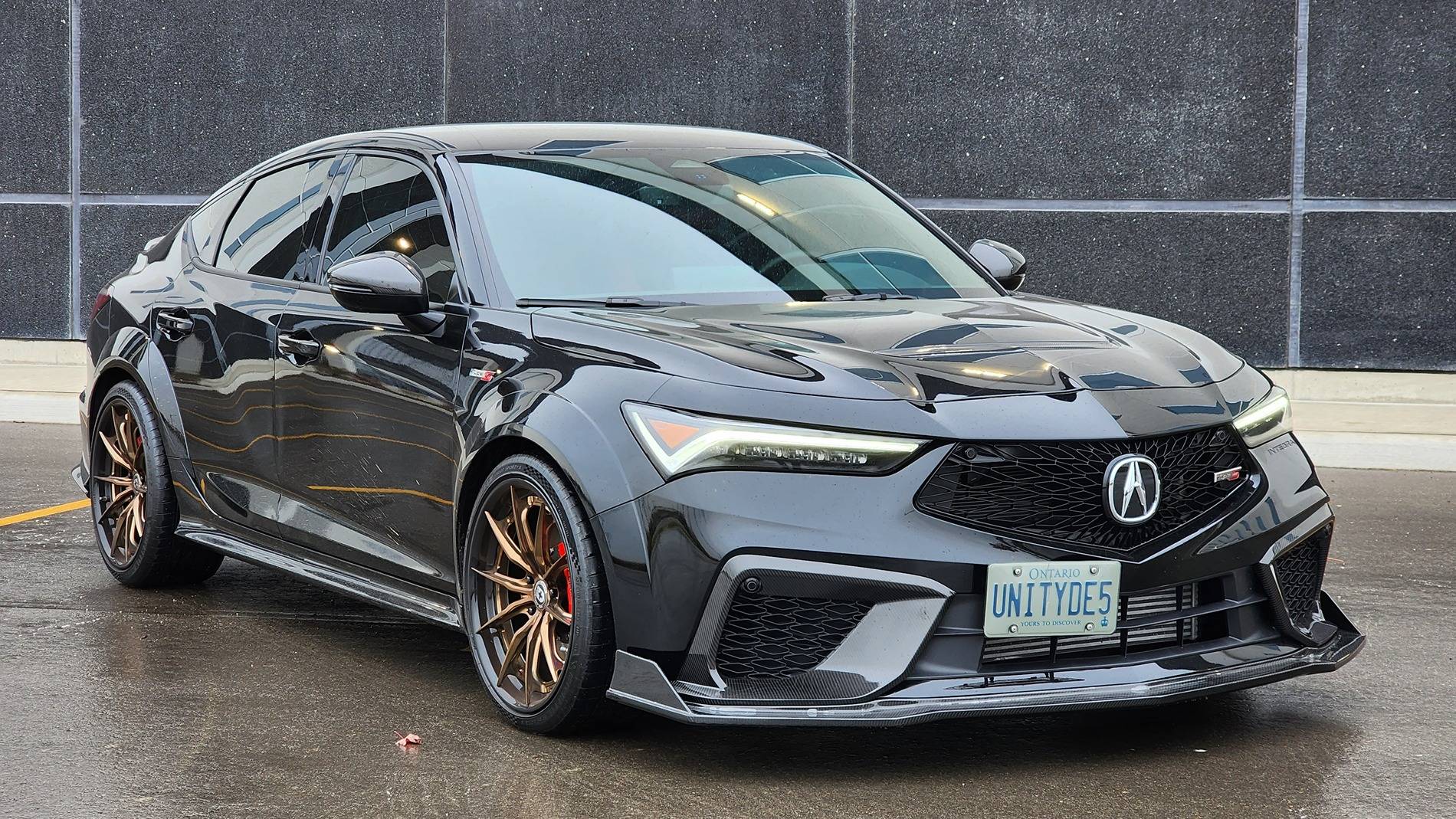

Hey all, starting a thread to document everything we do to our DE5 shop car before we really start going heavy into it!
It is not personally owned by me, but by one of my really great friends and customers, Aneil, whom I did a complete FC1 build with but we sadly didn't document it from start to finish, before parting out the car when the ITS came.
I'll let Aneil do the talking because he truly is the Unity Hypeman! He's got the biggest heart and personality, so the UNITYDE5 plate is well deserved :)

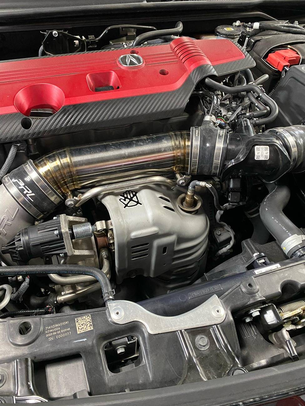

Mod List:
APR Carbon Lip
PRL HVI
PRL Inlet
ECU Unlocked on-site by DRob
HRE Wheels 19x9.5 +40

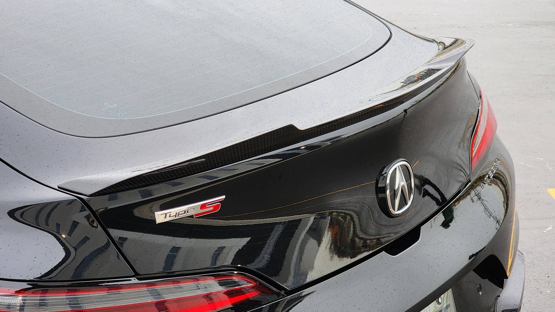

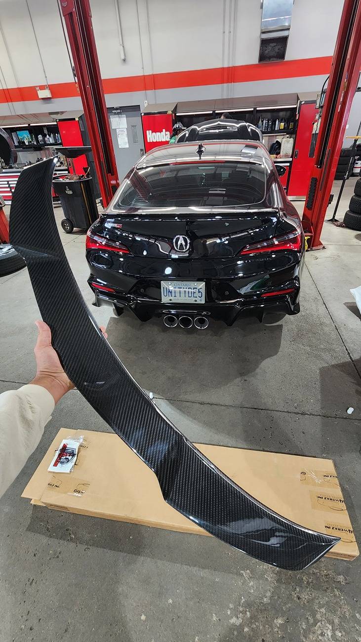

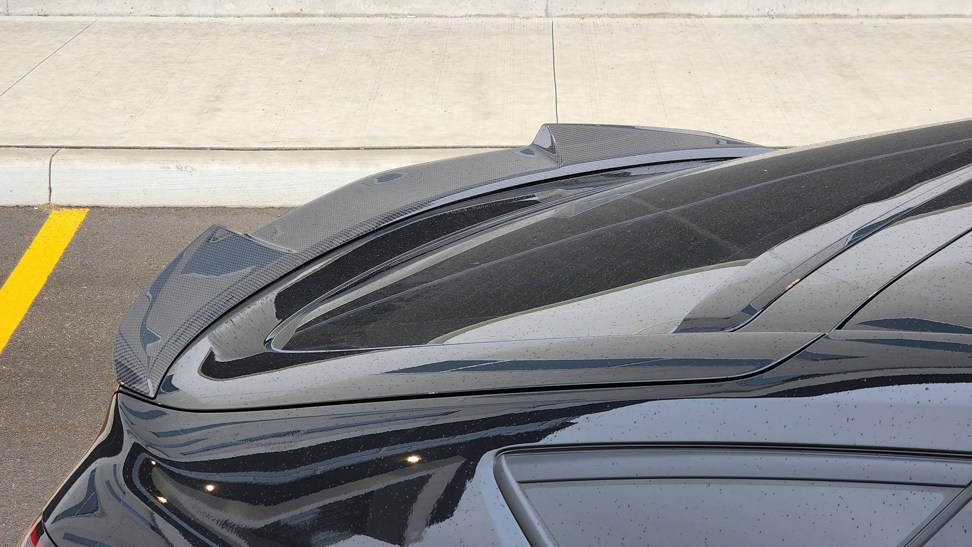

Second round of upgrades calls for more Exterior Mods!

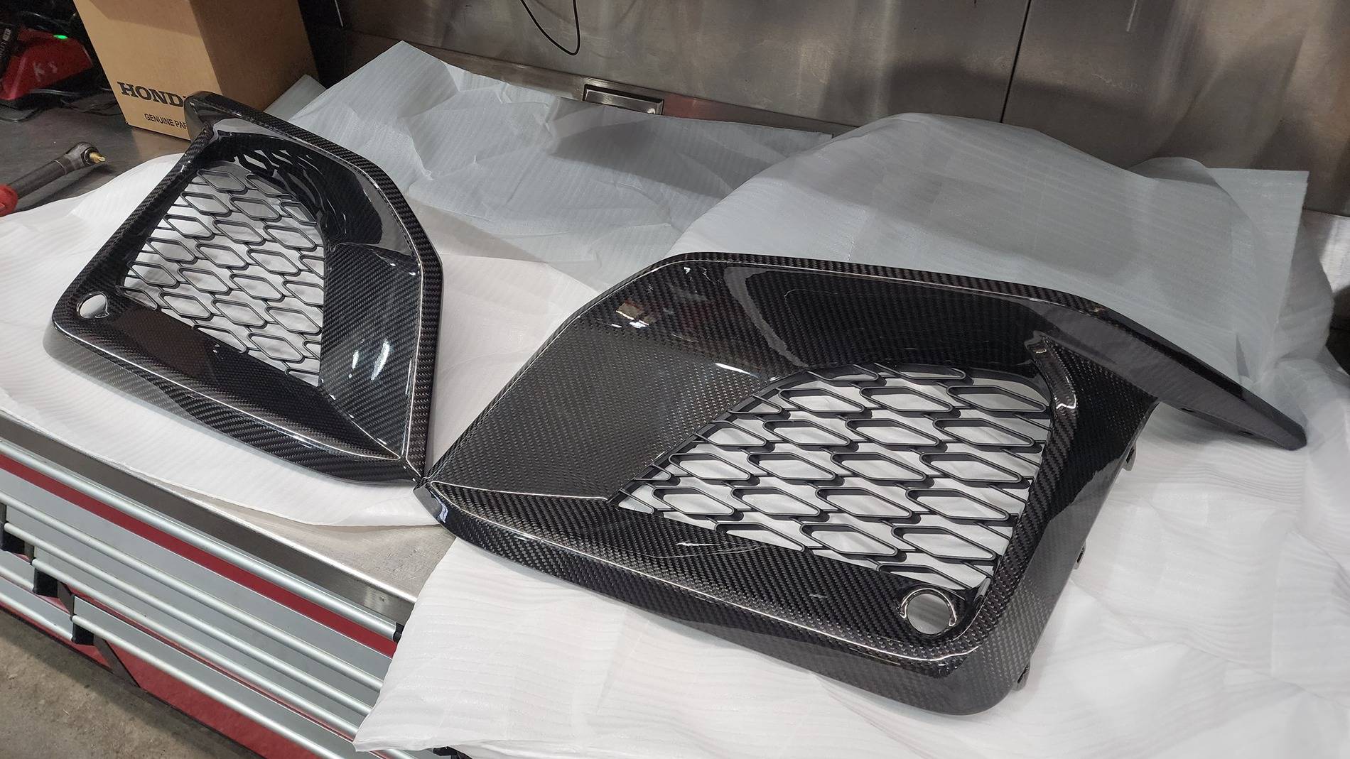

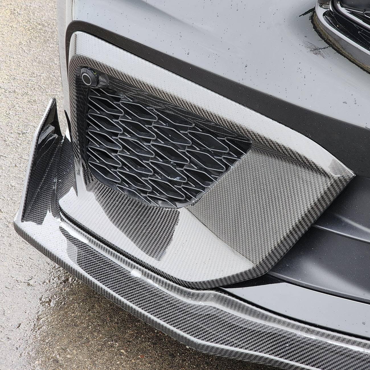

G4werkz Carbon Bumper Bezels

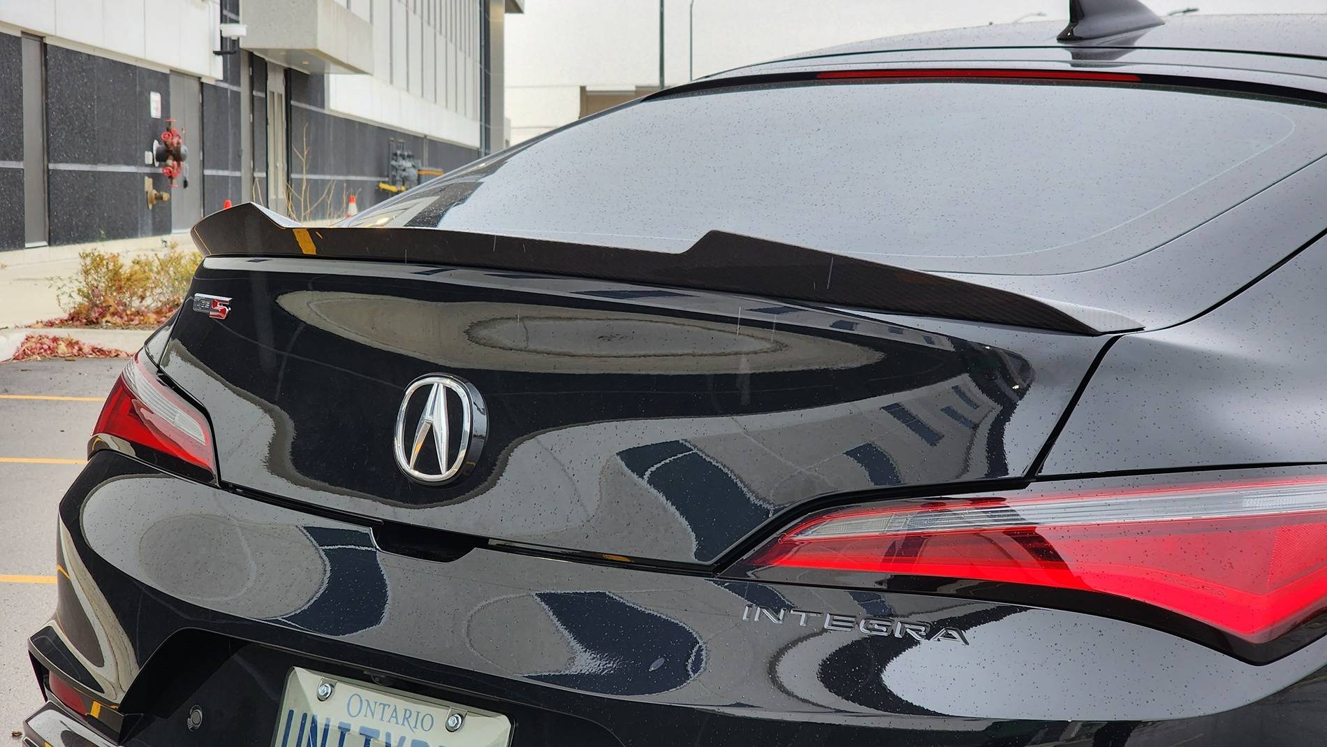

G4werkz Carbon Trunk Spoiler
The Trunk Spoiler went on beautifully, no issues with fitment and excellent product quality. We did struggle a bit with the Bezels, only because of the APR Lip extends over the factory bumper. If you don't have the APR Lip, or get the G4werkz Lip instead you won't encounter fitment issues. Solved the fitment by adding an additional self-tapping screw at the bottom of the lip on each side to pull it back up. Won't say it's ideal but it'll work.
Overall impressed with G4werkz quality, and likely will switch over to the G4werkz Lip to display the full catalog as we are an authorized dealer :)

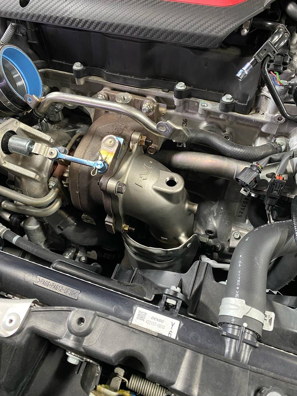

Just woke up the car from a long dreary winter spent in storage!

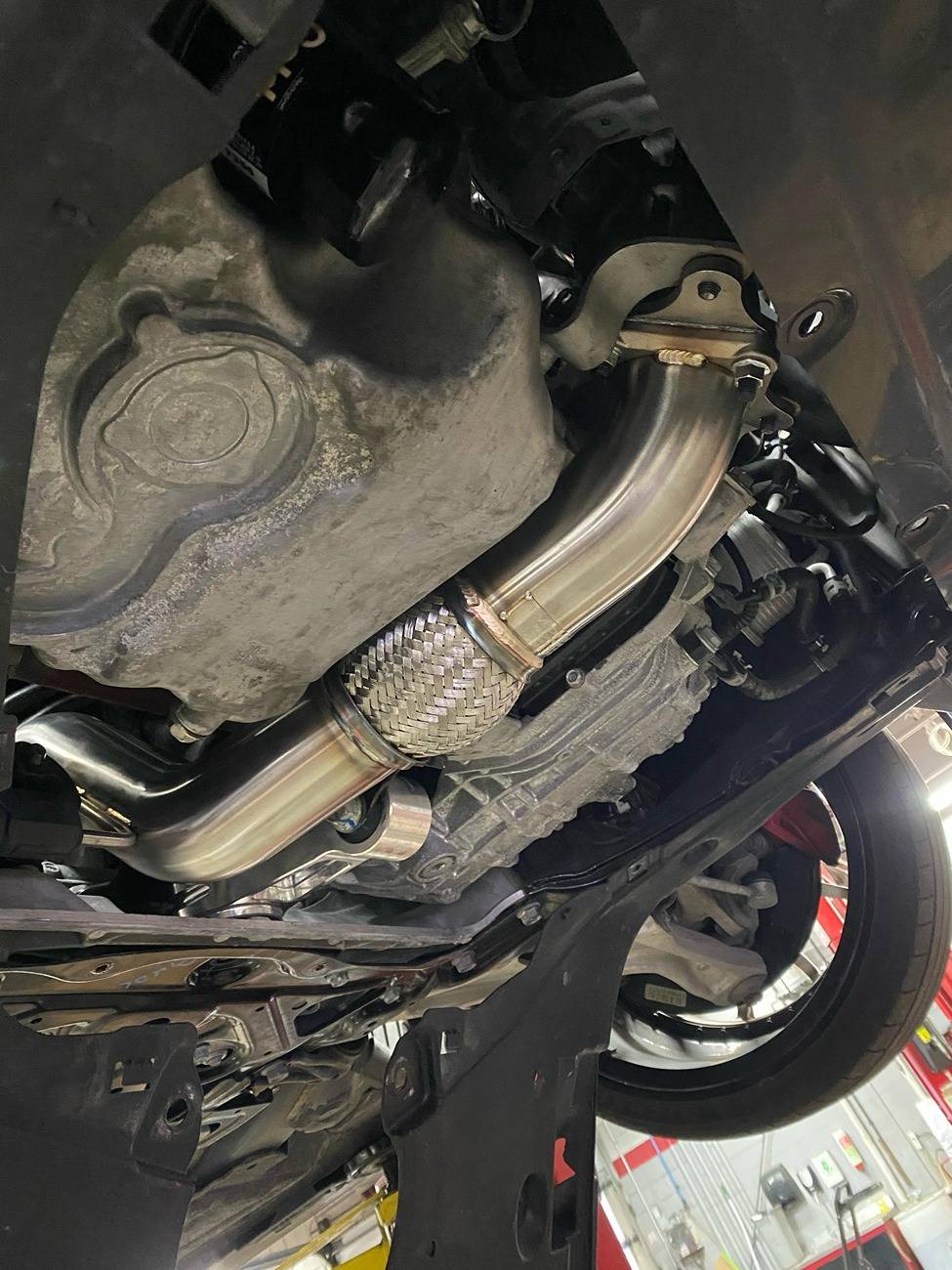

@Thusee had the car for a few days to perform the oil change, install the RV6 DP and Front Pipe. The ECU head been unlocked since last year, but not tuned yet as we wanted to see if an O2 Spacer with a mini catalytic converter built in could trick the ECU. It worked for 4 drive cycles and 30 miles, then when I did a WOT pull the dash lit up with the usual emissions code. No stress, it's time to tune, which we were going to anyway :)
Even without the tune the turbo spools up quicker, and it's gained a bunch of power. Exact amount is unverified since we won't dyno the car just yet.
LINK to RV6 products:
Catted Downpipe
Front Pipe

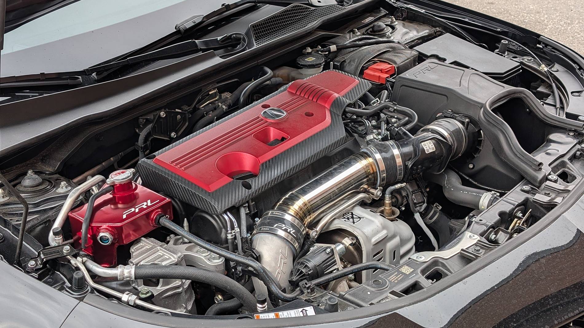

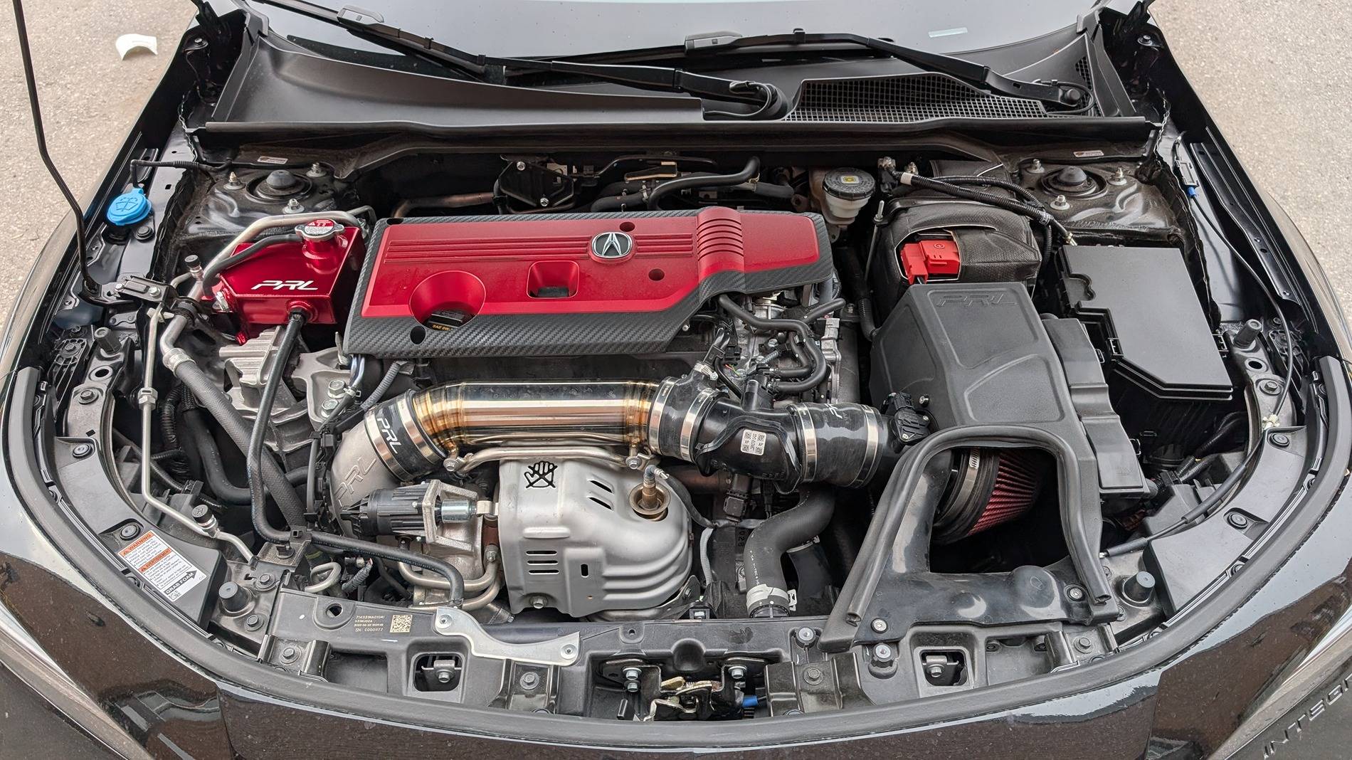

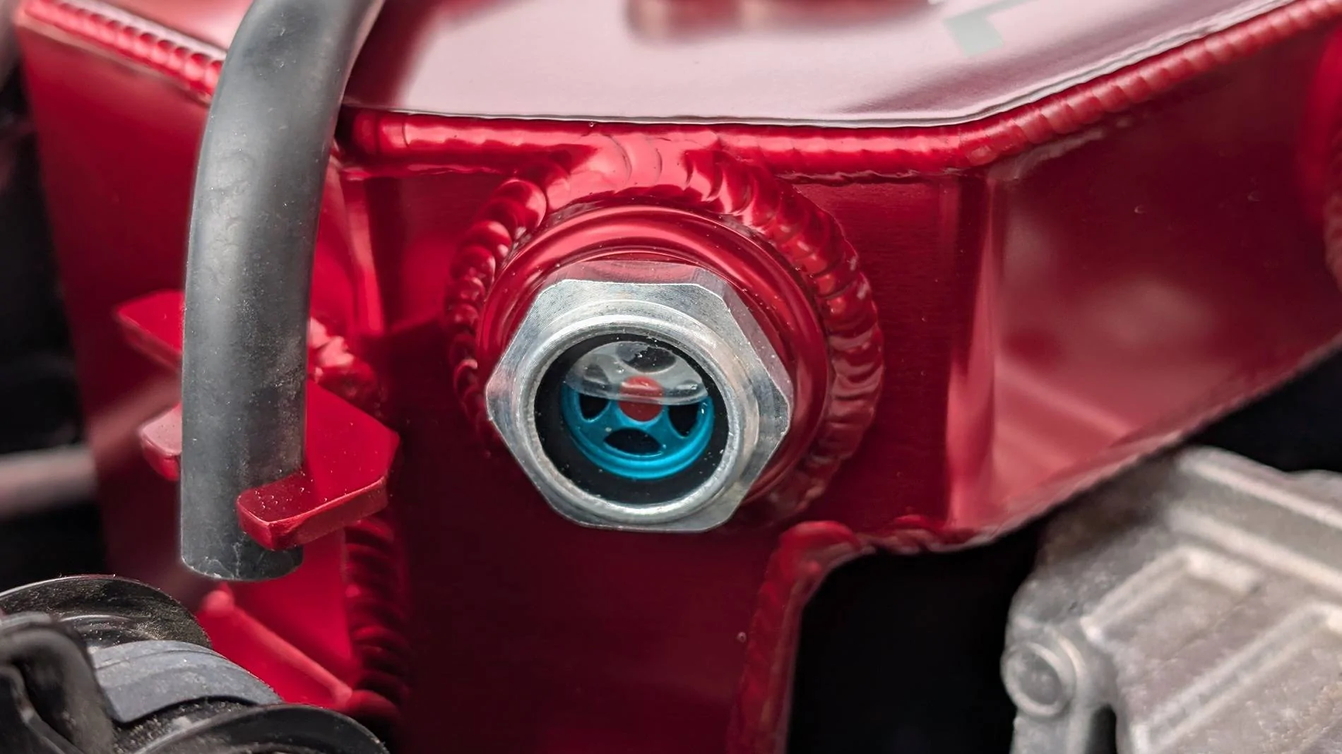

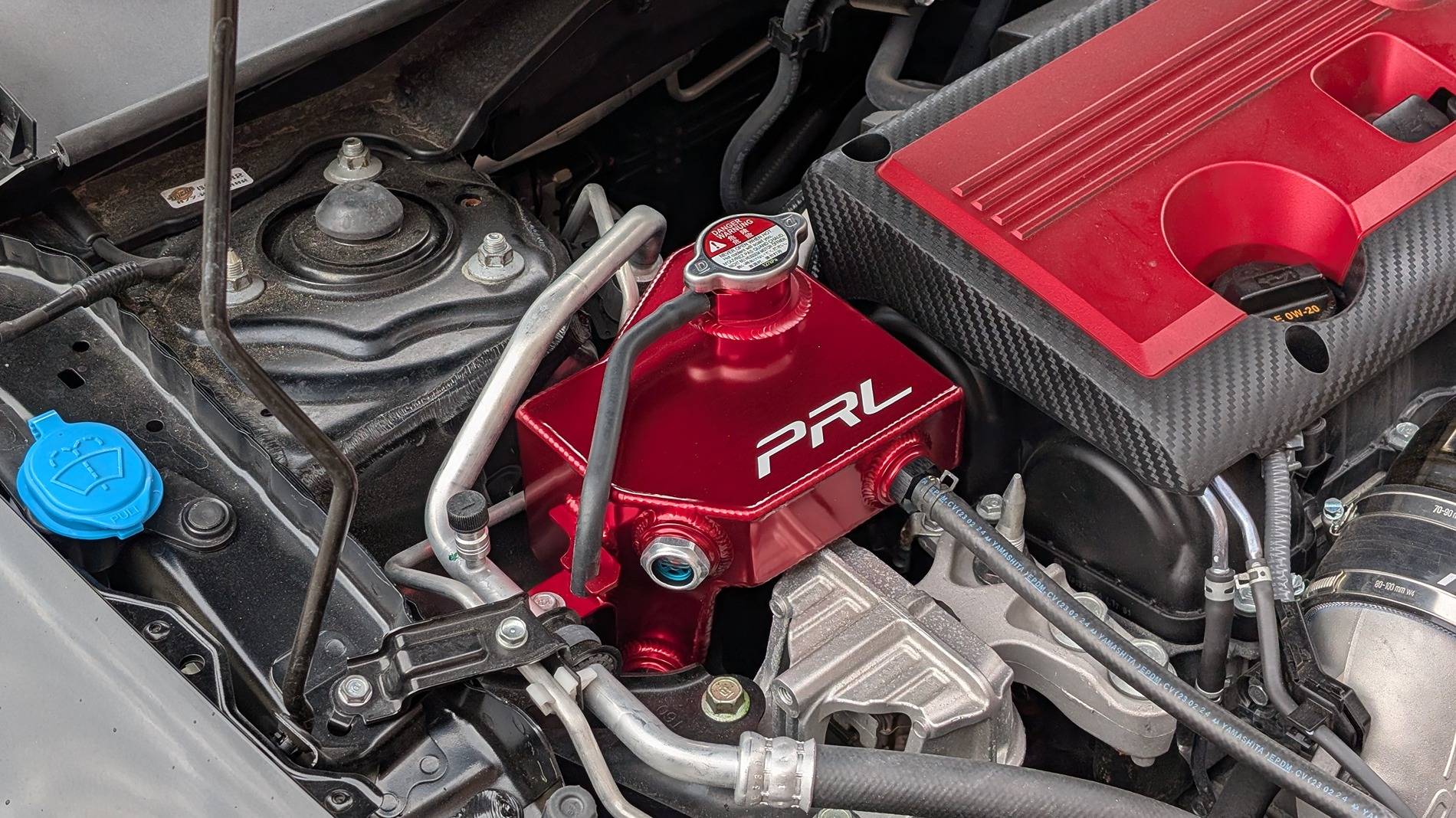

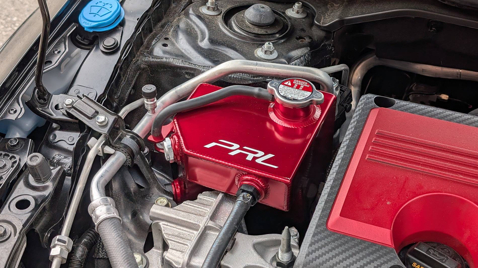

Small functional & aesthetic upgrade - PRL Coolant Overflow Tank :)
Since the factory unit is prone to cracks and leaking, this is a preemptive mod that looks nice to the eyes as well. The sight glass is a nice touch.
