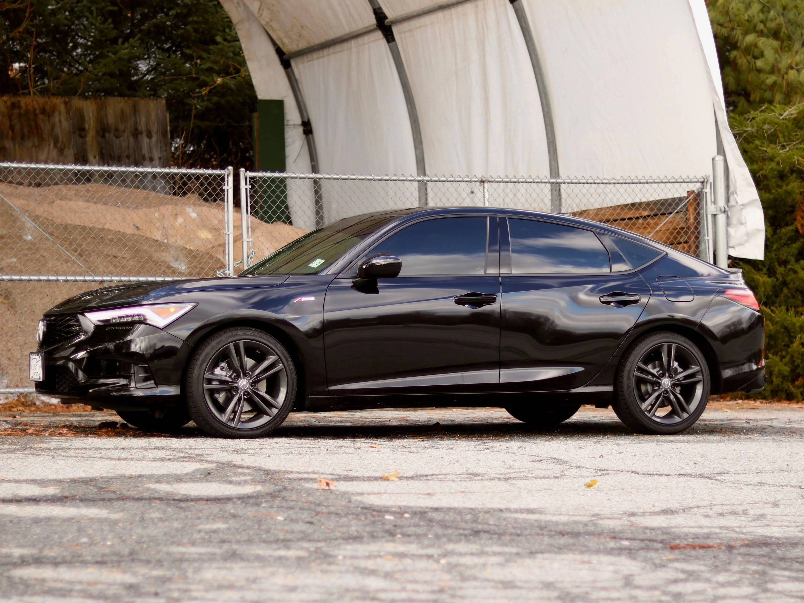

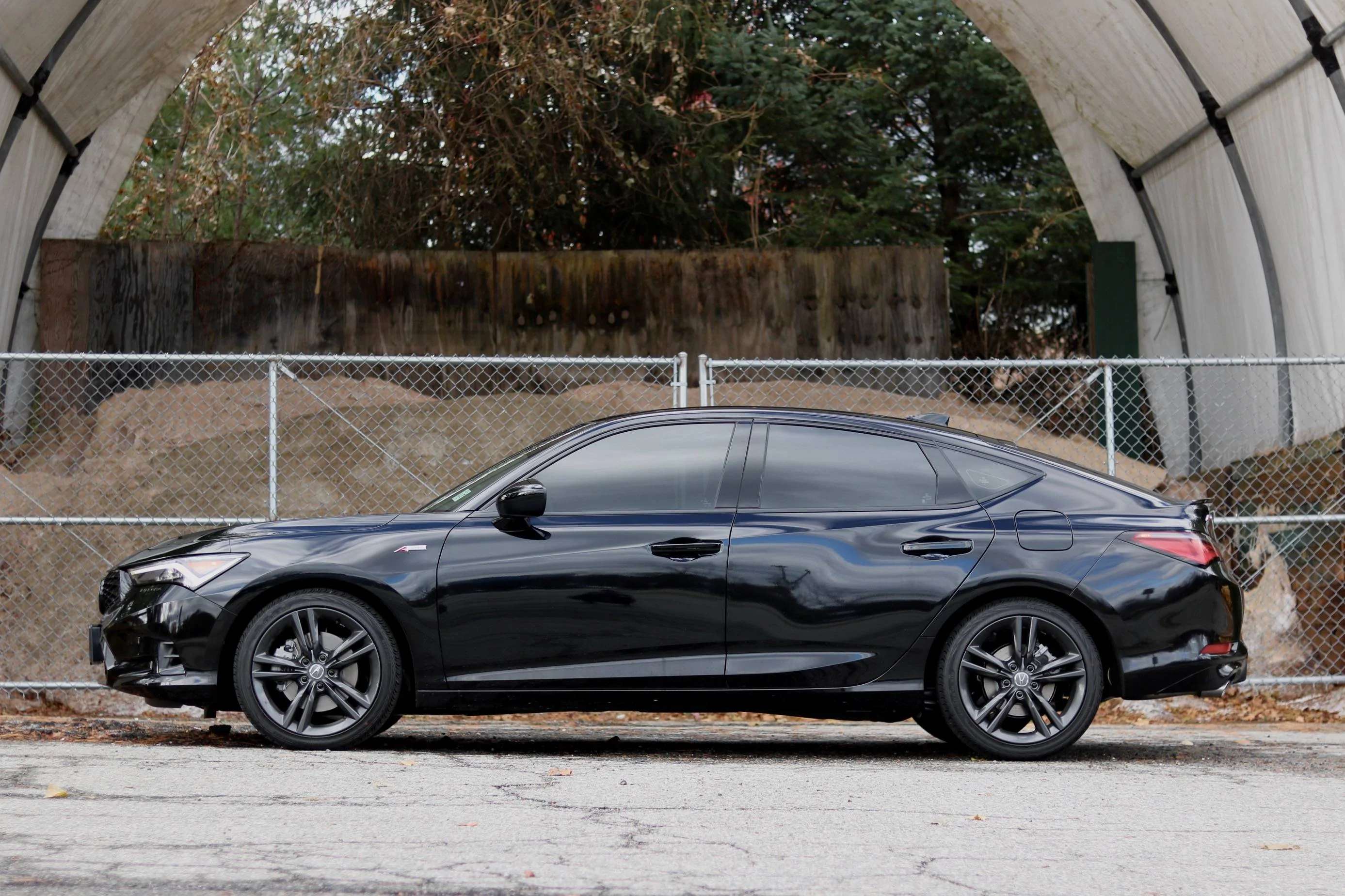

11/26/2022 - Tints
Local tint business installed 20% tint on all windows (except windshield). Sun strip added for the front windshield.
Overall, it was a simple and professional experience; no visible complaints with the quality of work done. My impressions are that they run an honest business, as they explained to me the dangers of tinting the front windshield with a car that has a lot of 'tech' built in. Due to this transparency alone, I recommend them for those in the Northern New Jersey area.

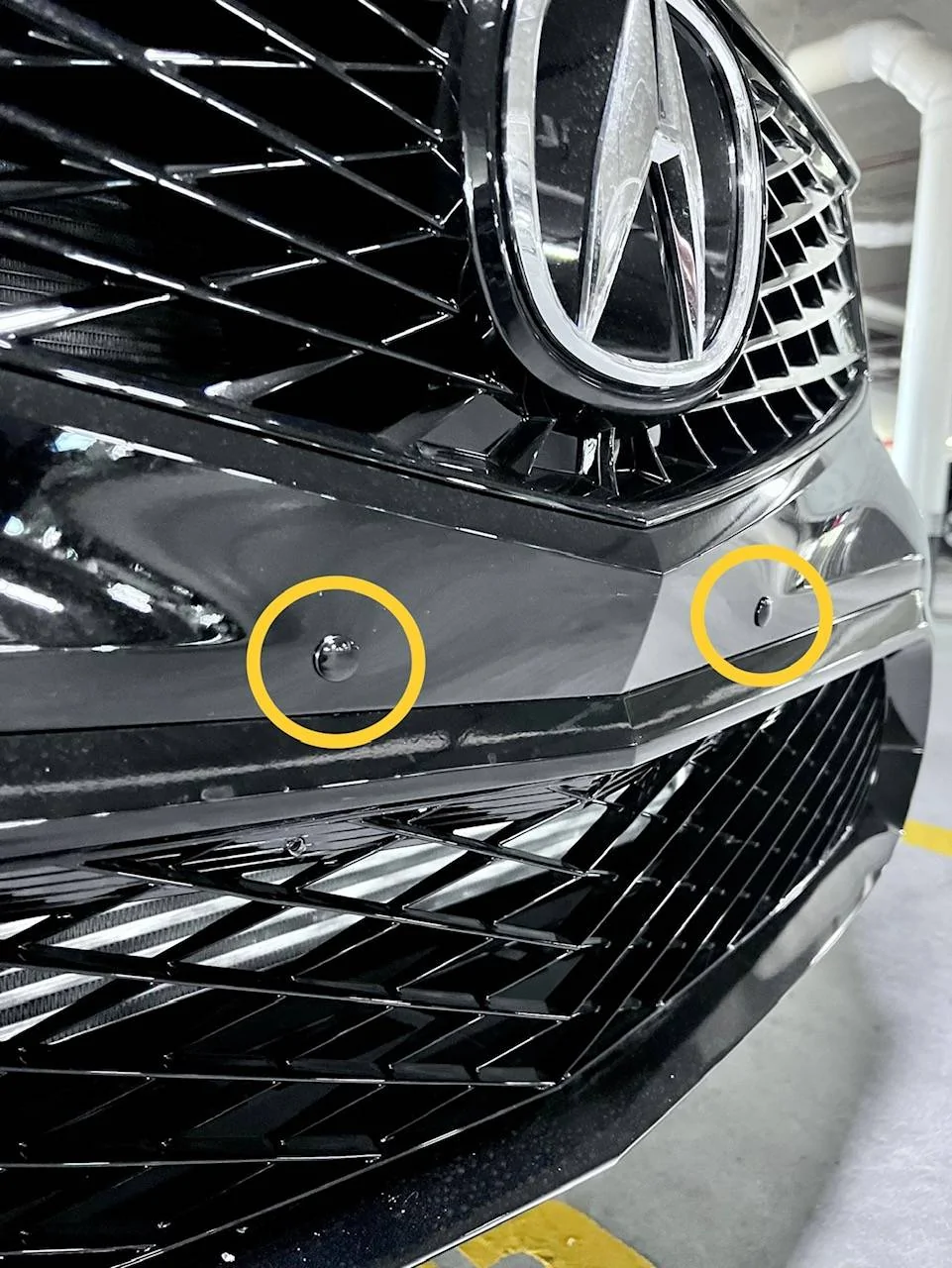

11/30/2022 - Bumper Plugs
Installed a set of painted (Majestic Black - NH893P) bumper plugs to cover up the front license plate holes. Simple install, however, drilling the holes to 9/32" was required. This was expected as per the instructions.
BumperPlugs.com

Want to see how your build turns out, just placed an order for those bumper plugs and OEM window visors. I'm located in North Jersey as well!

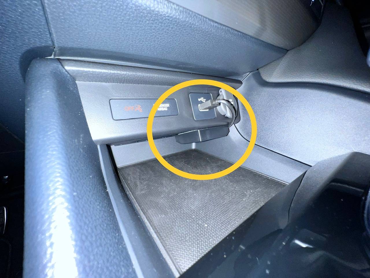

12/1/2022 - Wireless CarPlay Adapter
Ordered a wireless Apple CarPlay adapter from Amazon to make up for my non-tech model. It does the job without issues. Pairing was quick and my Phone 13 Pro Max connects immediately without any user input needed. I've spent the day driving around, and it has not dropped the connection nor needed me to fumble with my phone's settings. From start-up to being fully operational, it meets the advertised time of about 10 seconds. The unit comes with a short USB cable, which helped minimize the overall footprint. I managed to tuck the unit with some double sided tape to keep it from being an eye sore. My biggest gripe is with Acura's decision to not place the USB port in a more concealed or hidden space.

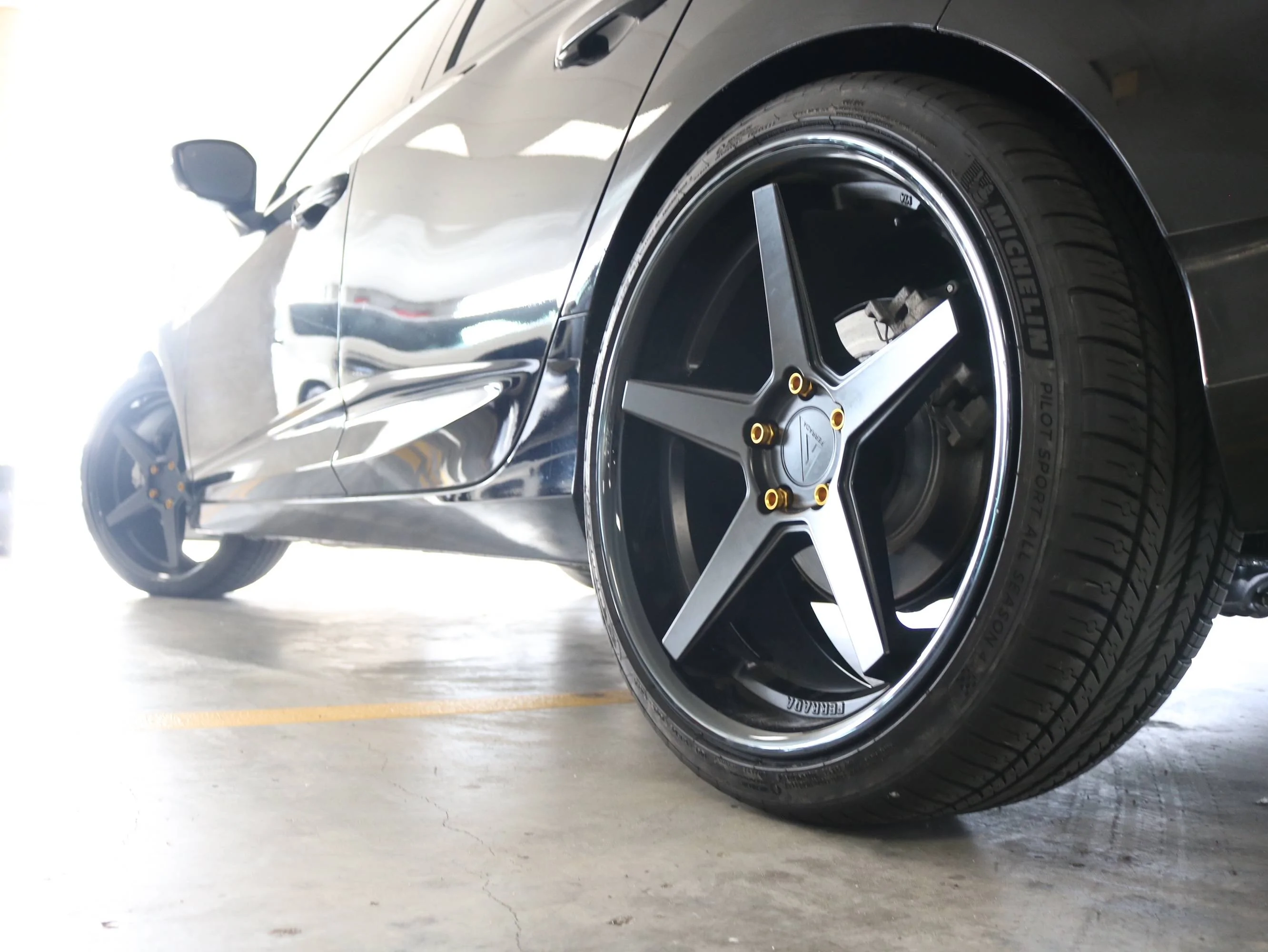

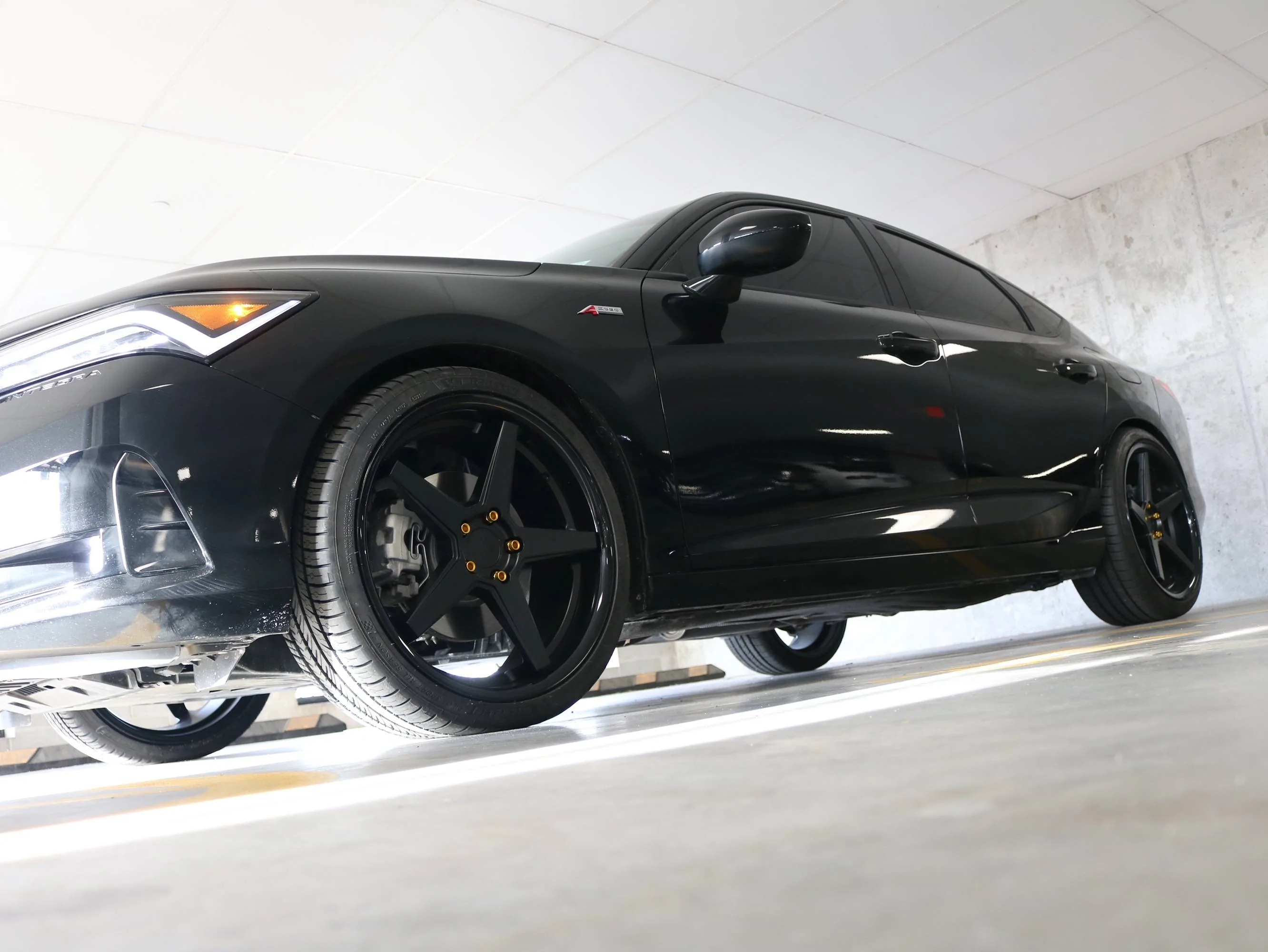

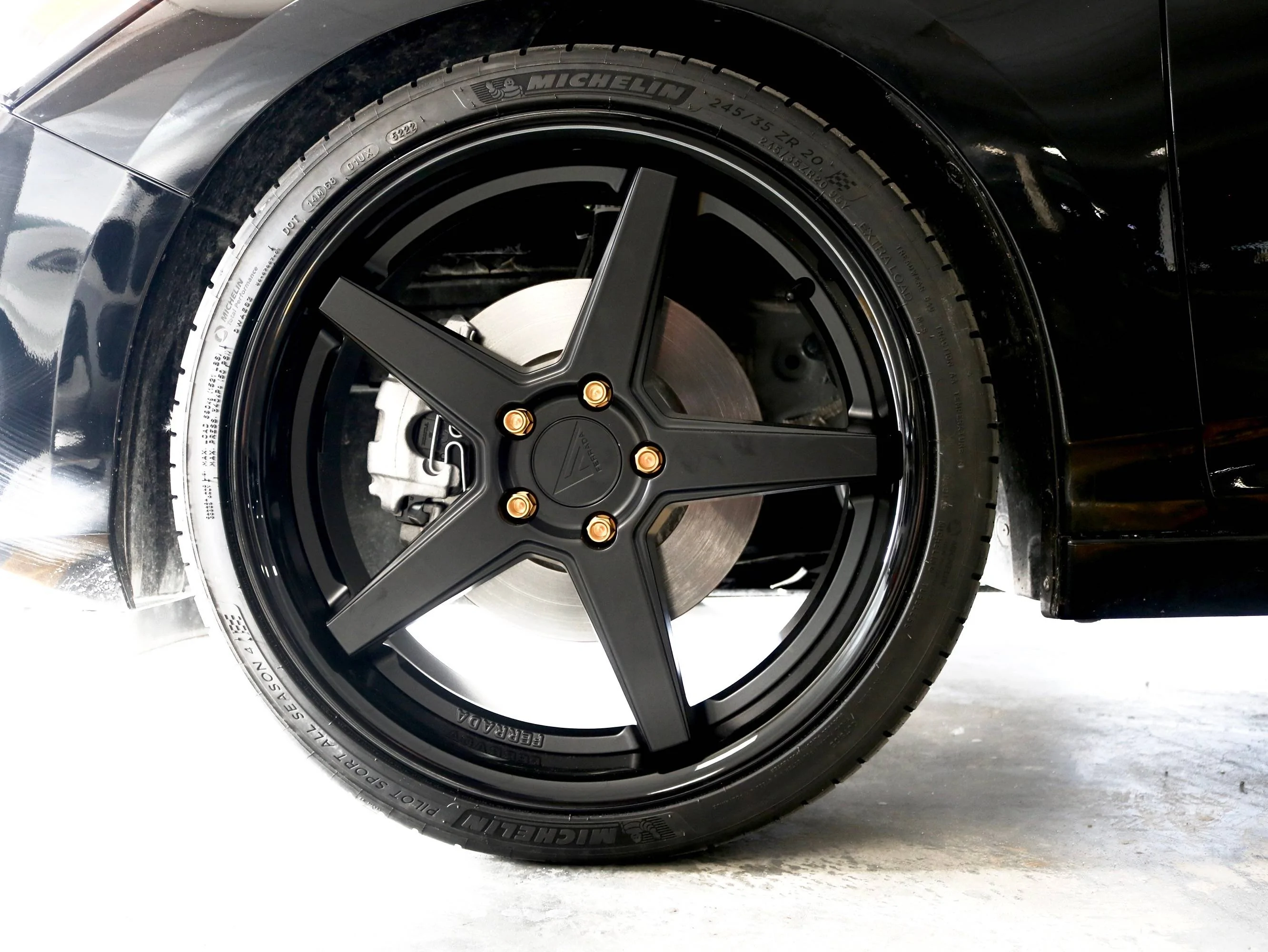

I was waiting to see what a new Integra with 20s was going to look like. Overall it looks good.
Personally, I would have gone with 245/30/20 to give it a similar overall diameter than stock. It also raises the body of the car by 4.9mm, but it reduces the wheel gap by 4.9mm also. Also, you are running a stretch in the back but not the front…so it actually makes your front look more meaty than your rears. Maybe should have gone with the 8.5s all around and run a small spacer since the 9.5s are a bit on the aggressive side.
Any plans to lower? if you do, the bigger diameter and lack of stretch in the front might cause rubbing on the front bumper tab.
773
988
2/1/2023 - Ferrada FR3 Wheels + Project Kics Lug Nuts
2x 20x8.5 +40mm (245/35/20)​
2x 20x9.5 +25mm (245/35/20)​
Project Kics Leggdura RL53 2-piece Shell​
Ferrada FR3 Wheels
Project Kics RL53 2-piece Shell
Those wheels look GREAT--any plan to upgrade to a big brake kit? Pricey modification, but those wheels show a lot of caliper--some colored calipers would really pop!

Hey,
Yes definitely planning to adjust the suspension next. Still waiting to save up to properly do it, as I was recommended that camber arms would be important to consider. I'm not really well versed in this stuff, so I stick to the advice of my local shop haha.

Hey,
Absolutely. I've been eye'ing the 27won 4pot kit and the wilwood 6pot kit. I have a vision, however part of me feels very strange for investing in a bbk before pushing for a little more oomph out of this little engine haha.
773
988
Totally understandable! I love the look of a big brake kit + it's an easier expense to justify because it's a "safety feature" after all, right? Who cares if it's more brake than necessary! Hahaha

No rubbing even at full turn. Overall, no noticeable issues. ☺
