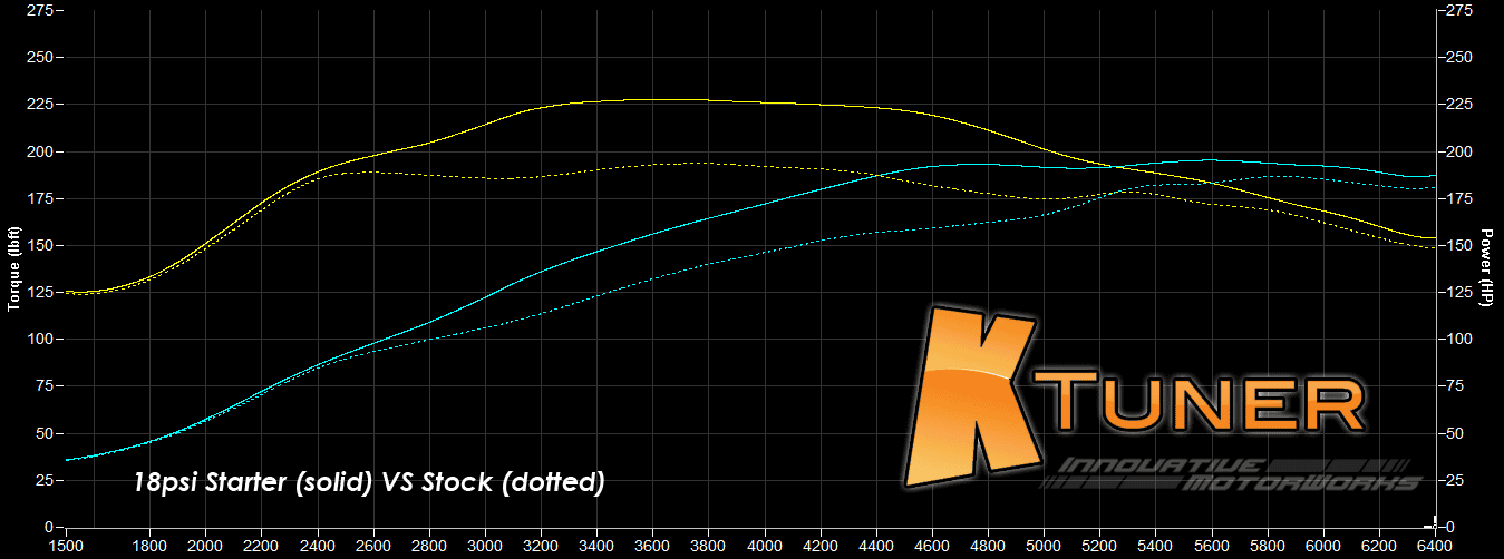

There's changes to tq and hp but the changes really kick in more in the low to mid range which is why I believe the 30-70 times were much better.
Acura Integra Stock vs Stage 1 Tune. 30-70 & 40-80 Tested 18psi_vs_Stock
If you take a look at ktuners graph the tq and hp start to diminish around 5500 rpm which means for everyday driving the tune is going to be noticeable but after 5500rpm the tune will sorta feel similar to stock. The cvt will behave just the same but in nutshell a tune even at 18psi will increase power and driveability especially in the low to mid range
