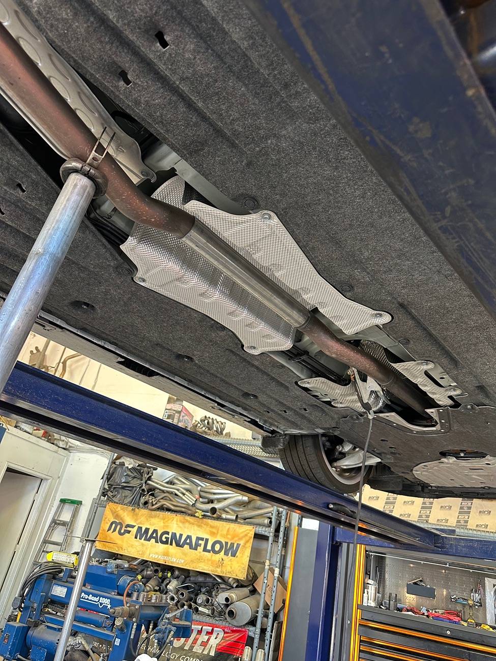

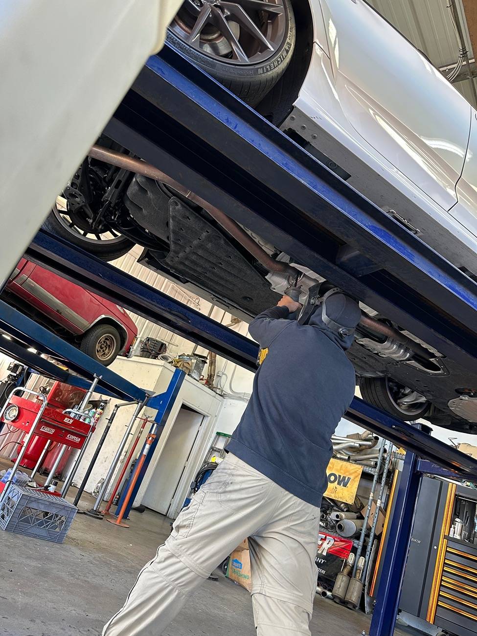

There was also another post on Facebook that I saw where they went to an exhaust shop and removed the resonator and replaced with straight pipe, a simpler cheaper approach. Link here:
Facebook Post Integra Type S Resonator Delete
Based on this post, I also did this mod at a local exhaust shop, cost $100. I’m very happy with the results, I use sport mode as default now because the exhaust note is louder and more enjoyable than before. Sport + is also louder as are the pops and bangs. Comfort mode sounds the same as before the resonator delete, so perfect for freeway cruising, no drone at all. Here are pics of my install (no sound clips, unfortunately, but the fb post has some) [ @edido if our NorCal meet happens next month you can hear it in person]
