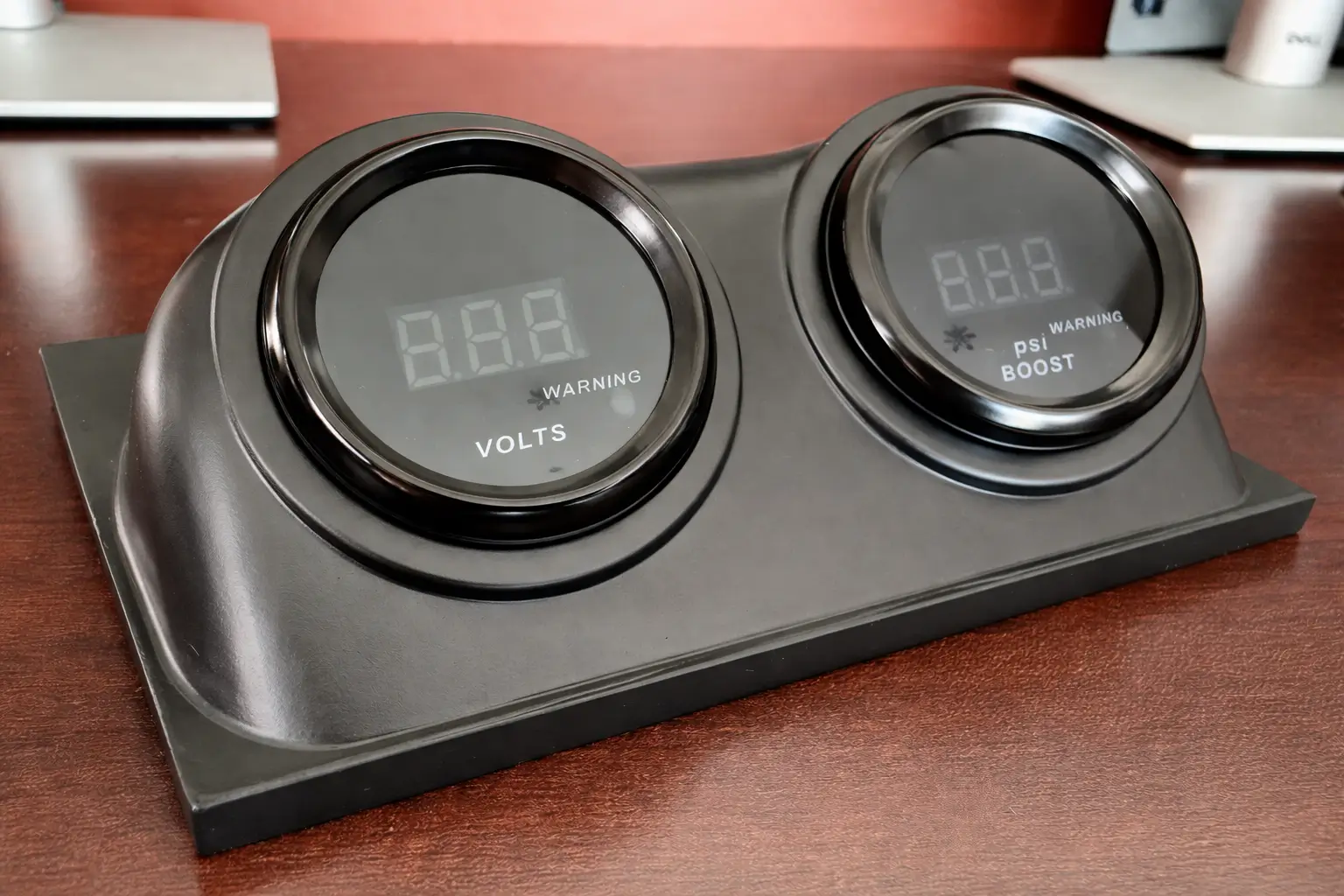

2 - Install the gauges into the gauge pod
Get them seated and aligned before moving on.
Acura Integra Integra Type-S / A-Spec Tech Gauge Pod – Limited Run Announcement 3 - Gauges in pod

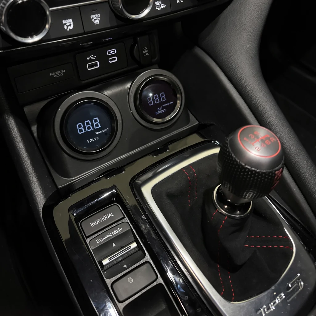

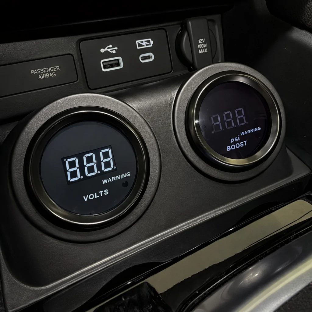

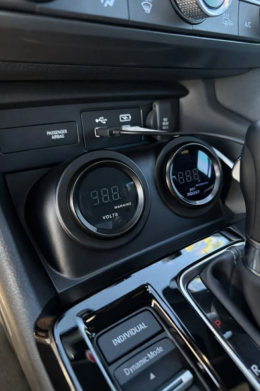

Everything lights up correctly and turns on and off with the car.
Acura Integra Integra Type-S / A-Spec Tech Gauge Pod – Limited Run Announcement 12 - Put it back together and enjoy
