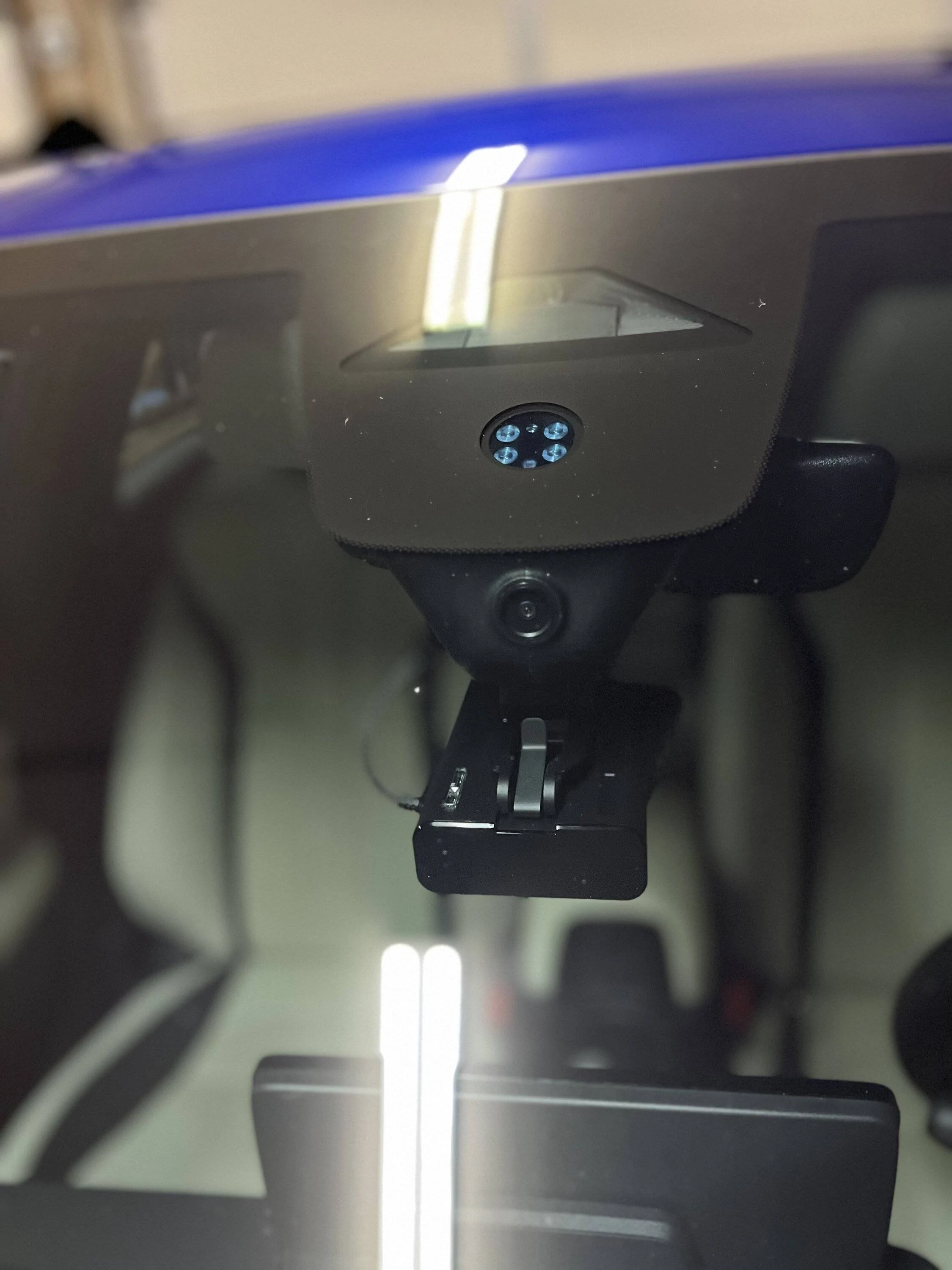

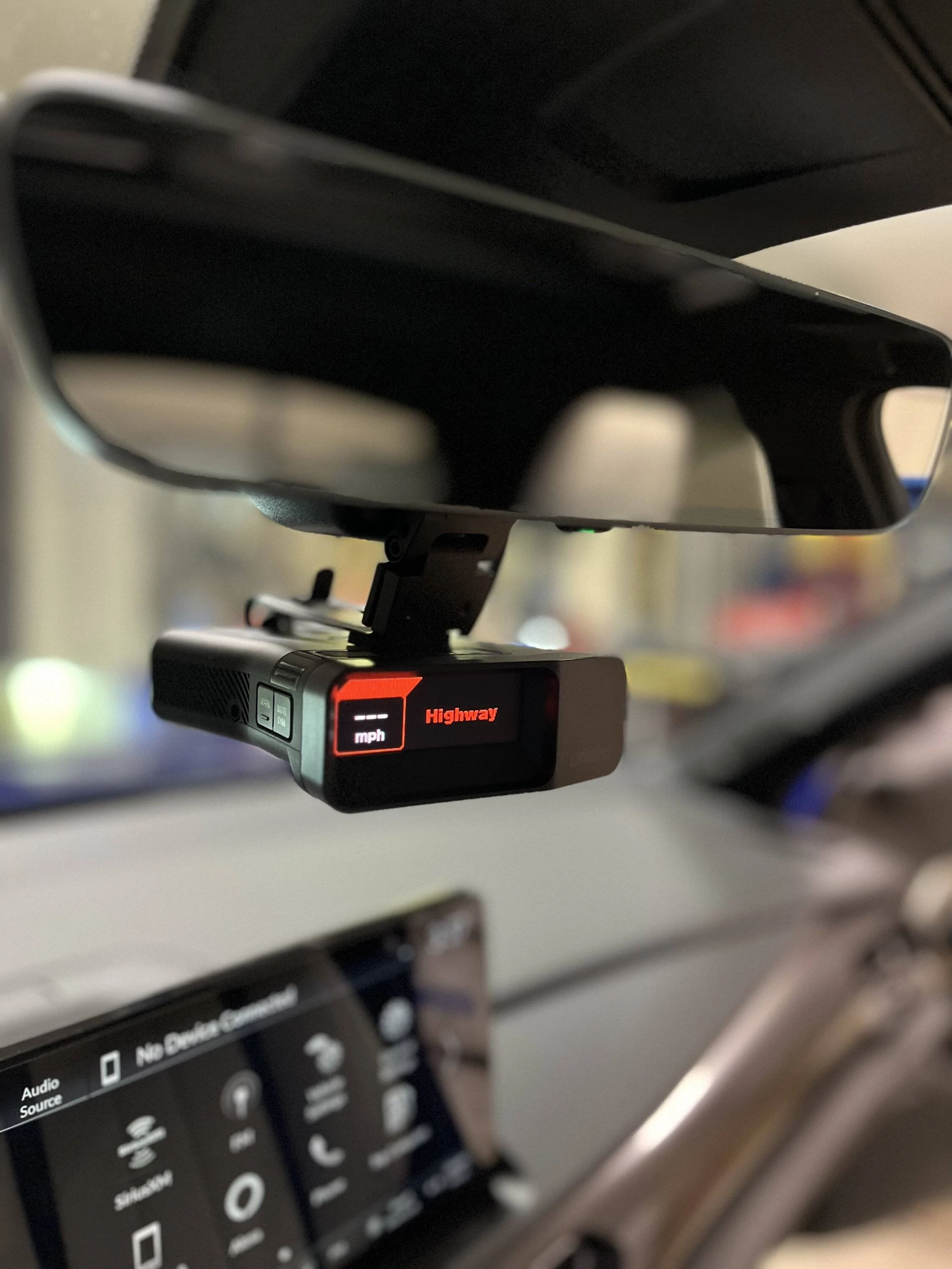

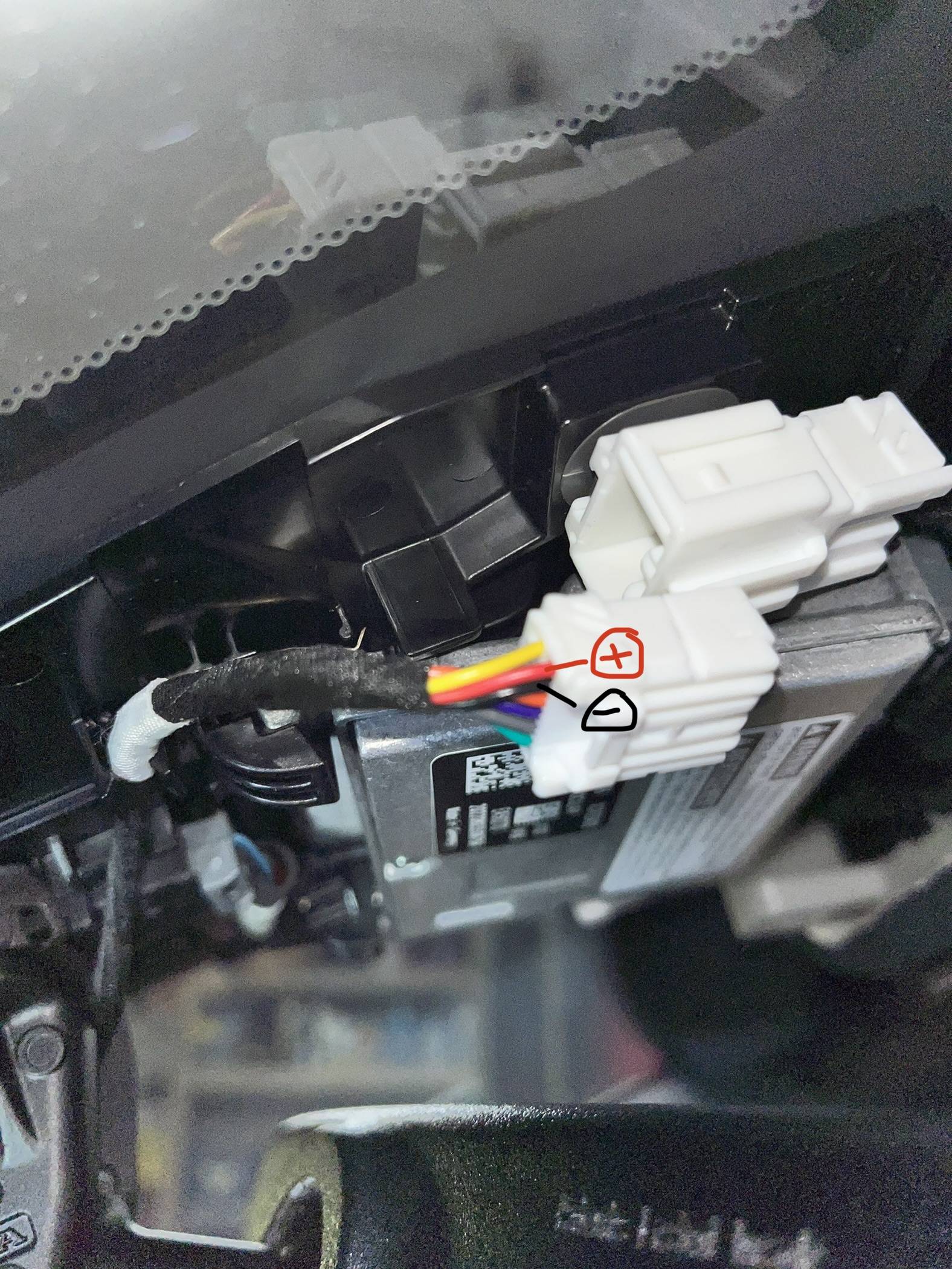

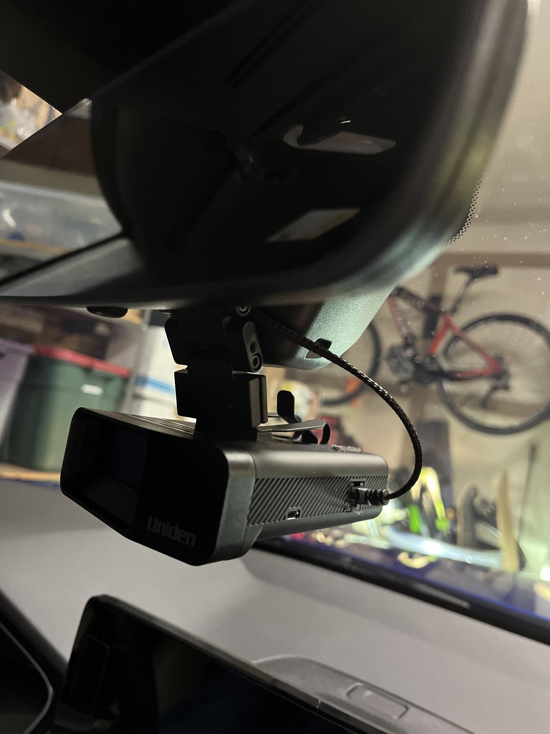

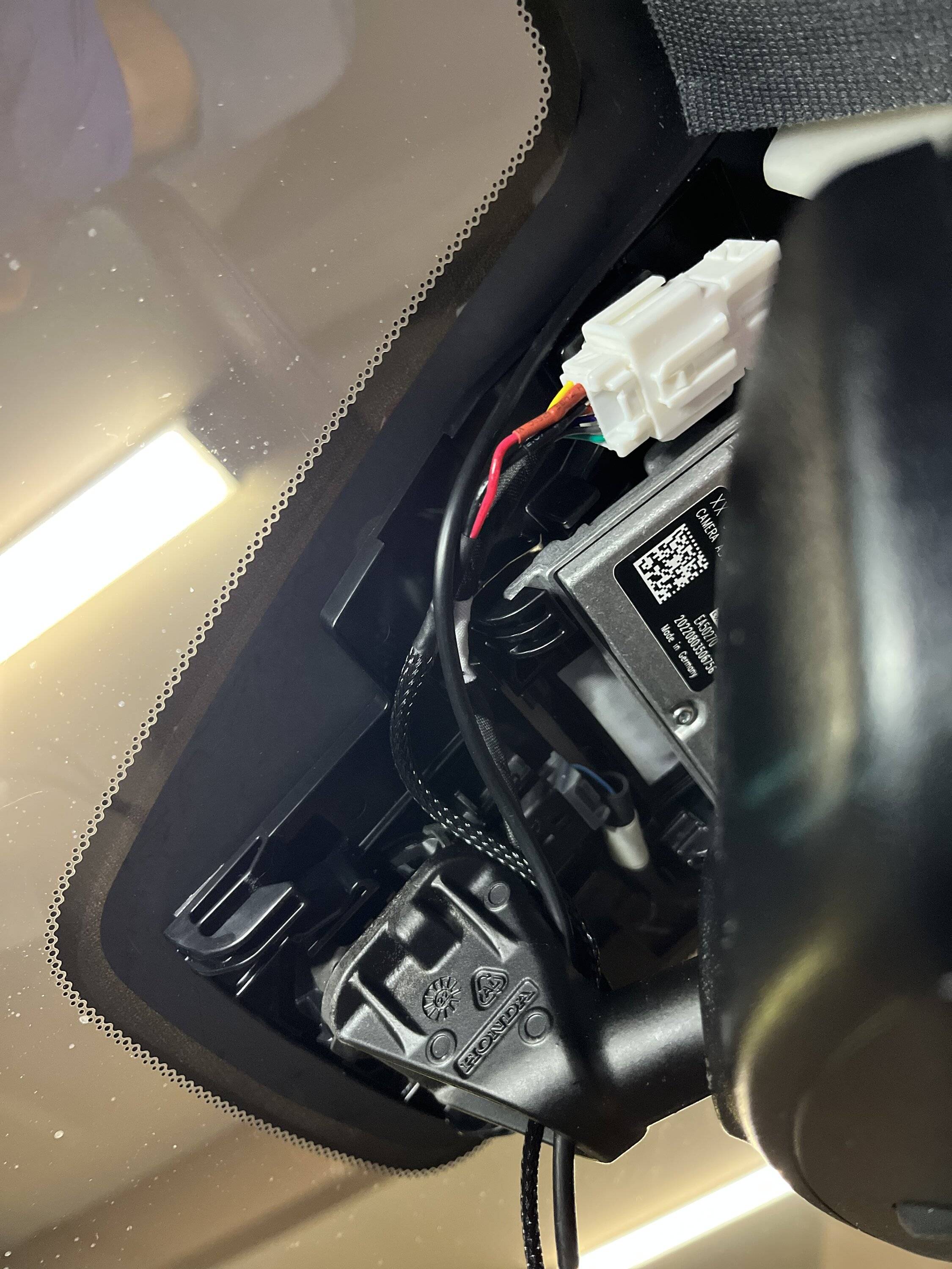

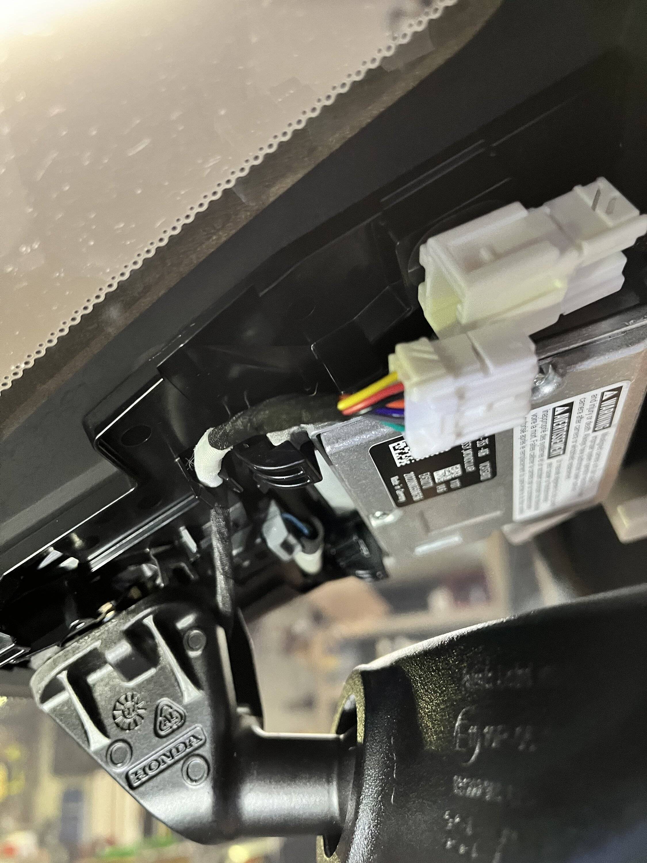

@RB2490 I got around installing the FitCAMX and Radar Detector.
FitCAMX: uses and adapter harness to split the power from an OEM connector behind the sunroof/map lights housing. It’s an easy install per this video.
Radar Detector: there’s a connector containing 12V power behind the plastic housing that covers the rear view mirror mount and front facing camera/sensors. Theres just barely enough room on the back of the connector to tap into the red and black wires. Use a mirror tap type of cable with the thinnest pins.

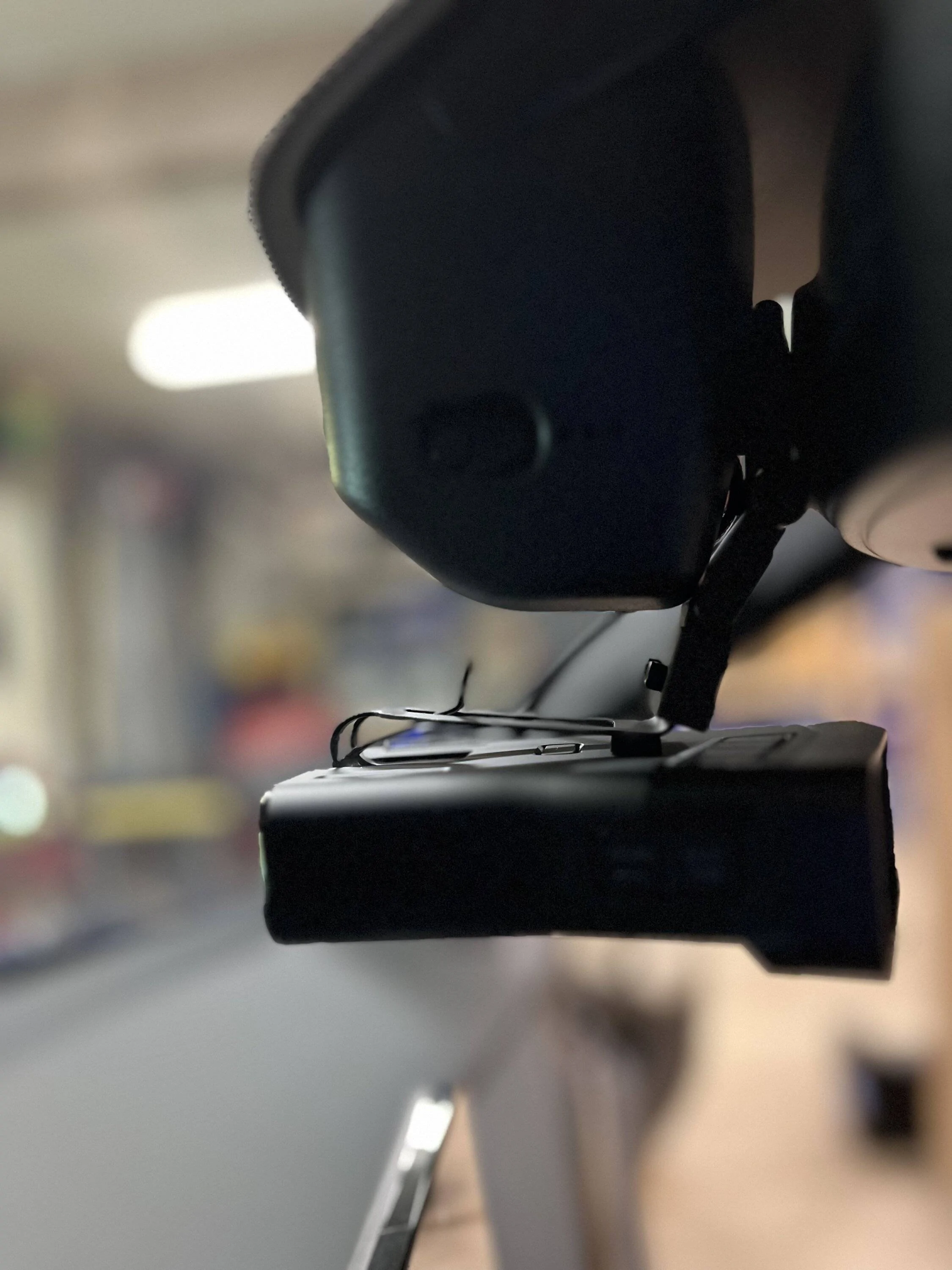

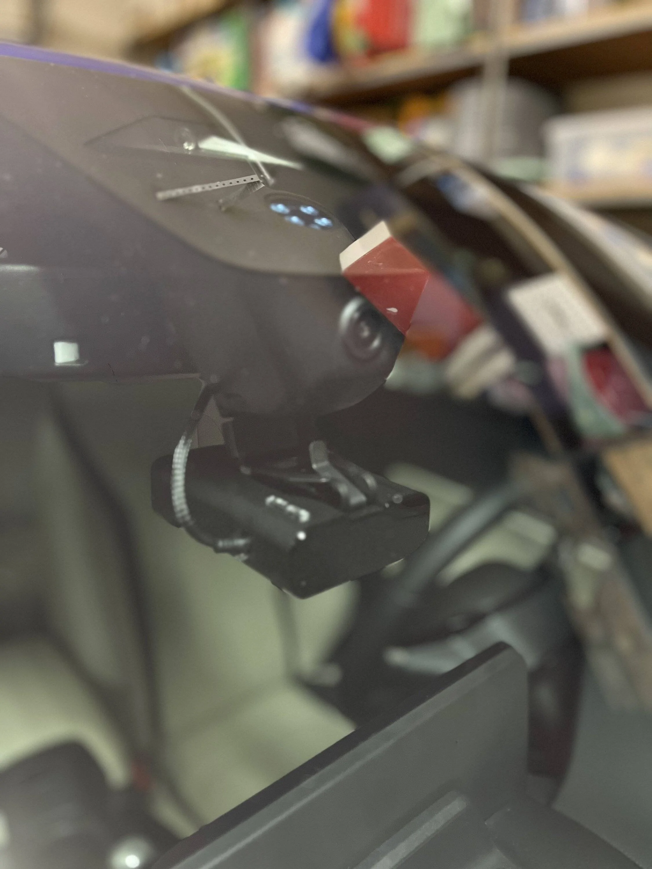

These mirror tap type of cables can be found on Amazon. I was able to tap into it for accessory power just fine. No need to use the Dongar USB power adaper or Micro USB-RJ11 cable. For the radar detector mount, I used one from Blendmount. I didn’t use the Acura Integra specific one because the FitCAMX camera housing was too tall it to extend below it. Instead, I used the one for 2022 Honda Civic and Uniden R7 (model# BR7-2001R) which gave me length to extend below the FitCAMX camera housing.

How much mirror mobility did you lose? I have both, but tbh I'd rather just buy their Extenders and use the Acura one to not lose maneuverability.
