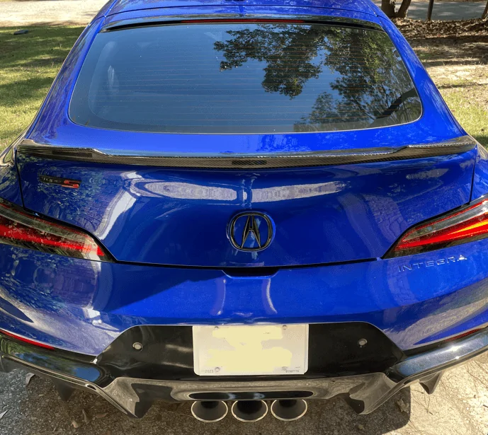

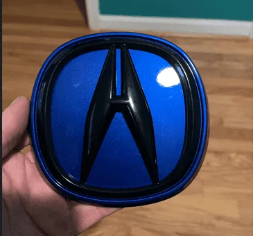

I purchased my accessories from AllDiscountParts.com and installed them myself today.
Black Type-S emblems
Front and Rear Black A emblems
Carbon Fiber Spoiler

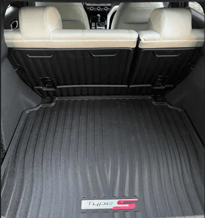

Type-s All season mats

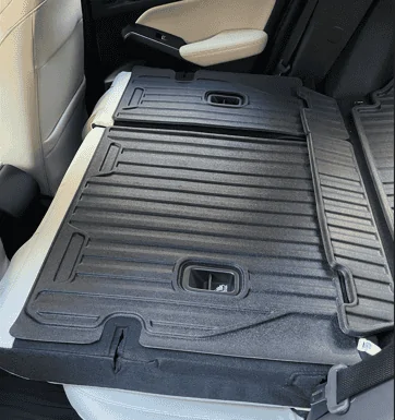

Seat back protectors
Type-s trunk Tray.
Took about 4 hours for everything Except the front A. (waiting to do that when I install PRL intercooler so I only have to remove bumper once..)

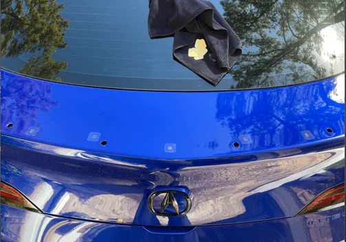

I was a little apprehensive about drilling the holes in the trunk, but it was not bad at all, and I am glad I didn't pay the ridiculous amount the dealership quoted.
notes to anyone doing this themselves..
Dropped the clips twice into the hatch frame. grommets near the hinges can be removed to fish them out since you can't turn the car upside down. 😏

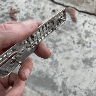

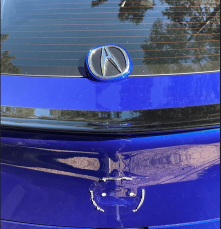

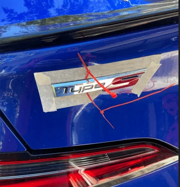

Front Type-s emblem on the grill has POSTs in it so had to heat it carefully as to not melt grill and the gently pried it off.

Do you think the accessorie carbon fiber spoiler would be secure enough without drilling the extra holes on the car?

OP stated drilling holes in the trunk. I believe it was done as the dealer would do based on the description provided.

I suspect it could be installed with 3M adhesive only, especially if you use 3m's adhesive promoter. That stuff really makes the bond hold well.

Oh its plenty possible to make an adhesive that would work just fine. If you want alternatives let me know 😉 I might be able to work out a new project

you sure can use just use the tape if you want BUT>>>>> what if 3,6 or 10 years down the road after hots/colds and weather wearing the glue comes loose.. your spoiler will definitely be toast as opposed to it being anchored you can simply add more adhesive. just my thoughts on trying to keep a 725 dollar part on the car long term.
