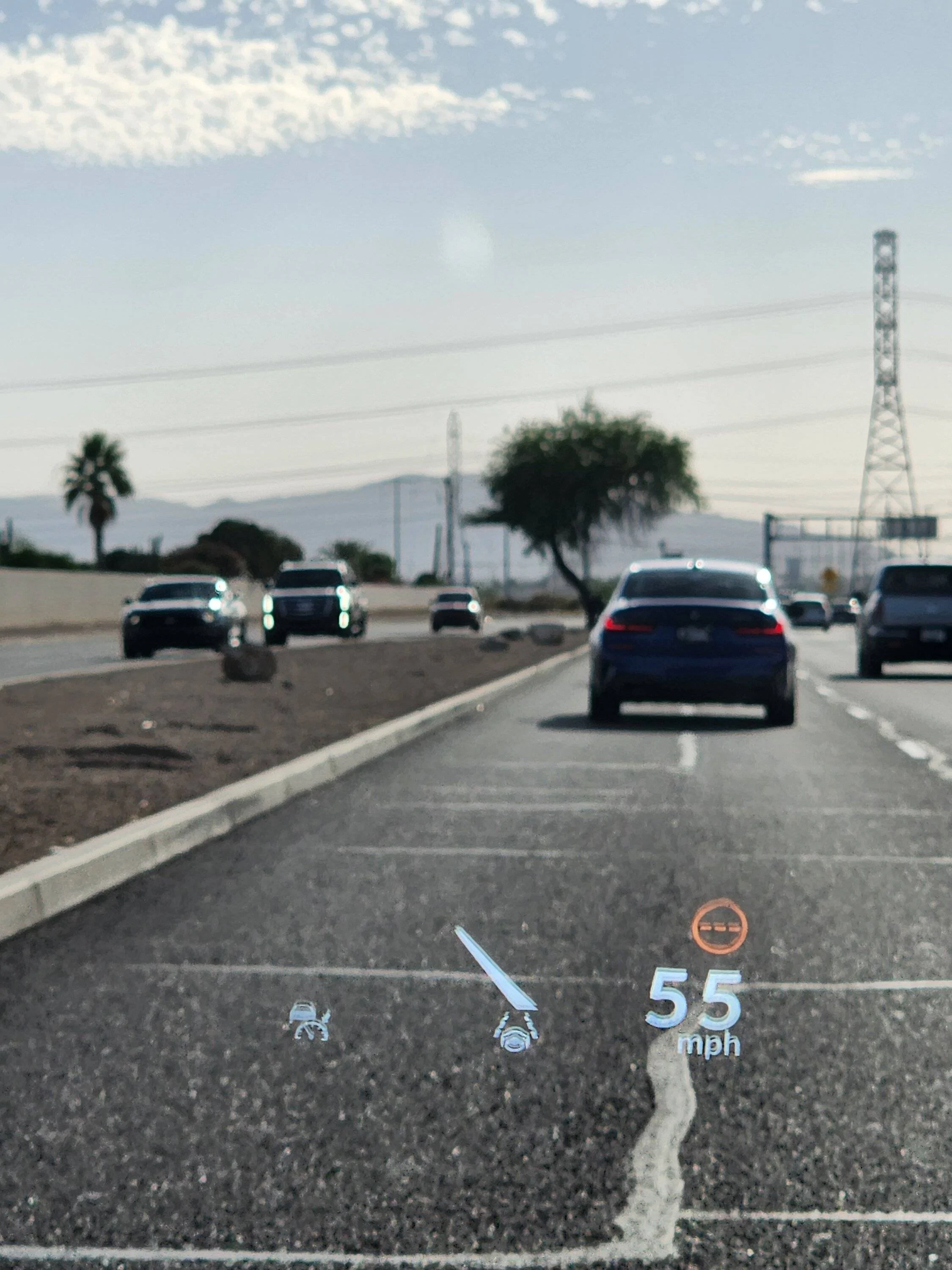

There's a orange circle where the spped signs show in the picture. The hud display stopped reading the mph from street signs about a week ago I have almost 30k miles on it bought brand new and hondata tuned after 1 week of ownership. It just stopped I don't know why so I took it into the dealer today and the service manager says it's because I redline it and it's over boosted. I don't know what he meant by that I drive it hard but I'm like there's 30k miles on it and I've been driving it the same way for over a year. There solution was to factory reset the car. They test drove it and could not fix the problem after that said they have to talk to Acura and do more testing. I'll be bringing it back this Thursday. I got back in the car to check if the tune got erased and it didn't so I'm wondering if I re do the tune of that might fix the issue or should I just leave it up to the dealer to try and find out why it's not showing up anymore.

Makes zero sense that the sign recognition would have anything to do with how you drove the car. Thats a bad service department deflecting their diagnostic short coming on you.
I assume the windshield in front of the camera is clear debris.

I have my HUD turned off as I find it an annoyance but the speed limit sign still appears on my center display. Is it off there on yours as well?

Yeah it is it's a brand new windshield I'm on the 3rd one.
Yeah its off in the dash as well

Did it start right after the brand new windshield? The camera needs calibrated with each windshield replacement.

No it happened well after months after and this is my 3rd windshield replacement live in Arizona so rock chips are a plenty here. Also replaced the sunroof because of rock chips

I noticed loading a Flashpro tune that after it was done loading to the car my parking sensors would be off and I would have to turn it back on again. Did you try and return the car to stock to see if the problem still exists? If it does then you'd tell Hondata with the problem so they can push out an update for your specific problem

Not yet I'm waiting for the dealer to let me know. I'll have it back today dropped it off this morning

Does the MPH display on the instrument cluster? Might be a canbus issue

Acura says there's no codes or issues so they are going to replace the windshield camera which is on back order eta to be determined. Hopefully that fixes the is

Then yeah if it’s not showing on the cluster then points to the camera being the culprit.
Stupid question but something I would attempt if you brought it to me, in the radio settings you can turn the speed limit sign off/on (doubt it’ll fix it but with how glitchy car tech can be now a days, can’t rule it out). If your mechanically inclined disconnecting the battery is also a good option also.

The dealer reset the car the 1st day I brought it in so I had to re do all my connections and setting up like a new car again I also before bringing it in turned off and on the settings in the system settings that didn't work either.
