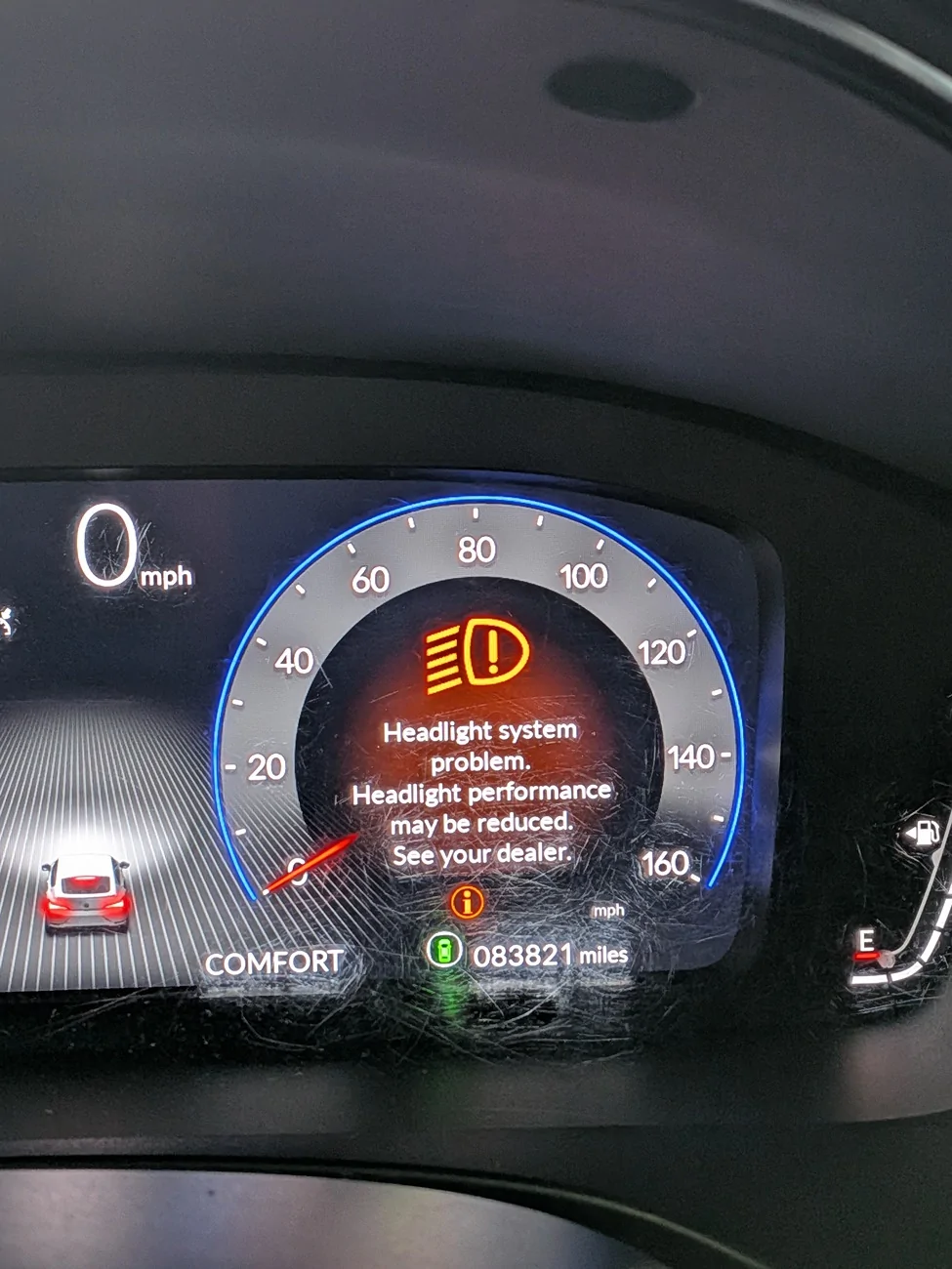

I had a headlight go out, and replaced it. Everything is working great, but I am now getting this error on my dash. Will a ODB scanner paired with the Torque app be able to clear this? Or will I need to go to a dealership?

It's most likely going to be a B(ody) or U(network/communication) fault code, which I don't believe (unless I'm mistaken) TorquePro has the ability to read or clear. You'll need a better scan tool. I've got an Autel Maxisys that will do it, but it wasn't cheap and isn't something an average DIYer has in their garage. There are (much) cheaper options.

I ended up unplugging the negative terminal for an hour or so, and that seemed to clear it after driving the car once or twice. Thanks for your reply!
