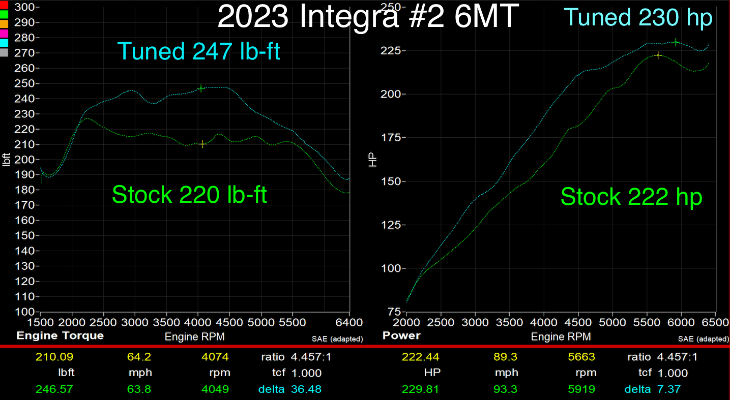

We dyned tested a second Integra. The temperature was a little warmer than the first and the fuel was unknown. Useful information though. Testing is so important to bring you the highest quality products.

Still a nice improvement. I notice this car suffers from heat. On hot days I can actually feel some power loss. Curious to see what this car dynos when the temps are cooler

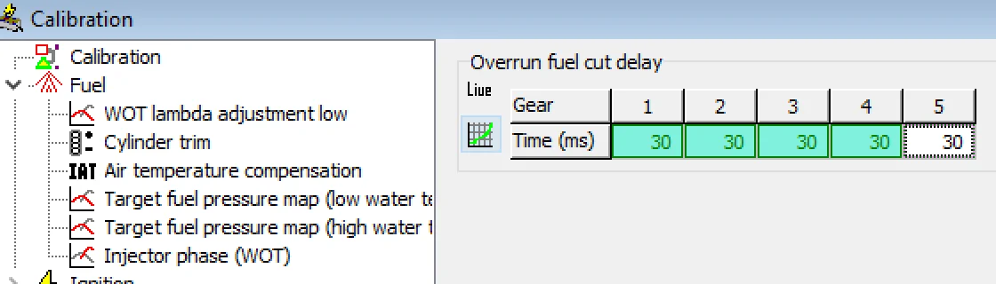

2. Rev Hang. It looks like Hondata can tune it away, or at least reduce it, so that's good. I was going to ask about flat foot shifting, but the Googlez had the answer. It seems similar to what the quick shifter on my motorcycle allows me to do. Seems okay, but would be much more fun if the Integra had a sequential shift transmission. ;)

No Jailbreaking is needed. Just connect and upload a calibration. The calibration we provide is tuned to make the maximum torque (with a safety margin) within the capabilities of the stock clutch. So, it is a race tune, but tested in a stock daily driver Integra.
The CARB FlashPro does not allow changes to emissions related parameters like fuel and ignition, but you can change everything else. You can increase the boost and power though. We make the software freely downloadable so you can see for yourself.
The calibrations will automatically adjust to higher octane fuels and give more power.
