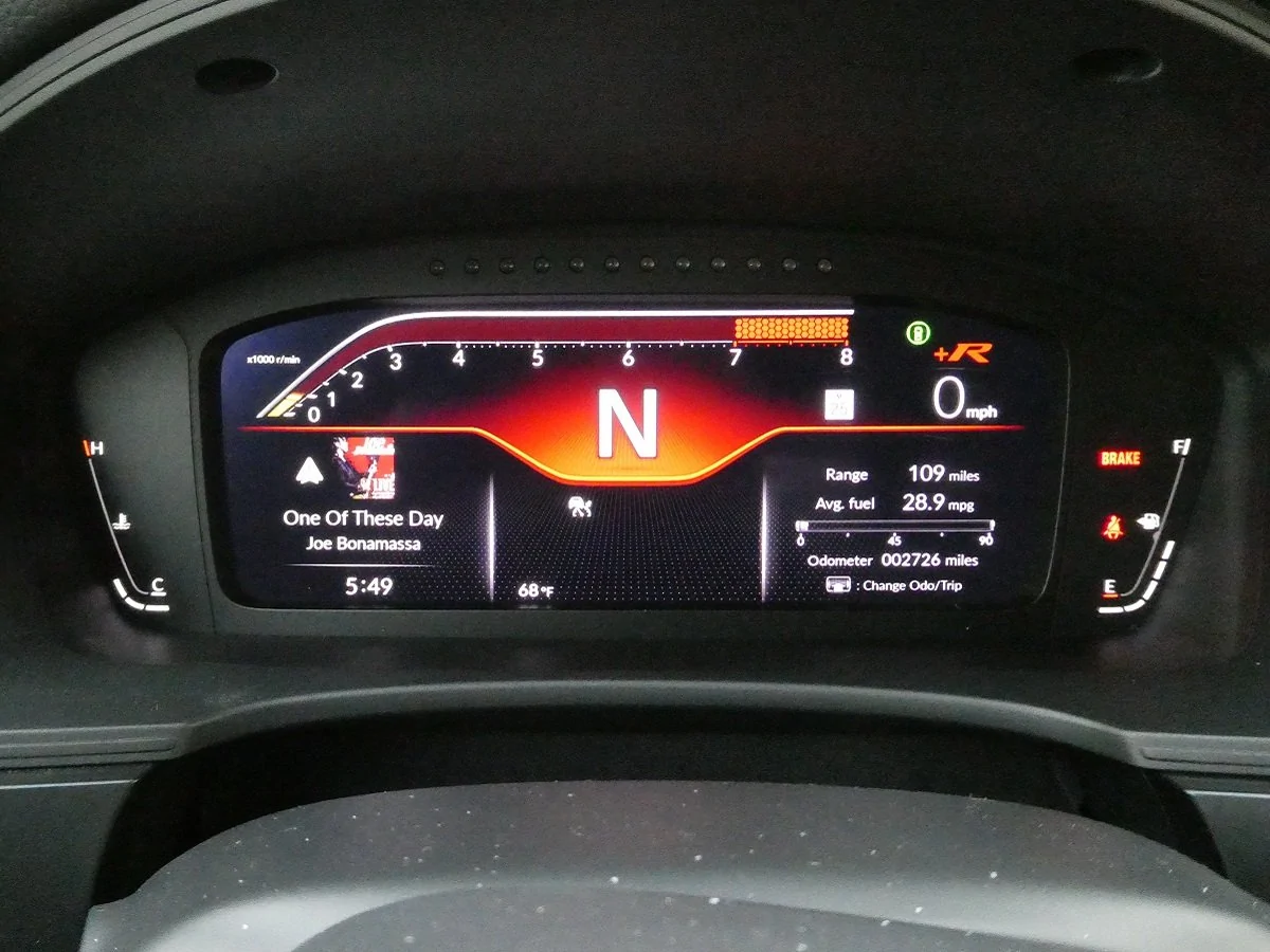

I don't know if many people are aware of the Type R dash in the 11th gen Civic but I adore it. It reminds me of the S2000. I don't even think the Integra Type S has it.
What would it need to be able to implement this onto an a-spec dash? Complete cluster swap?

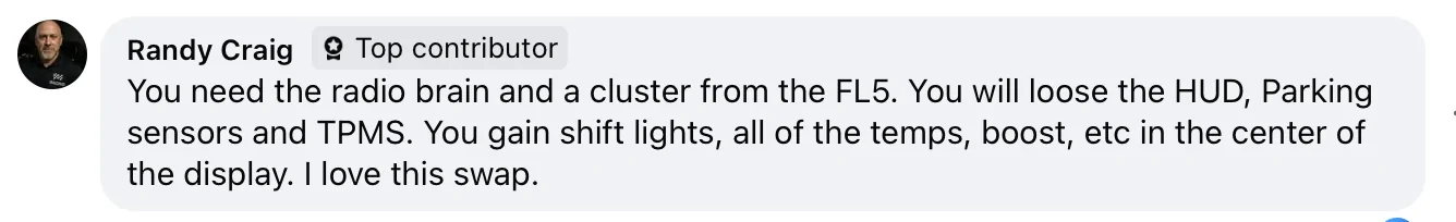

Someone swapped the FL5 cluster into a DE5 but it required additional supporting components. If I can find the link I’ll share it, but it’s fairly involved and costly (even if you can find the parts used).
Edit: It won't allow me to generate a link to the post on FB, but here are the details:

The screenshots of the Type R cluster are from +R mode, and there are a couple other graphics styles on the car (just like the Integra) that tie into the driving modes and can be set for Individual mode. It's all done in software, and controlled by a couple computer modules on the vehicle that run the various displays and infotainment. So it's not a simple display swap at all. In fact, the display is probably the dumbest component in the mix. @bisquick posted info on the same swap I know of.
I would think that if the firmware could be updated on the computer modules, there would be many possibilities. But I bet that is locked down tight by Honda.

Imo, what you lose is far worse than what you gain with the Fl5 cluster swap. I could care less about the HUD, but parking sensors and tpms (on low pro tires especially) are very useful.
The best approach here would be for someone to actually spend some time cracking the ecu and multimedia controller to make updates to the registries controlling the displays. It's doable, but no one has taken the time to do it right. On the VAG platform you can add displays from other platform twins or specials if you take the time and use a tool via obd. I added the sq7 displays to my wife's q7 for example. Should be doable on this platform if we could actually get some coding support from a bigger player, but that involves a bit of cash. I've reached out to a couple companies personally and the response I get is "the Honda platform doesn't seem to have the market for it" šŸ˜”.
