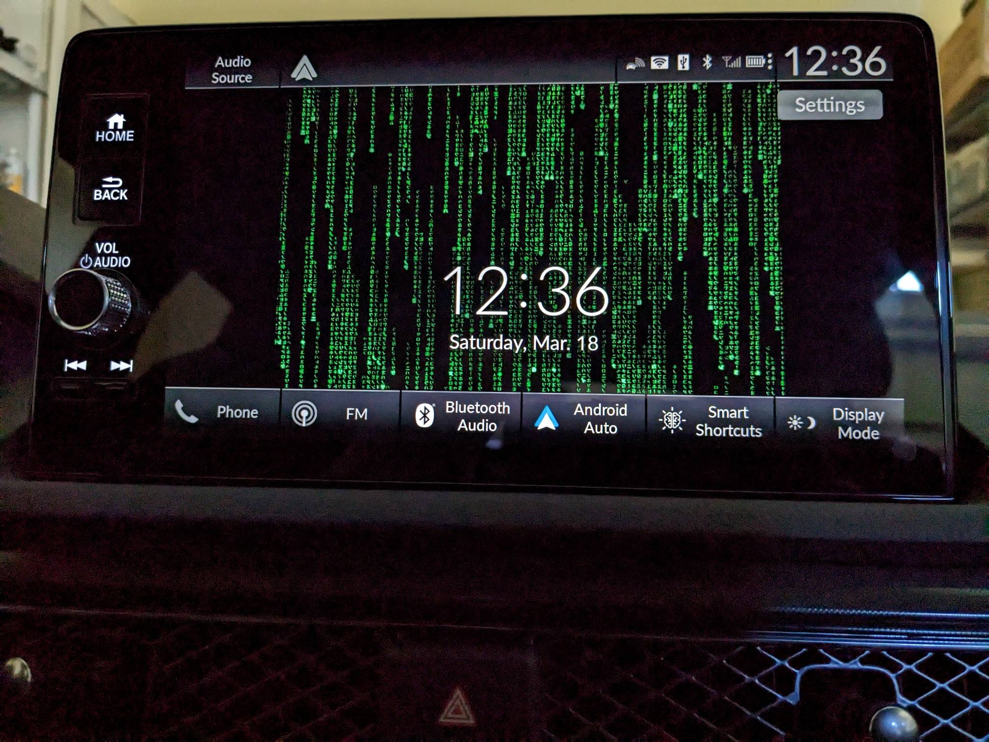

IntegraAgain
Mar 18, 2022
92
149
Triad NC
Messing around, these are the two backgrounds I added when I first got the car last Summer, lol. I may need to give a 2nd effort now that the OP has cleared up image size questions.

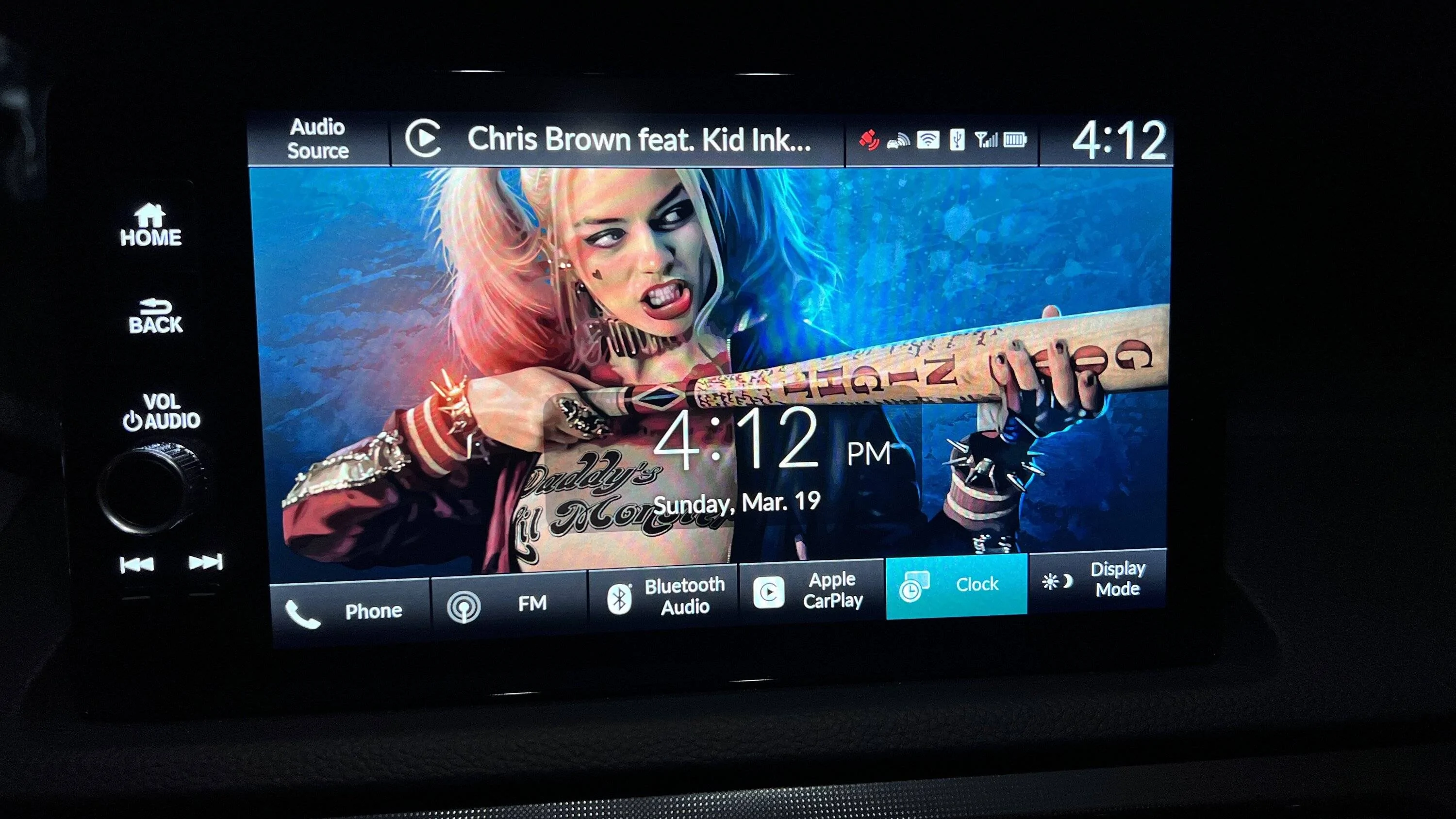

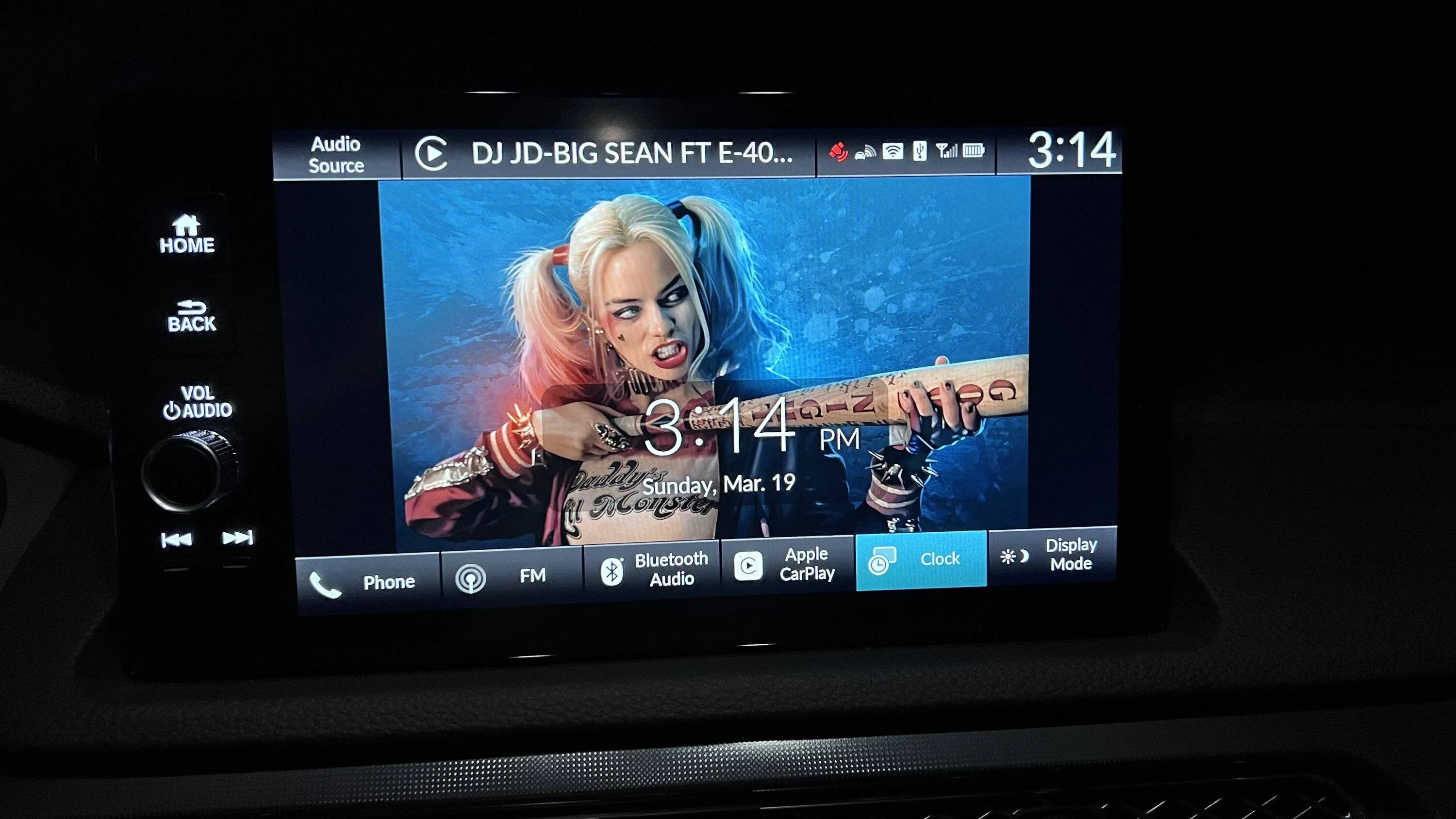

LCM23
Sep 10, 2022
34
23 A Spec Tech 6MT
I tried two diff sizes to see if the black bars would go away but made no diff. First Harley Quinn pic is 2650 x 1440. Second is the max allowed 4096 x 2304
side note. I tried using various usb drives and the only one that worked was a old San disk stick drive I had laying around using the old FAT32
Youā€™ll need to crop the image to make the aspect ratio 83:36 because for whatever reason, Acura decided that was their golden ratio
LCM23
Sep 10, 2022
34
23 A Spec Tech 6MT
I did that. Comes out the same as the other two I've tried
