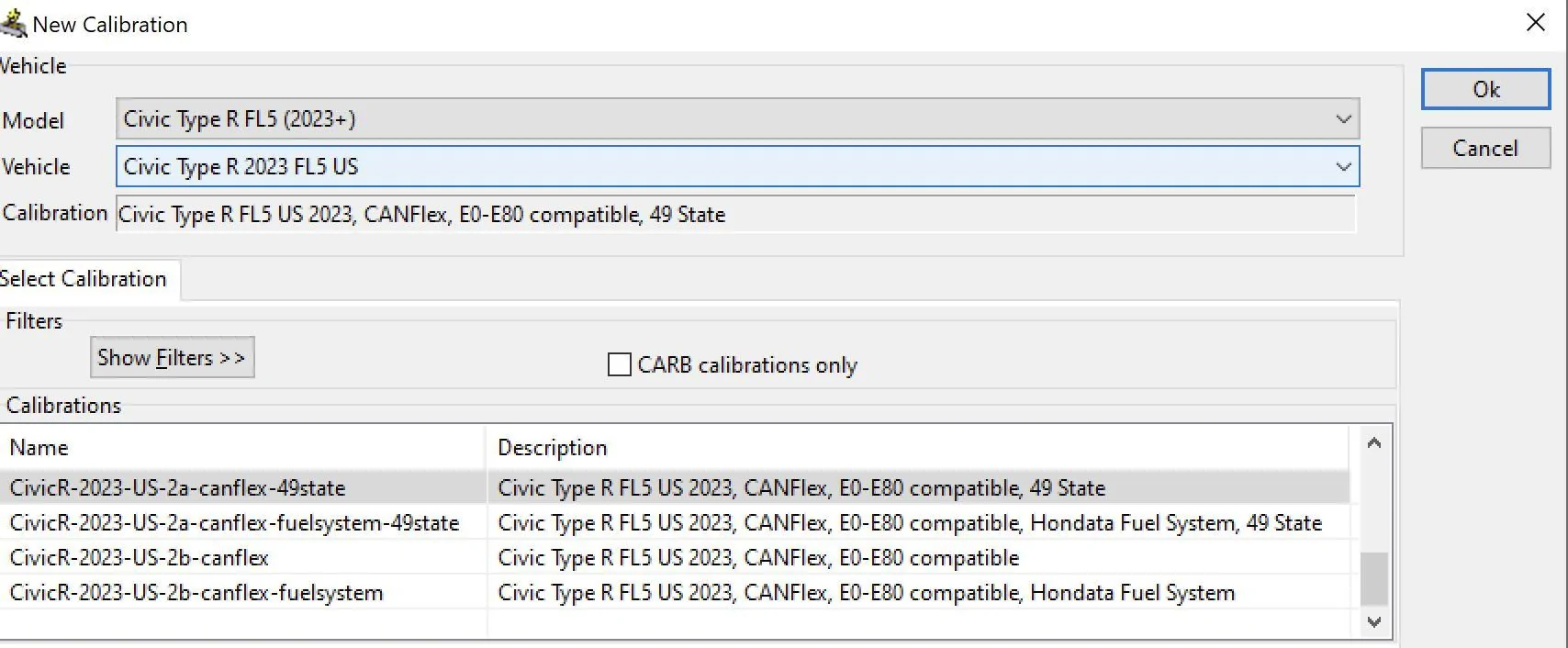

Software installation is easy. Select your vehicle, then the 49 state calibration for a stock fuel system or a Hondata Fuel System. View attachment 246807
