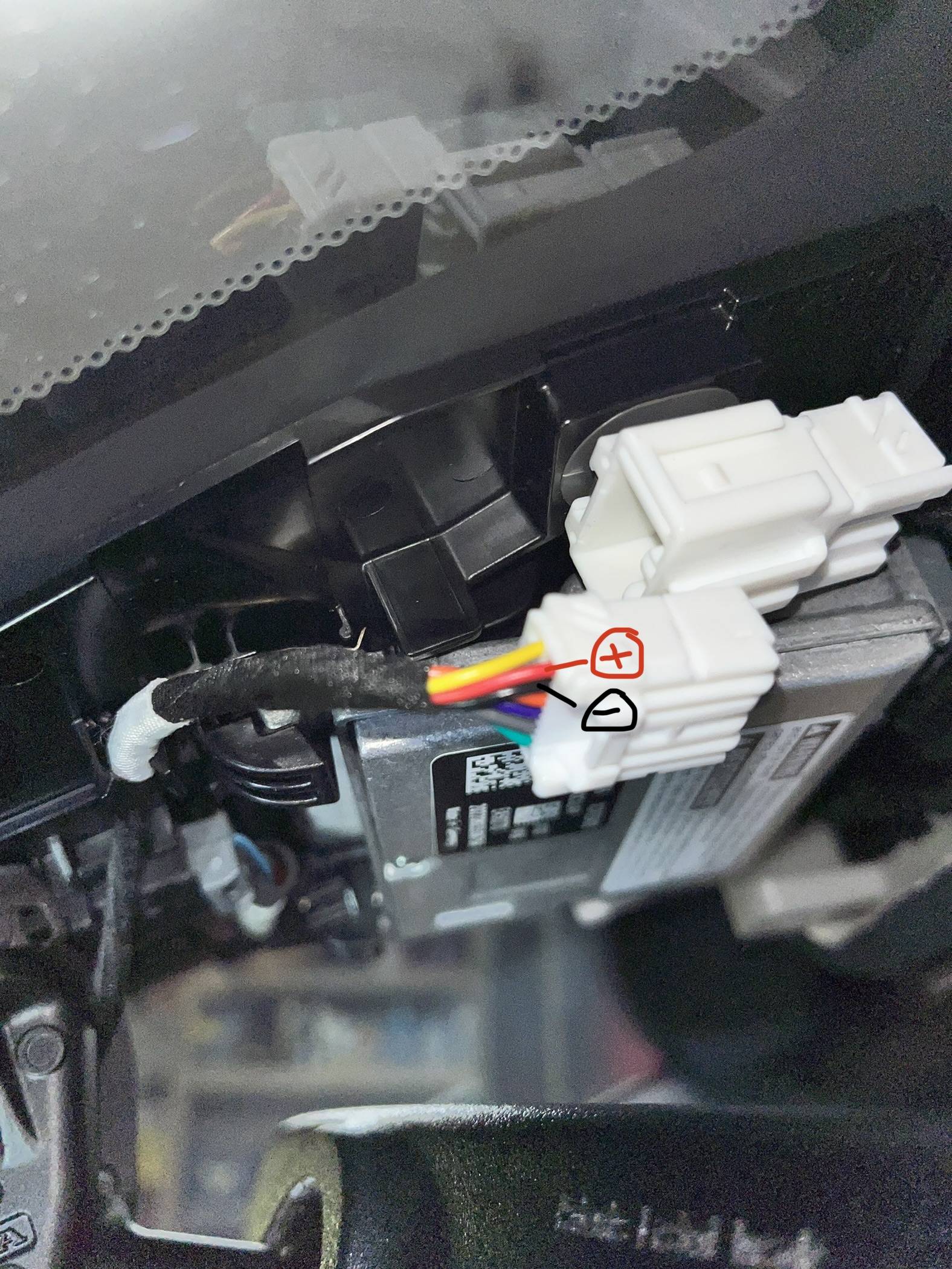

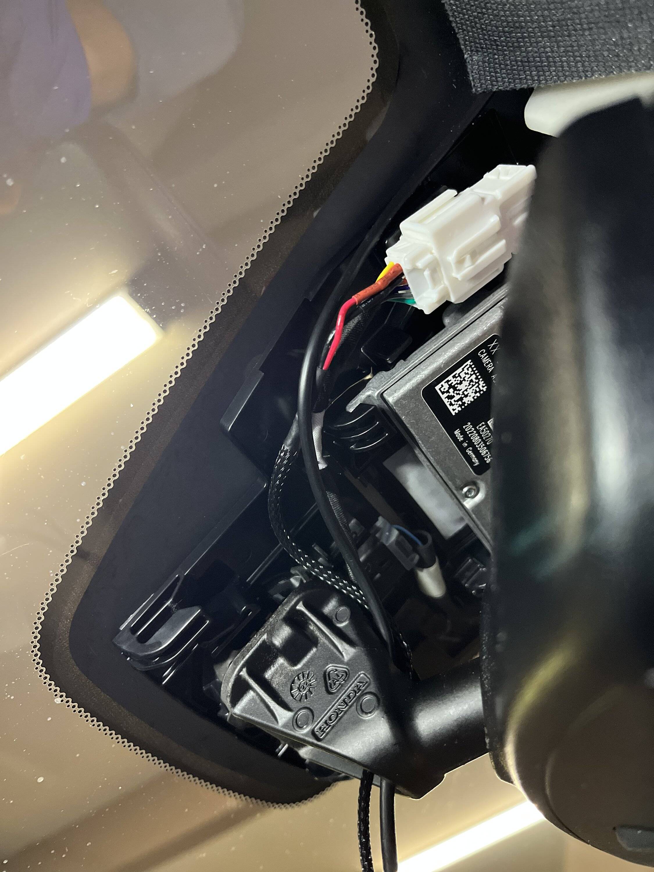

For convenience, I saved a few screenshots from the fitcam/Blendmount thread as well as a few other places, but @Fawkes provided some excellent pics of the wiring up close to make this easier & StickerFab confirmed it’s pretty much red to red & black to black when using the mirror tap. I’m not sure if the plug he tapped into is the fitcam adapter or the rear of the oem harness plug, but again I’m thinking I can hookup mine up very similar to this. Right? ?

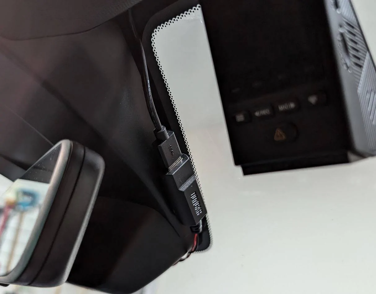

Sorry for the crappy quality photo but the Dongar adapter knock on wood works pretty well to power my dashcam. I installed it and decided to run the USB port to the outside so that I can easily swap in the future. You can do this by flexing the ventilation grill that you pop off, then feeding the red/back wire through the top slat before plugging that in to the main adapter.
The only downside is that in doing so something got even more susceptible to vibrations in the area. Weird part is it's not really noticeable to the ear but since the cam is right next to it, I get horrible buzz in my recordings as I accelerate through a certain RPM range. I plan on popping it open again during this year's hibernation period and maybe adding some felt pads in there, who knows the vibration might have already been there from the factory.
Long story short I'd still buy it again in a heartbeat over a hardwire kit that you need to route all the way to the fusebox.
