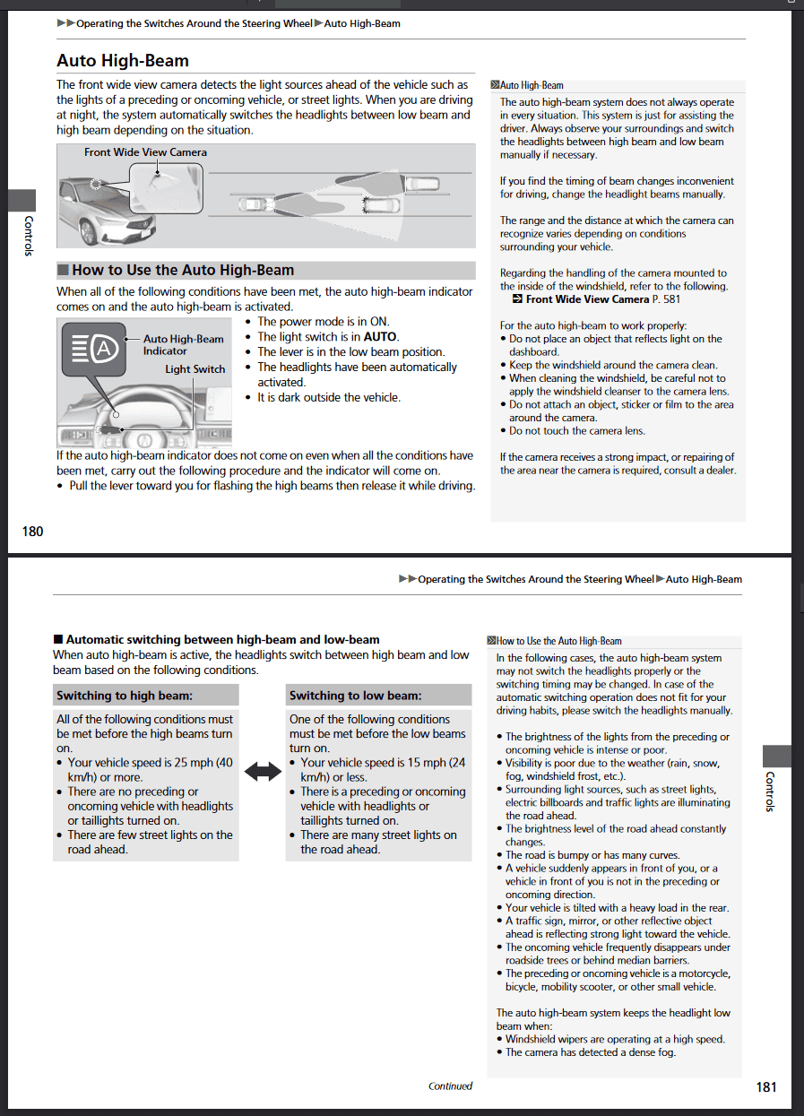

Well that sucks. Here is what I found in the owners manual.
