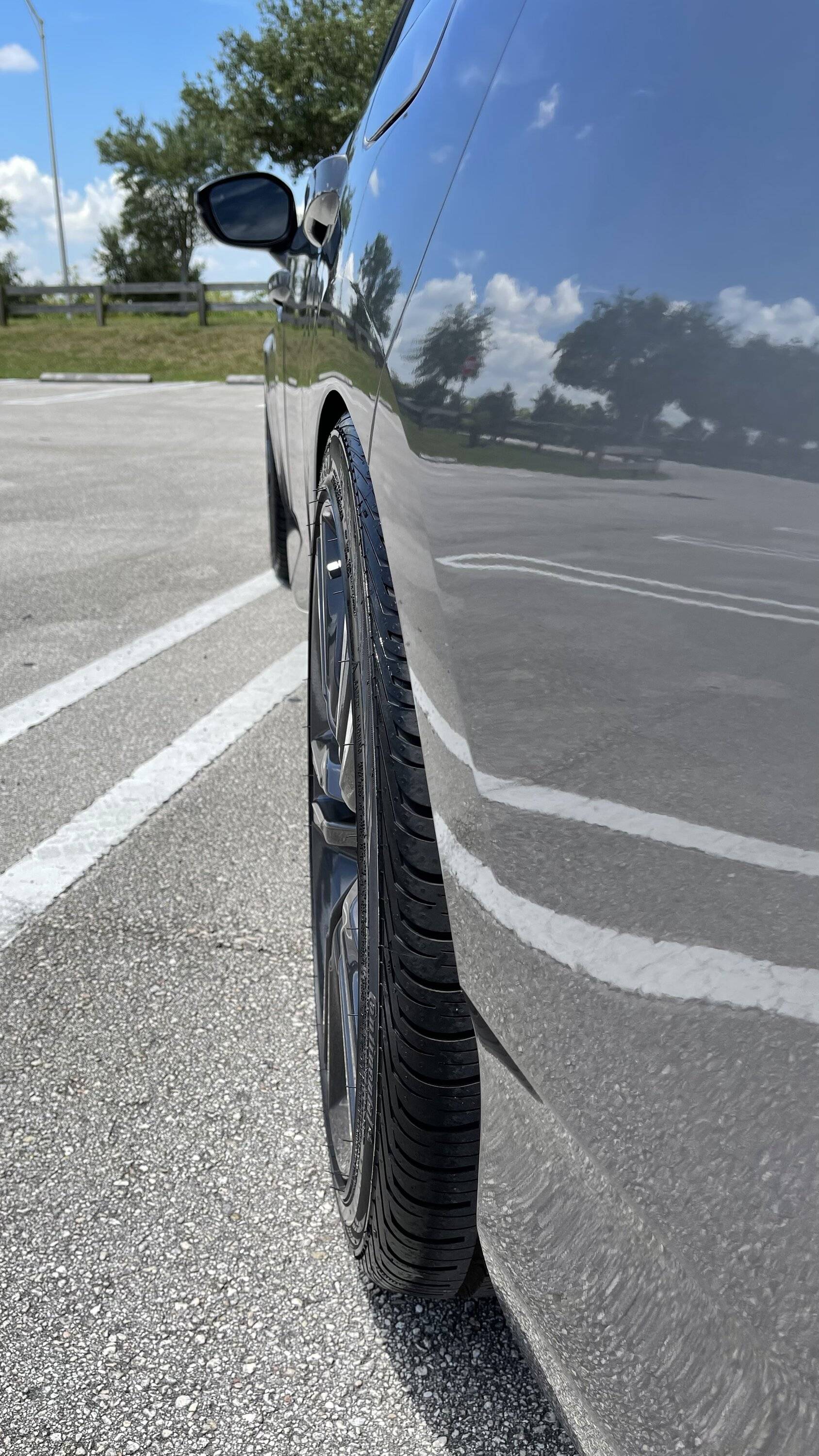

I’m posting this info based on my experience. My goal was to get rid of most of the gap, reduce negative rear camber caused by the drop, and install spacers to give it that nice flush look. This setup is intended to hold me over until new 3pc wheels are delivered.
I have already order a set of 19x9 +33 Work VS-XX wheels with step lip. They should be delivered sometime in Spring 2023.
A couple other members have done the springs, but I haven’t come across anyone with rear camber arms or spacers. Here is what I did and I’m very satisfied with the outcome. Eventually I will probably like to go a bit lower when my wheels arrive.

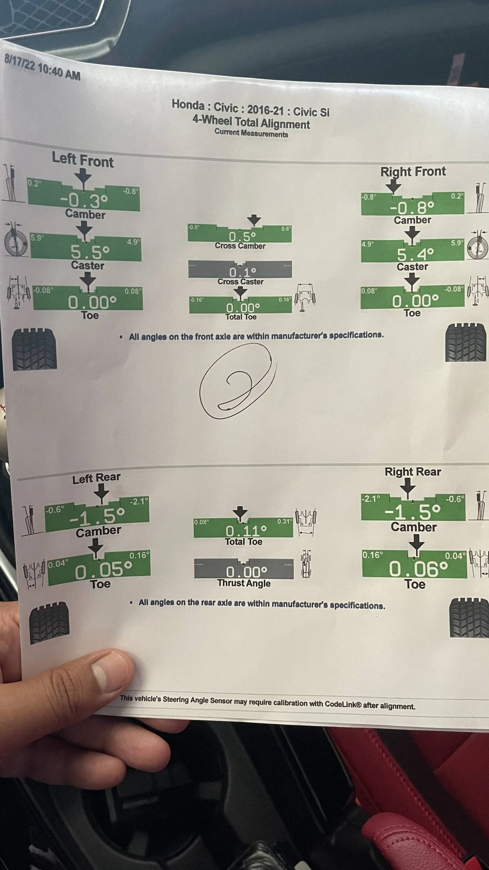

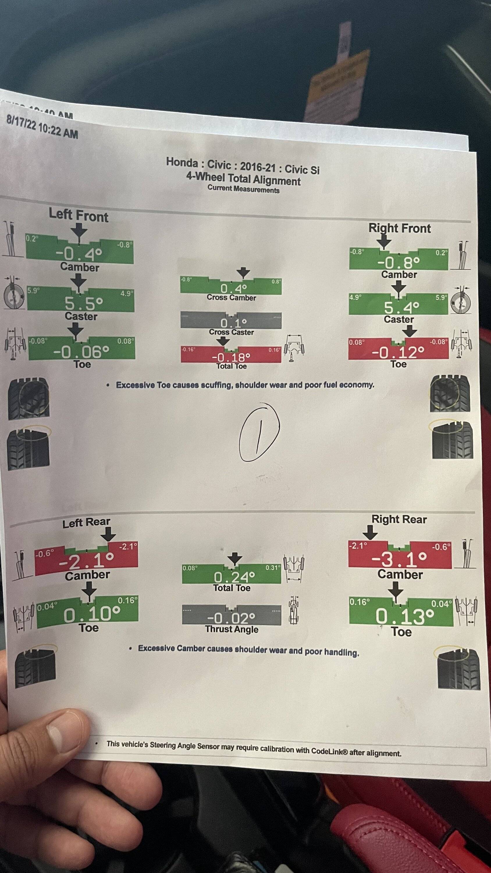

ALIGNMENT:
I took it to a reputable high performance alignment shop in my area, and they were able to get everything exactly to factory specs. If no camber arms are installed, expect to be running around -3 degrees of camber. As long as your rear toe is 1/32 in (or 0.05 degrees in) you’ll still be ok, but of course being at -1.5 camber is better for several reasons. The front camber didn’t really change too much after the drop, and the shop was able to zero out the front toe with no trouble.
I am very pleased with the setup, and I have ZERO rubbing even on dips and bumps. I’m effectively running a 18x8 square setup with +30 offset in the front and +25 offset in the rear. The ride is a tad firmer than stock, but still pretty comfortable.

Here is the Before and After at the alignment shop. Bear in mind I made the SPC camber arms slightly longer than the OEM arms to introduce less negative camber at the time of installation.

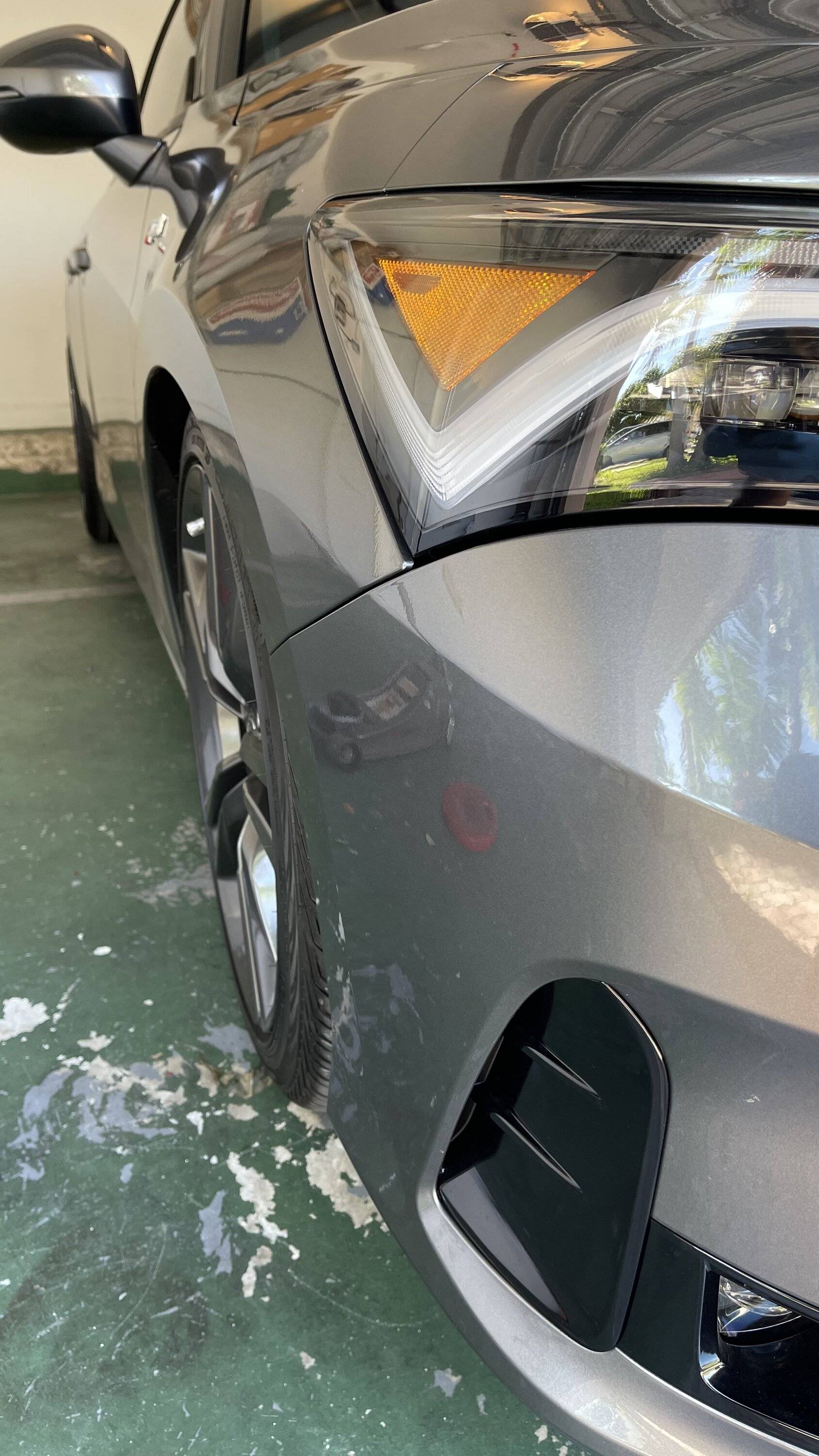

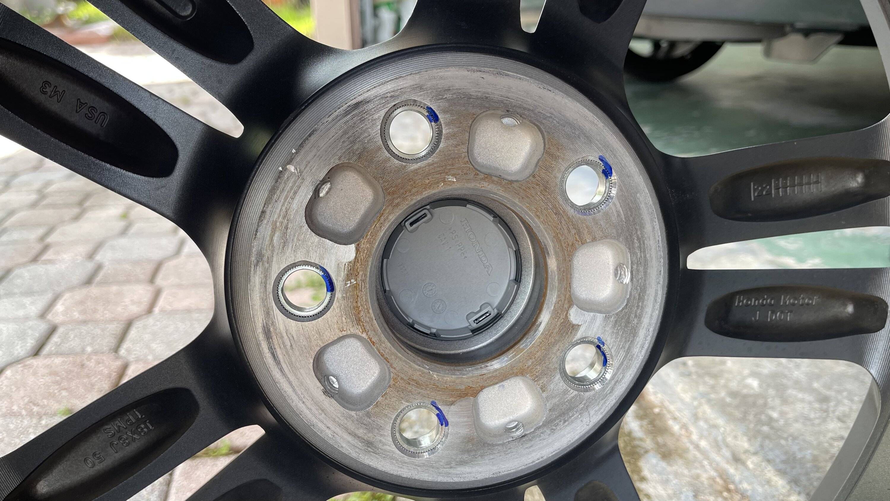

This pic is with no front spacer installed. That stock +50 offset isn’t doing this car any favors!
You can also see where the wheel studs came into contact with the wheels using the 15mm spacers since they were too thin.
